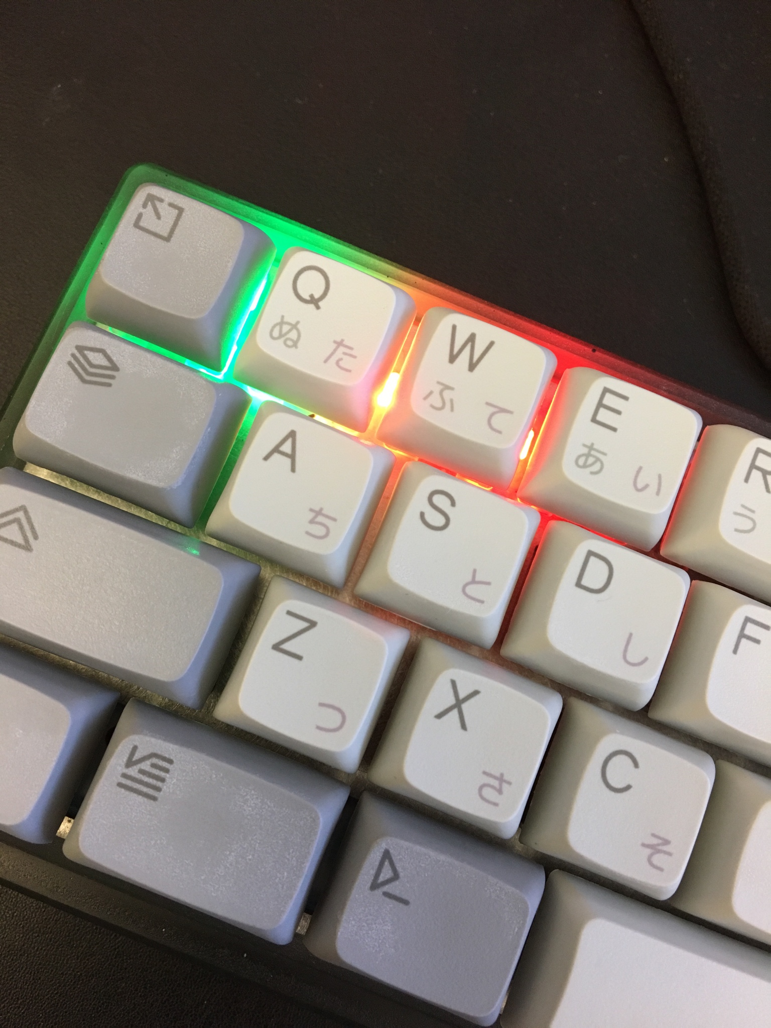

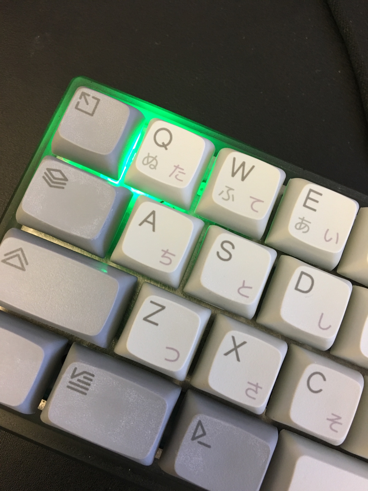

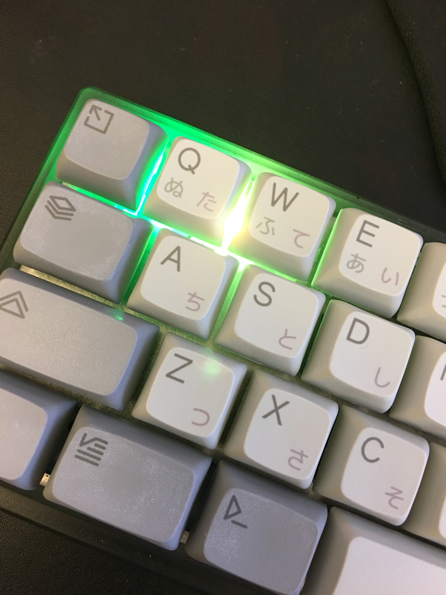

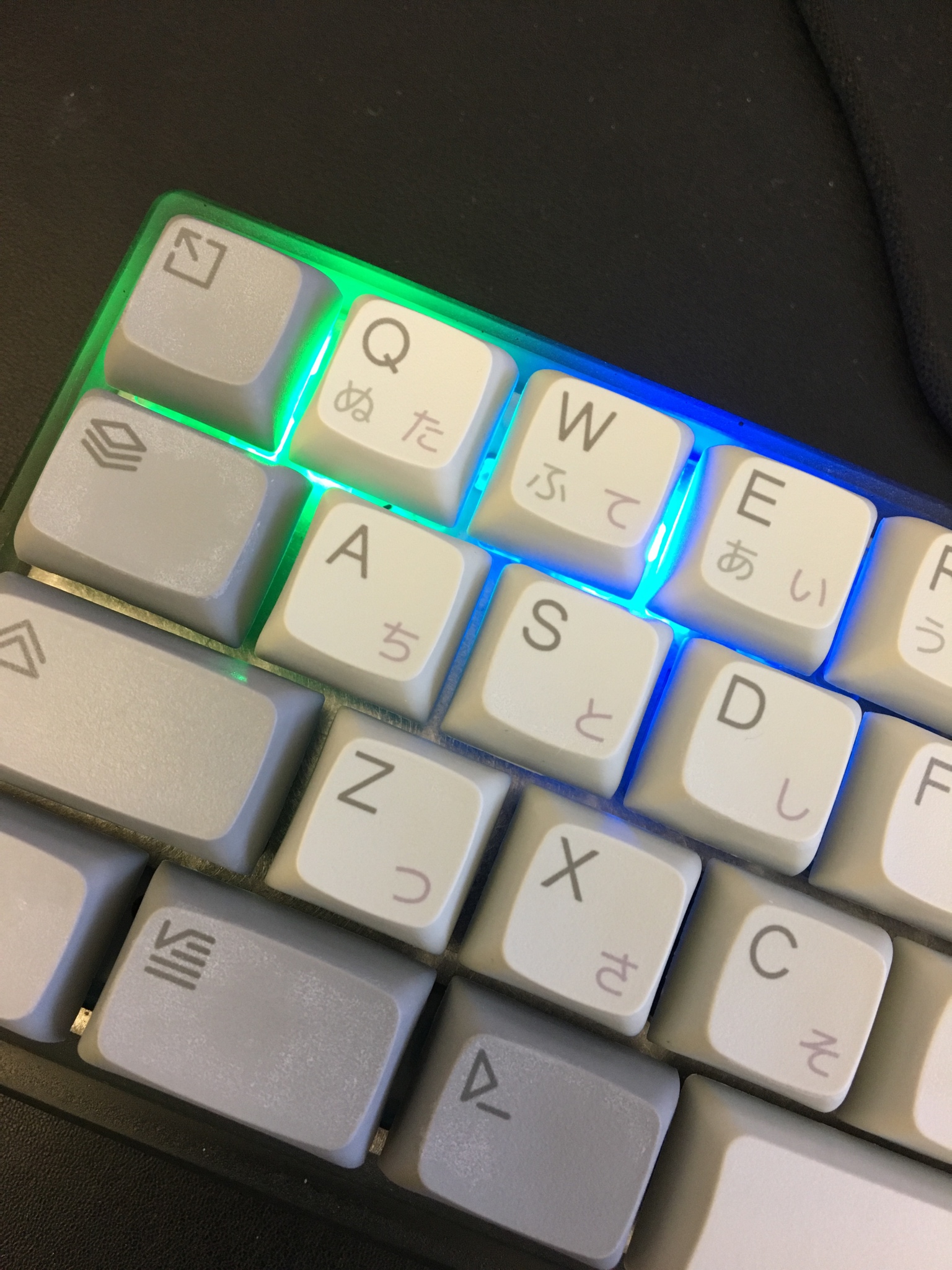

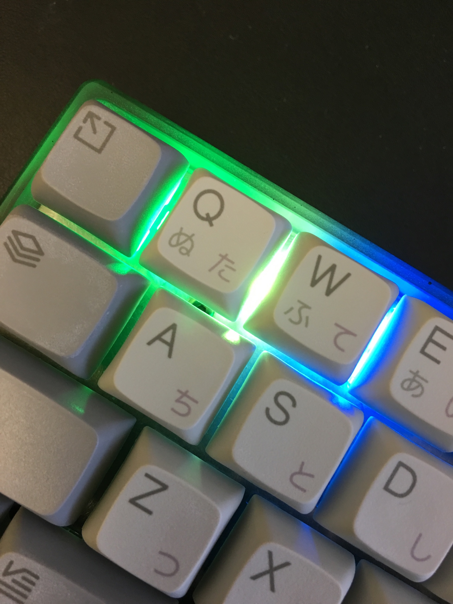

Indicator definition in configurator
Power active
Layer One
Layer Two
Layer Three
Layer One + Layer Two
