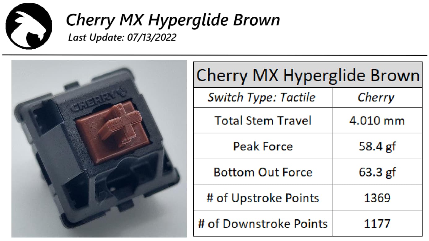

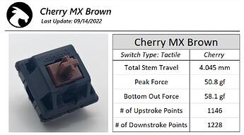

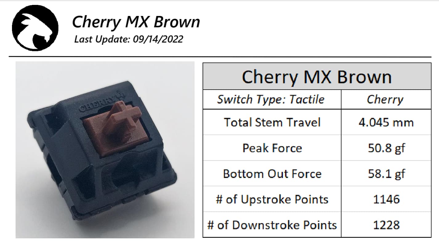

Anyone with Hyperglide Browns and pre-Hyperglide Brown and notices a difference?
I’m considering getting light tactiles and thinking about getting the Hyperglide (for that Cherry sound and being smoother), but it seems like they’re heavier?
Taken from ThereminGoat’s Github page
That’s one sample point, knowing how bad are cherry springs I would put the difference on the variance.

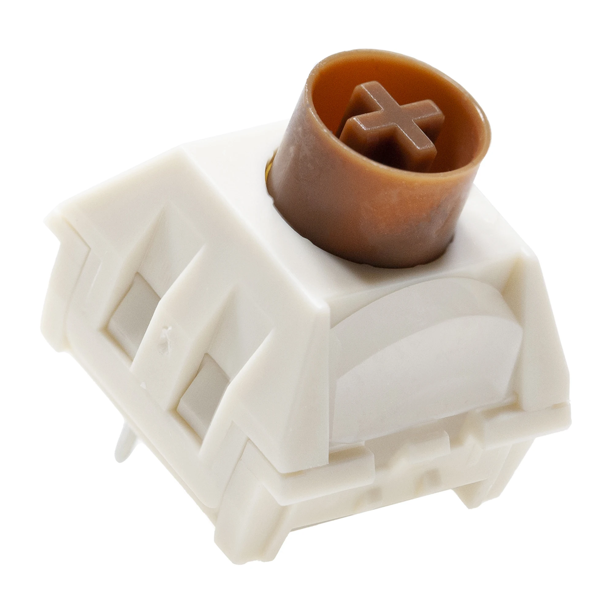

Anyone give these a shot? KTT Monochrome - Marble
They say that they are a “moderate tactile” but it seems more like a light tactile but with a HP style bump.
