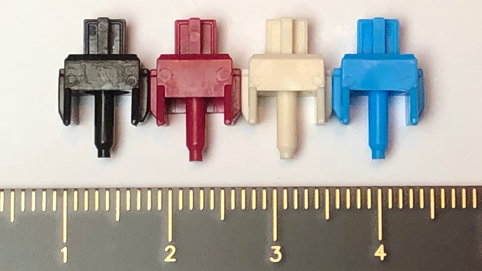

I’ll start with a comparison of four Kailh stems;
  • Black
  • Pro Burgundy
  • OG Cream (old tooling)
  • Launch Cream (new tooling)
Not long ago it came up in discussion whether or not Kailh Black stems are meaningfully different than Creams - that inspired me to pick up some digital calipers, and some Kailh Blacks.
I took measurements of each stem, and here’s how they read:

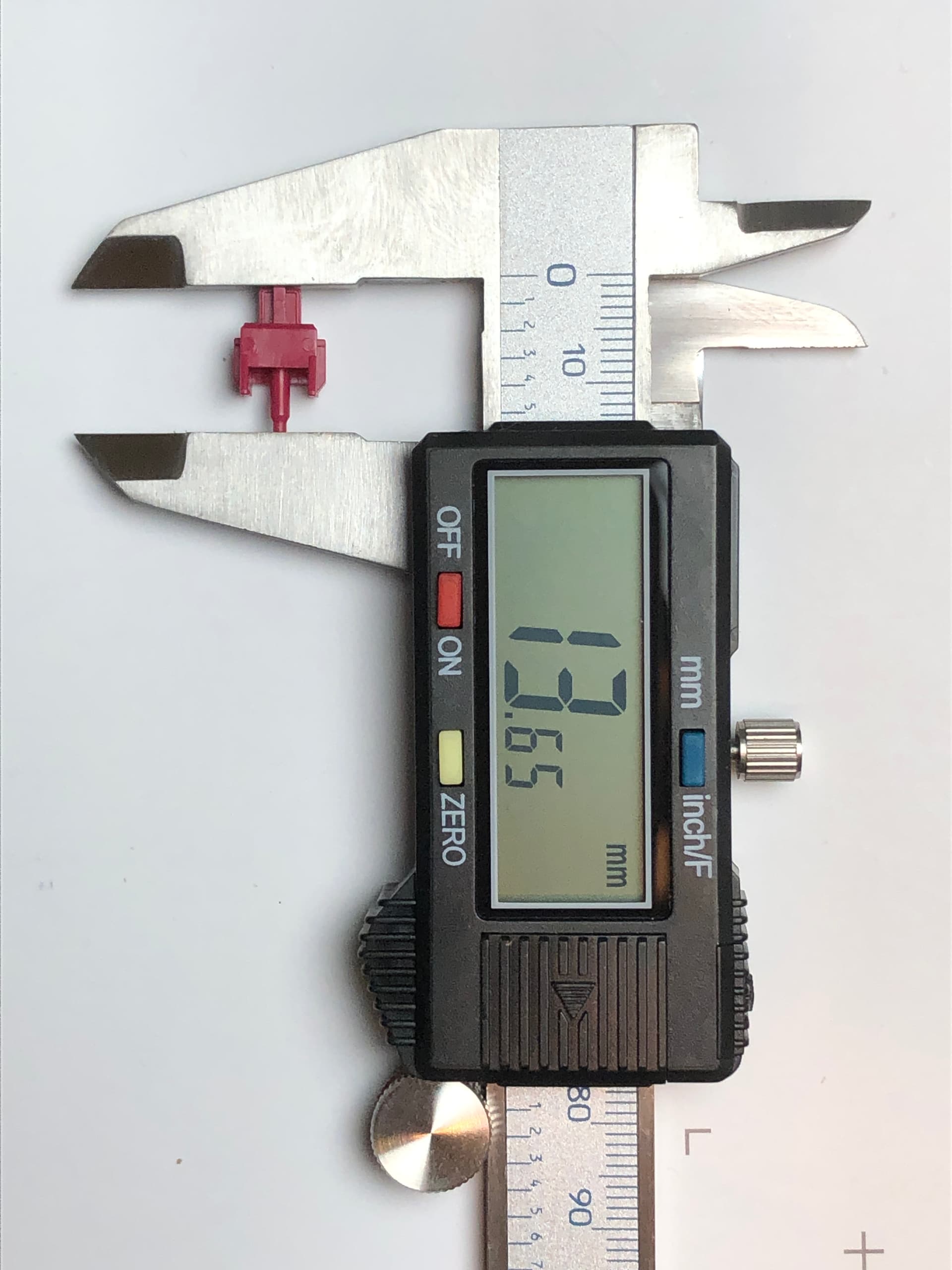

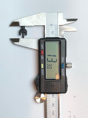

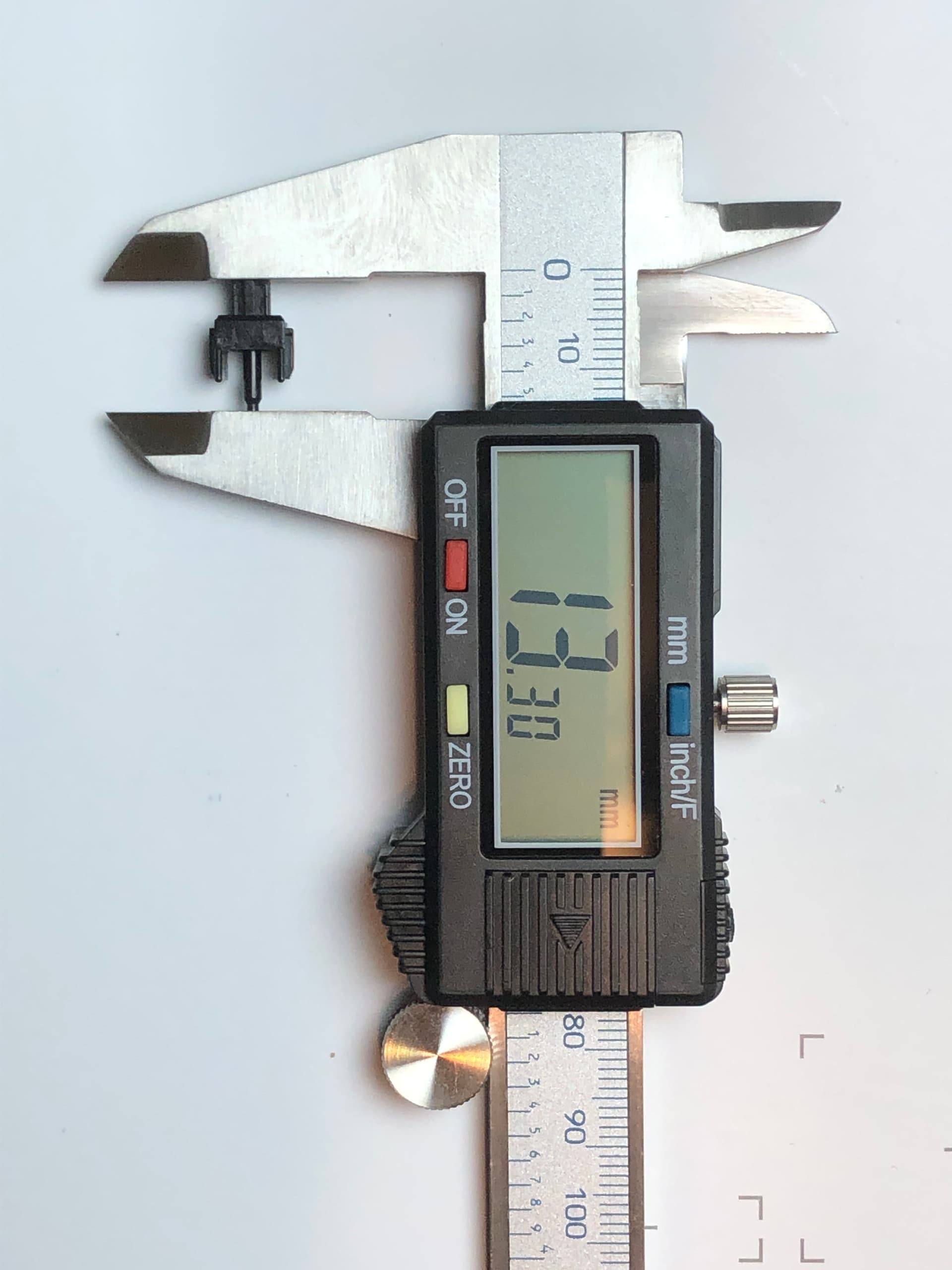

  • Kailh Black: 13.3mm
  • Kailh Pro Burgundy: 13.65mm

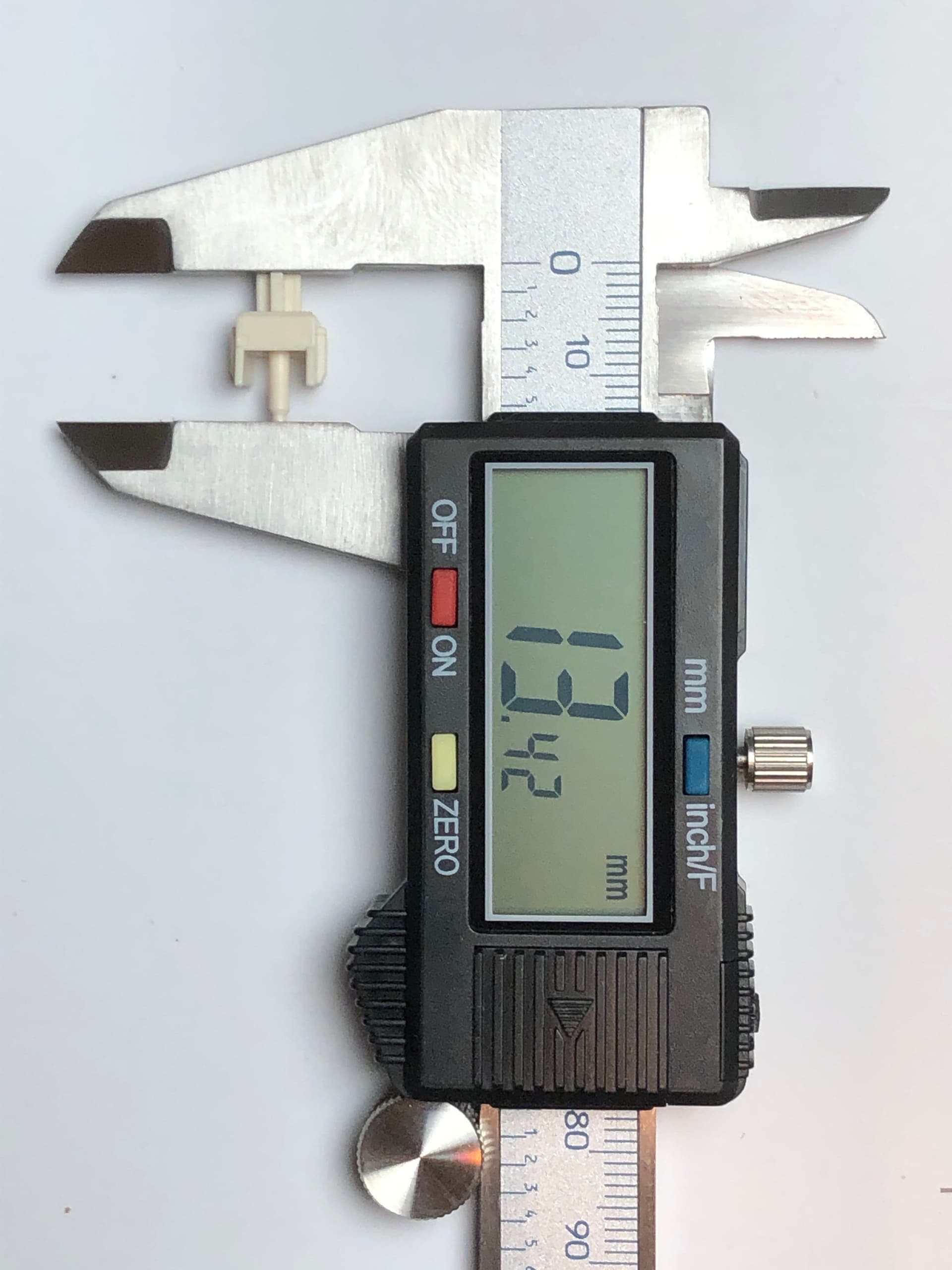

  • Kailh NK_ Cream original: 13.42mm

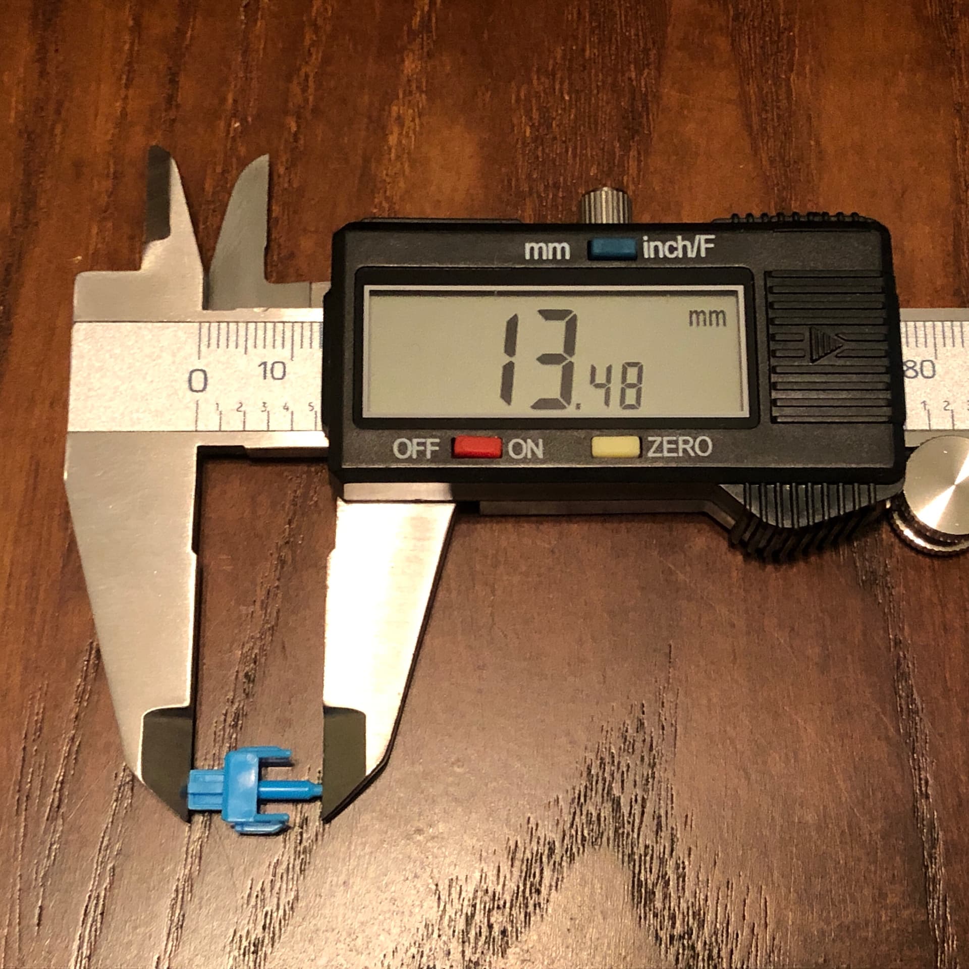

  • Kailh NK_ Launch Cream: 13.48mm
So, I think I had it backwards - I thought the Black stems were longer than Creams, but it’s the other way around. Still - the point stands that the difference is tiny: 0.12mm, according to the calipers.
The Pro is longer still; 0.35mm taller than the Black. Small, but you may very well feel it.
If I understand correctly, the only one of these that bottoms-out on the pole in its own housing is the Pro, but I might be wrong about that.
Edit: I’d previously written that old and updated Cream stems are the same length; I think this was a fluke; after measuring quite a few samples I discovered that Launch (and Arc) Cream stems are 13.48mm long, approx. 0.07mm longer than the classic ones.
Anywho - what kind of long-pole shenanigans do you folks want to talk about?

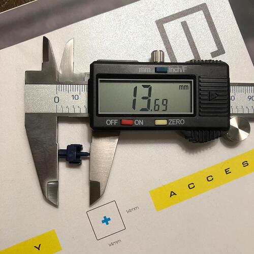

Would be neat to see how the Speed Navy stem measures up to the linears that you’ve mentioned. I have my suspicions that the Speed Navy stem is a long-pole as well (based off of the bottom out noise and feel, and observation with the top housing off) but I don’t have enough of a basis for comparison to say for certain. Given that it is more or less a linear stem with an added nub for click-bar actuation I would expect it to have similar dimensions to the black/burgundy/cream switches.
  • Kailh Speed Navy: 13.69mm
Looks like you’re right. Nice.
