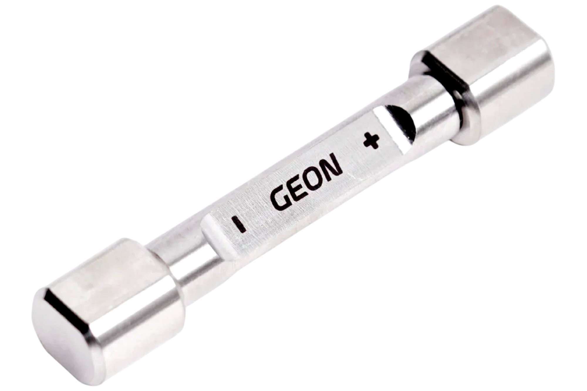

These Geon Trimmer tools are a godsend for stuff like this - I can confirm they work:
Great for MX Clears, old BOX switches, and anything else that’s just a little too thicc in the stem. (Not sure I’d recommend the other end of the tool for caps, but the switch-trimming end is great.)
Can also confirm this as being one of my favorite franken combos, I have a full set! Not quite as clean as some top-shelf modern options but they feel great and have an amazing bottom-out sound :victory_hand:
