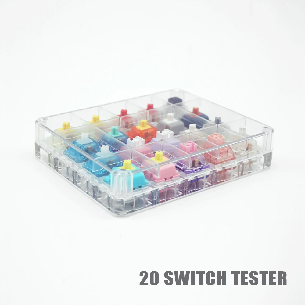

Testing boards are extremely helpful. AliExpress sales haven’t been as good as they used to be recently. But during sales, it was possible to get a tester board shipped to you for about $37-39 CAD, using coupons.
Even a 10-key hotswap board would be useful, for the sole purpose of switch-testing.
Acrylic bases might be useful if you are planning to test them. Otherwise, people often use jars to store switches. There are several photos on this forum, if you search.
