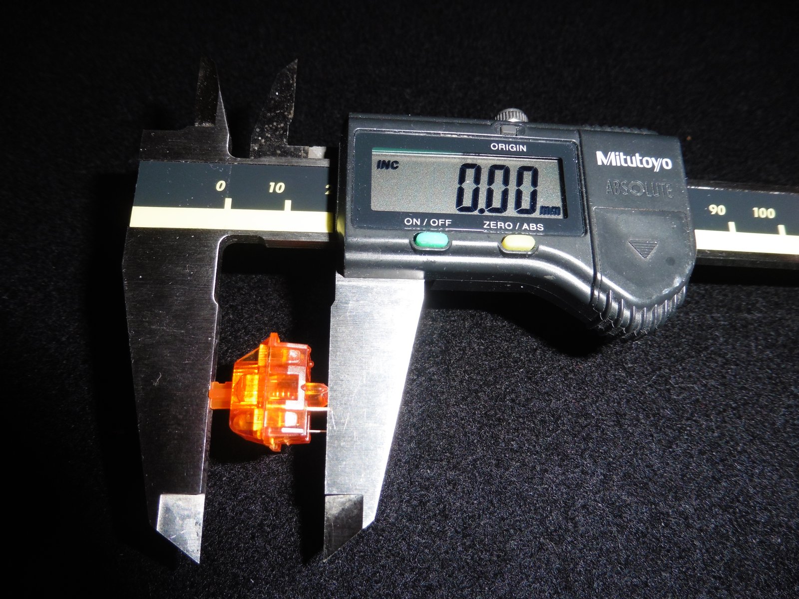

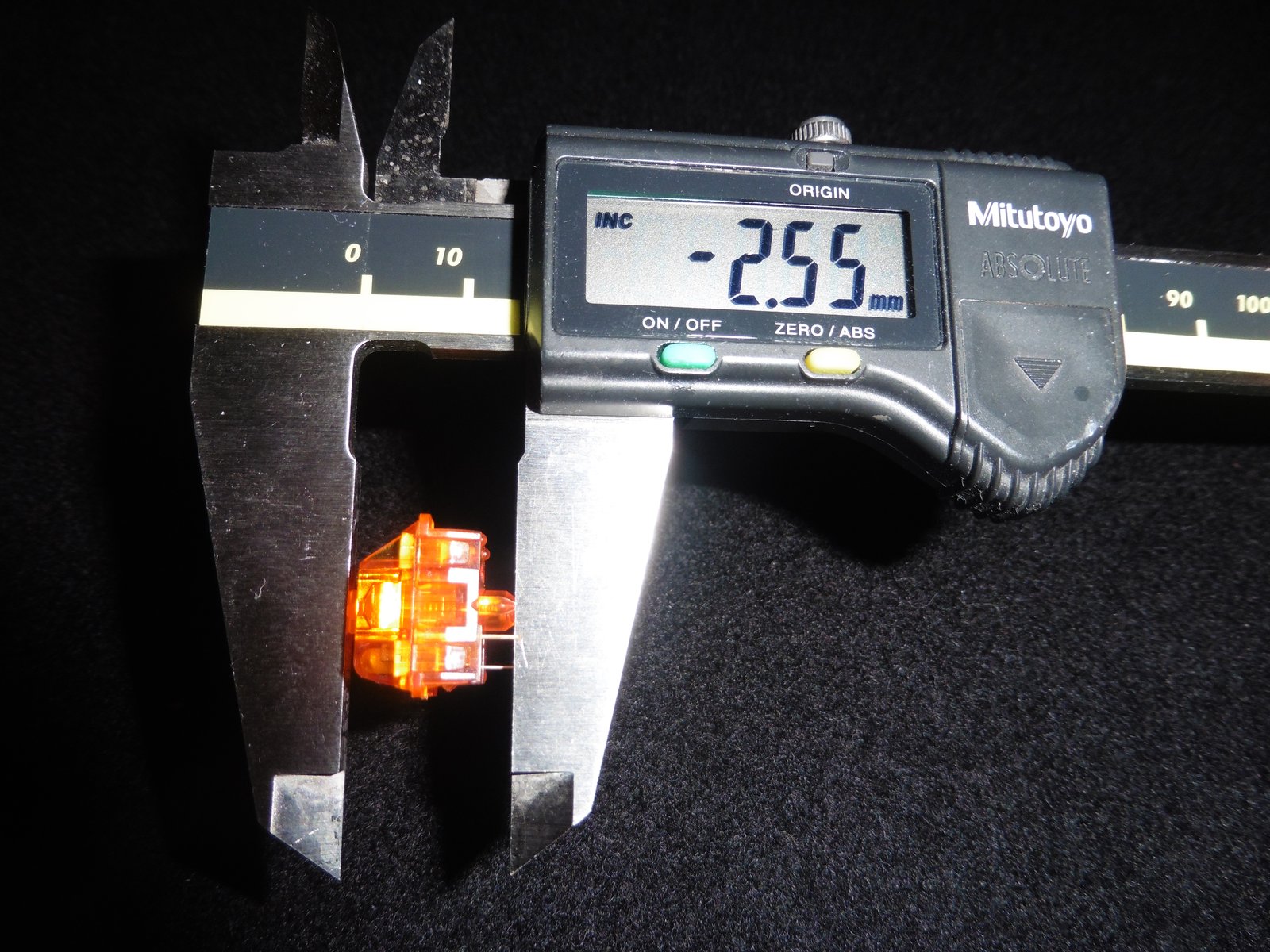

actually, I think it’s the opposite. I took a tangerine and an epsilon… put the same stem in both (an epsilon stem), and it went visibly down further in the tangerine housing. Also, the epsilon switch sounds significantly deeper in pitch.
Wow, that’s a surprise!
Thanks for the info.
Hmmmm… makes me wonder how the extra-long Coral stems would be in the Epsilon housing. Even shorter travel than in the Tangerine housing.
