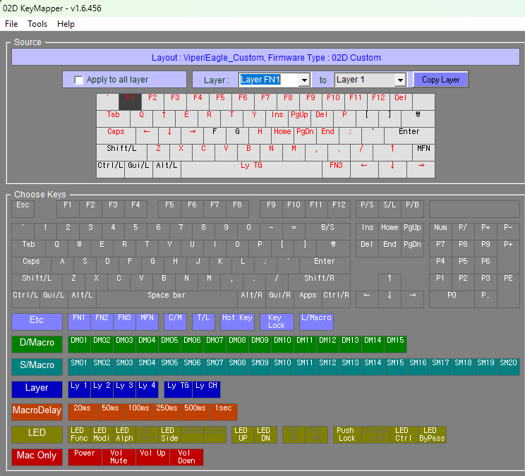

It flashes about every 1.5 seconds. No idea why. When the caps lock is on it’s steady and turns OFF every 1.5 seconds. I figure surely there’s a way to change that behavior in the firmware, but I’ve assigned every available LED function to a key and nothing seems to change it.
Anyone with experience in O2D or with a raven/sidewinder/eagle?
The LED for caps lock is an indicator for which layer you are on, so if you were to make a toggle for 2nd layer, switching to the 2nd layer will blink twice instead of once. Same applies for 3rd and 4th which blinks the amount based on layer. I believe there is no caps lock indicator no matter how hard I tried looking for it in O2D.
That makes sense. I was wondering why it sometimes flashed twice. I guess I was in layer2 for a bit.
I suppose I can just desolder it.
