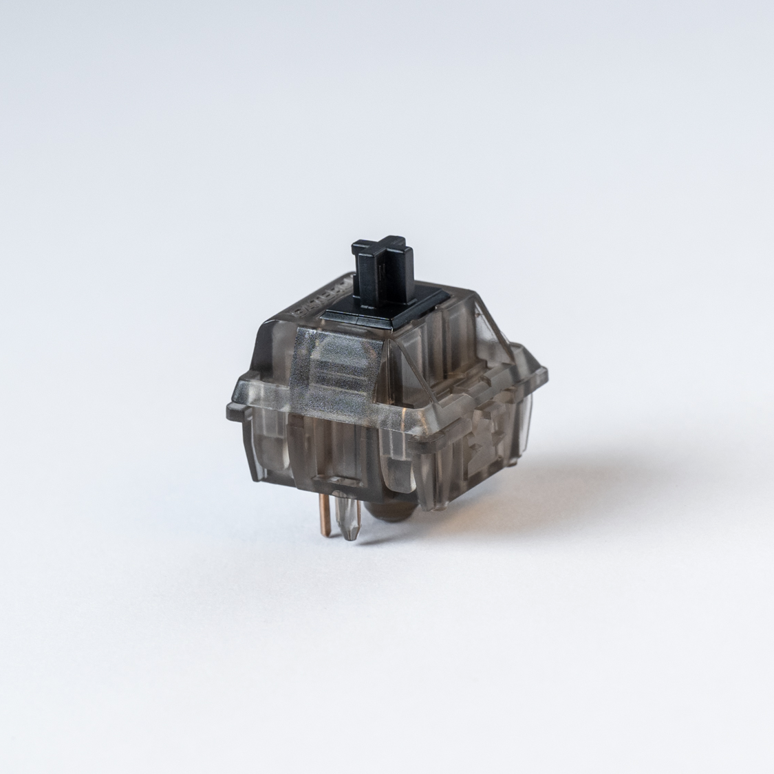

In addition, I was reminded of the new Cherry MX Northern Light silent linears:
These switches came out earlier this year, I think. They are said to be ‘medium-weight,’ and relatively-smooth for a Cherry switch.
The review above is quite detailed. The sections to pay attention to are “Push Feel,” and “Comparisons to other Notable Silent Linear Switches.” The comparison includes the Gateron Silent Black Ink, which you may also wish to look into. The Gateron silent linear seems to have a similar or identical weight to regular Black Ink linears.
