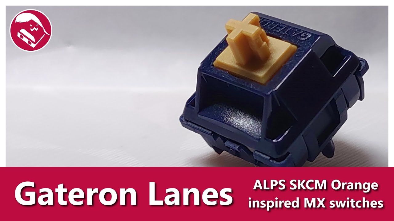

They might mean Lanes, which as far as I can tell, are a new variation on the Melodics with a more quiet click.
Yes, I think that’s it.
Gateron Lanes are a reimagined tactile switch that use a custom designed housing to utilize a click leaf mechanism without producing a loud click noise. The tactility feeling is different than most “standard” MX tactile switches as the leaf produces the feeling instead of the legs of the stem. They are often compared to something like an Alps orange switch.
When I first read that I was imagining the same mechanism as the zeal clicky switches, because it was compared to Alps, but these are quiet.
I just realized these switches are the result of a community memeber “Lanes” on GH who used a paper mod on melodic switches. That’s cool. I might need to order some.

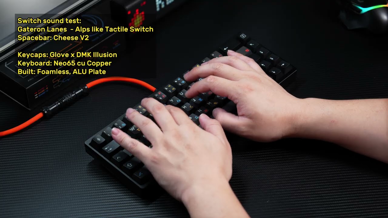

I’m definitely interested. Seems like it may hit tactile sound levels without resorting to a dampener like Mute Jades. Found a typing test here:

Found another sound test here: https://www.youtube.com/watch?v=Utd0pwatE50
I ordered 80 switches at once, just to be sure I have enough in case I like them as much as I believe I will :wink:
More on Gateron Lanes. No force graph. No photo nor video of its internals.
Sound is not quite there but it’s promising.
