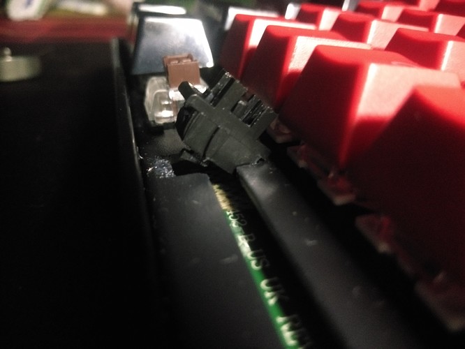

It didn’t work but I know what the problem is! The exact stabilizer housing is not locking up to the plate! I even tried to just push it back without touching the latch and it actually got removed without unlocking it! I think the stabilizer is just broken and I dunno how to fix it, I don’t have enough allowance to buy more stabilizers so unsure how to fix the “Lock” of a stab housing…

If the cloth is on the same side where the stab latches on to the plate, it could be preventing the latch from making it all the way over the edge. You might try a single layer on one of the other sides and see if the latch works after that.
If the plastic is strained and has lost its springiness to push the latch forward, you still might be able to do that manually with a small flathead screwdriver.

Okay, update, rattling is still there, I really don’t know what the hell is wrong unless it’s the stabilizer or it’s the plate… ! This is the stabilizer housing I was mentioning that doesn’t have a strong lock to the plate
All it takes is a push upwards and it just becomes like this, also the stabilizers are upside down compared to other keyboards.
