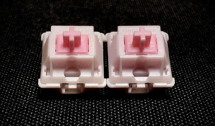

Bumping this one for the new batch I got today; I don’t have any verdicts per-se, but I can tell you the colors have changed slightly.
In-hand, it seems like the acoustics are similar, but with a bit more noise on the new ones - a sharper return clack and more spring-wiggle. This is un-mounted with no caps, though - I’ll get back to you on any sound and feel differences once I test them in a board.
Housing fitment is good on both but observably better on the new ones; it takes a fair bit of force to wiggle the old ones, the new ones just don’t wiggle.
Could be my imagination but the new ones feel lighter.

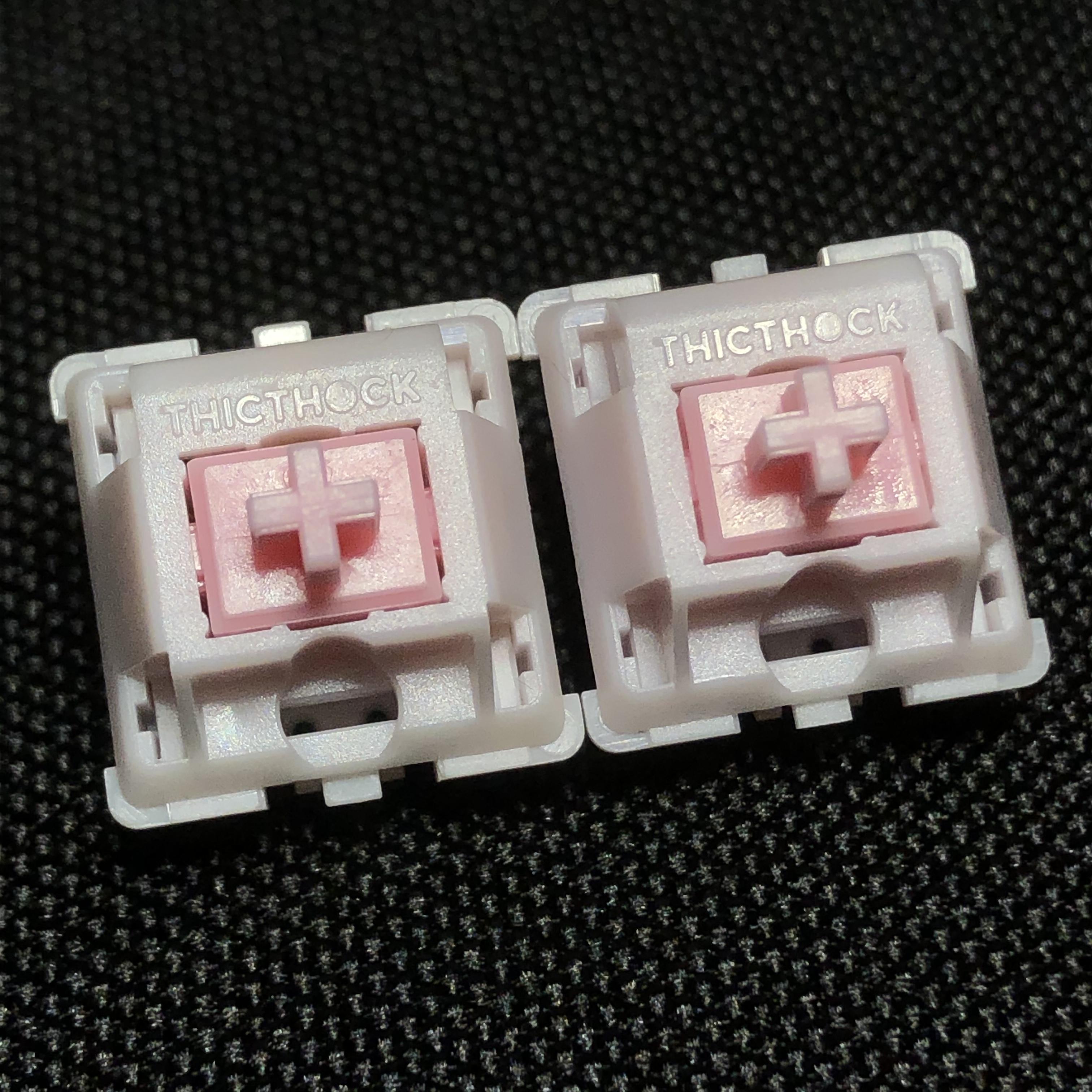

Visually, the new ones have:
  • Slightly lighter, warmer, less-saturated housing color
  • New housing has a slightly brighter specular reflection; shine is a hair stronger
  • Slightly more saturated stem color
  • A deeper recess on the outside bottom of the center tube

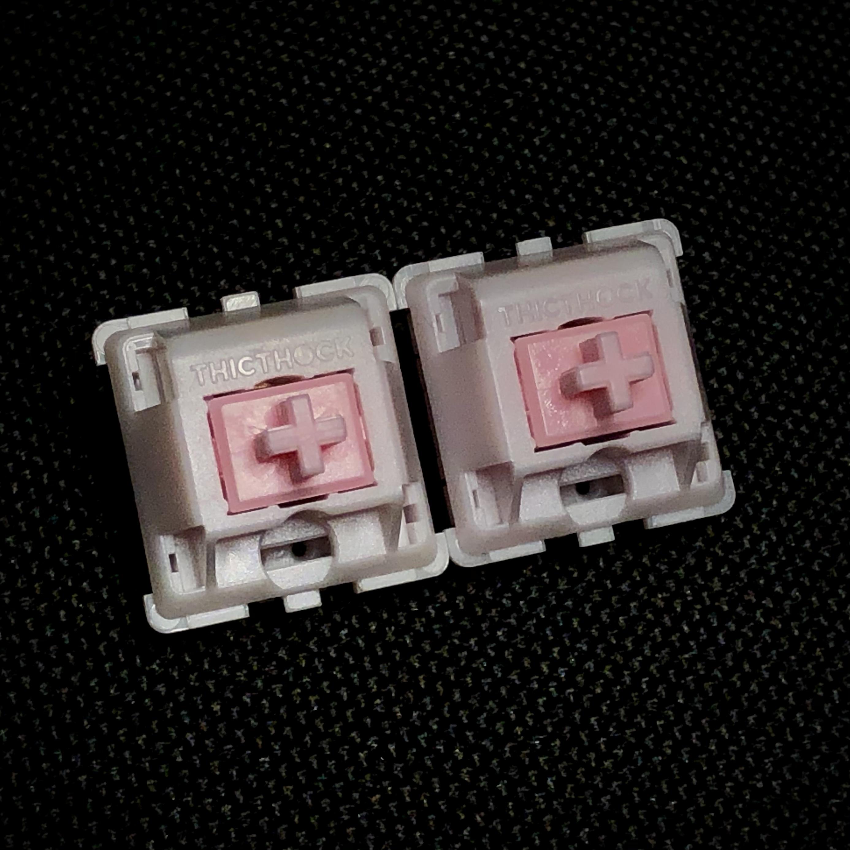

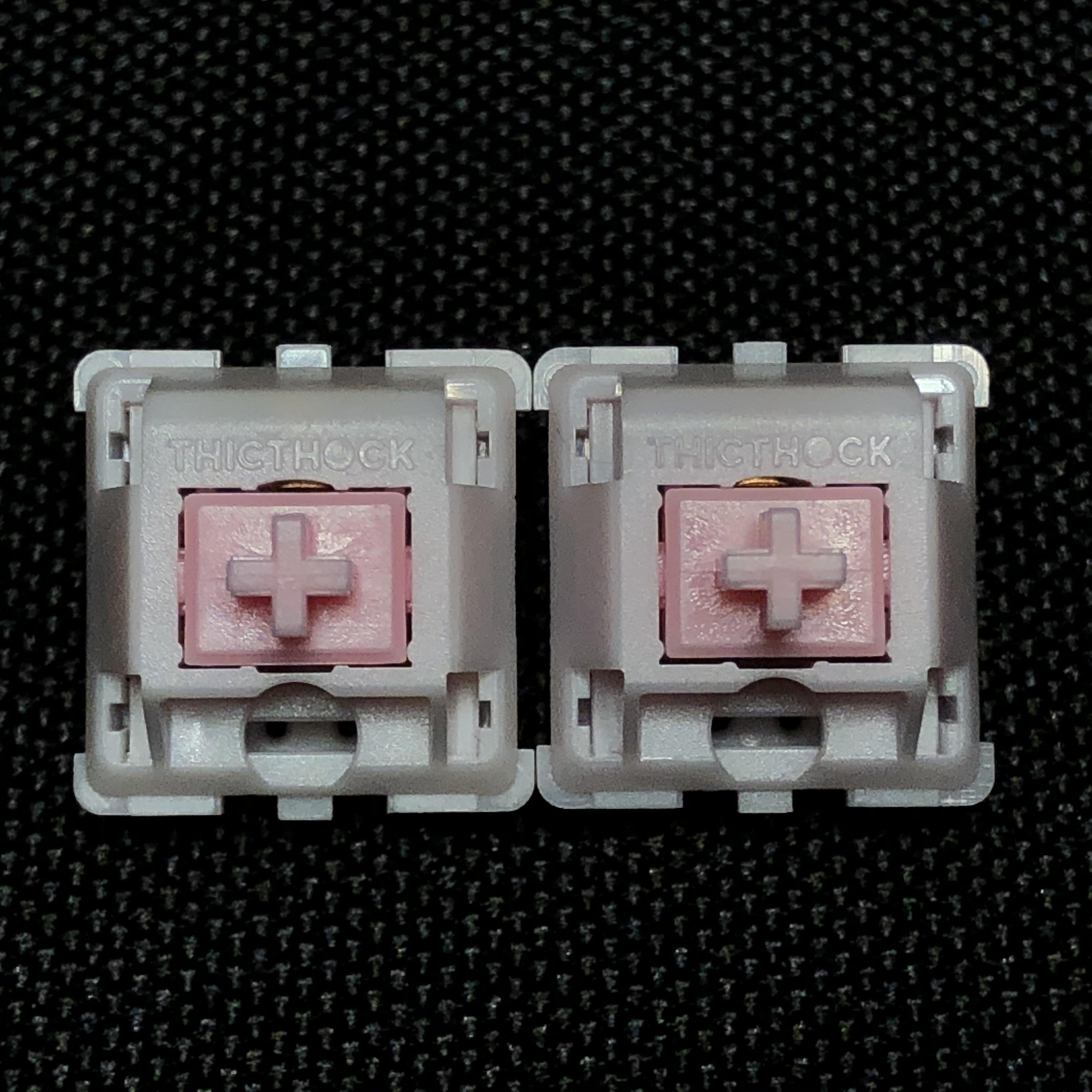

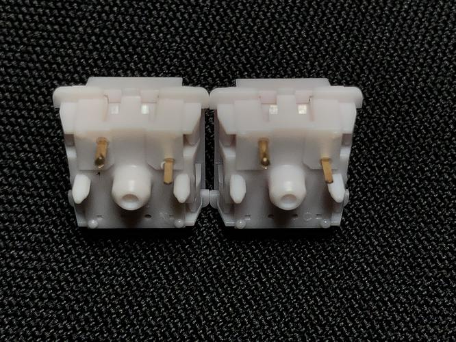

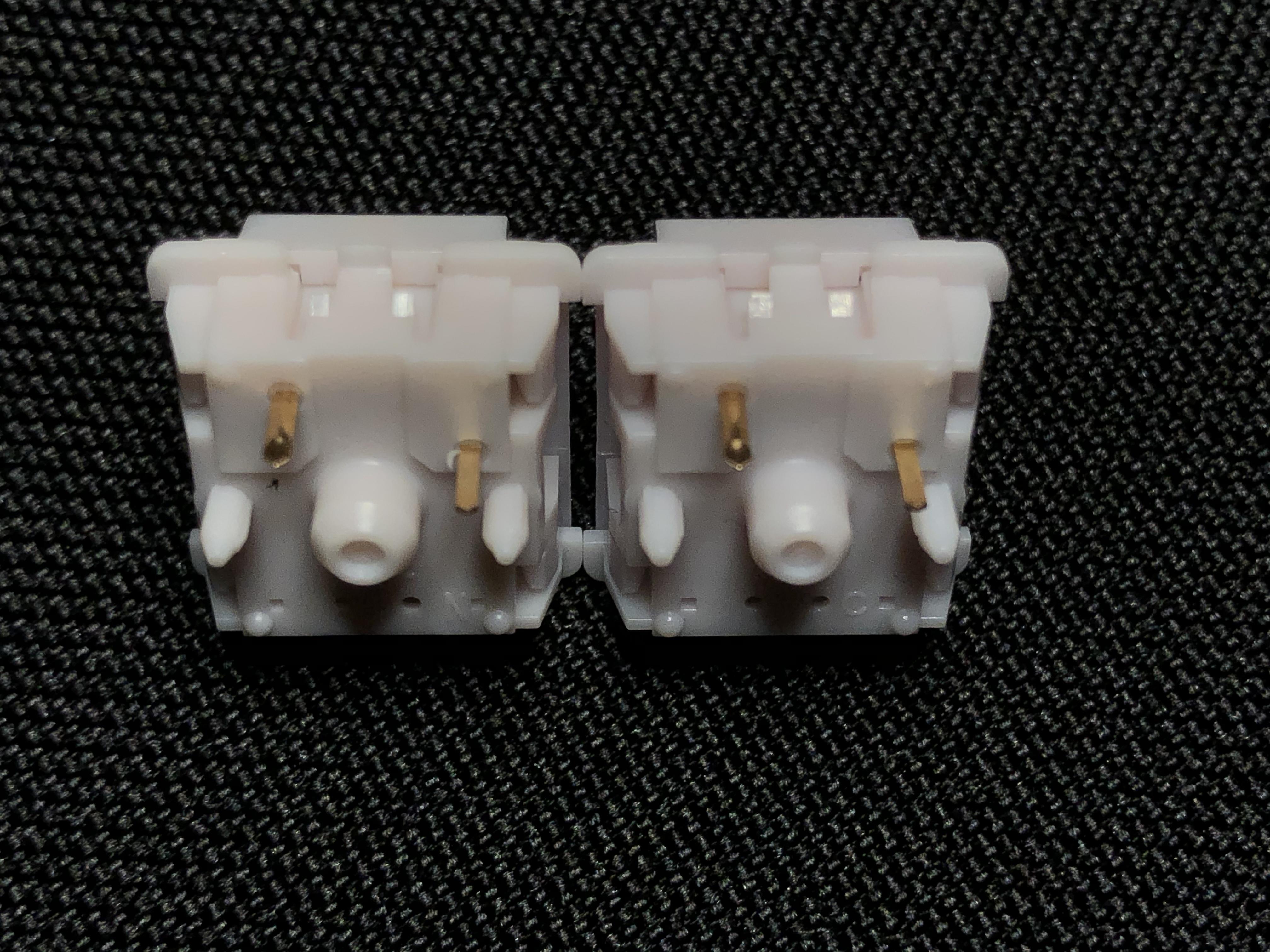

Some photos, starting with the bottom, and then of the front with increasing contrast and saturation to make the difference a little more easy to see. New one is on the left in all cases:
As far as I can tell the weighting is identical through the press, but I do have to say the new ones feel more “clean” and refined, like the plastic parts get-along better.
There’s a subtle inconsistency to the travel-feel of the old switches that just isn’t there with the new ones. Again this is just in the hand focusing-in on single switches; I’ll update in the next day or so on how they may or may not meaningfully differ in actual use.

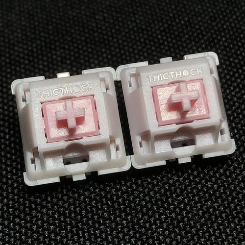

Quick edit; one more photo that makes a visual difference a little easier to see:
Straight-on; look closely at the corners. I’d wager @ThereminGoat could tell us something about those differently-sized circular marks from the molds.
