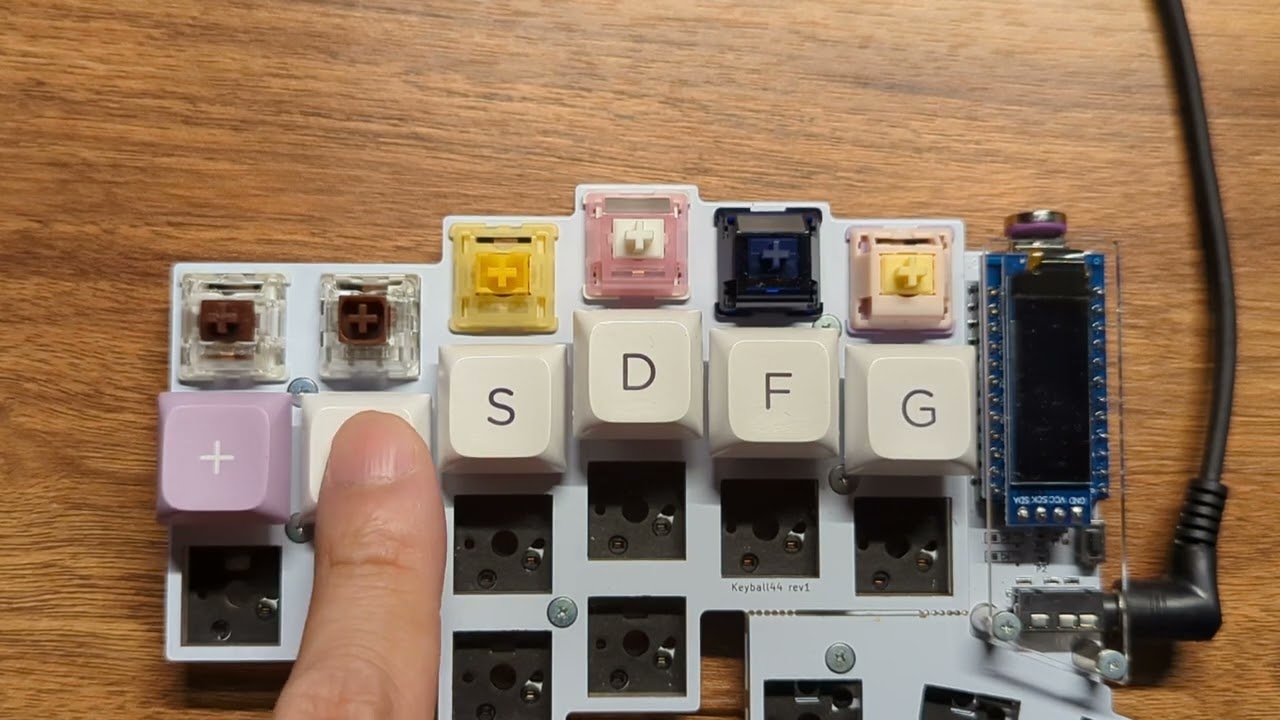

While I don’t think it will be the same as the sk’s, you might consider some switches like these Kailh Deep Sea Silent Mini Low Profile Browns (what a mouthfull):
They have laptop-like short travel, a mild “thud” bottom-out not too unlike traditional rubber domes, and if they are anything like the non-low-pro version of the same switch (one of my faves) they should have a pretty snappy tactile event.
I believe you’d need similarly low-profile stabilizers to go with shorty switches like those, and IIRC the Shinobi uses plate-mounted ones:
I’m not certain that the Shinobi’s caps would play nice with those switches, so you might consider grabbing any given Kailh or Gateron MX-mount (+) low profile sample from a site like SwitchOddities.com for testing first - but if the form factor works with the build, that type of switch is a great way to use (some) MX mount keycaps with a much shorter travel than traditional (4mm) or even otherwise “short travel” (3-ish+mm) MX compatible switches.

I second this. If I was trying to do what you propose, I would test with the tecsee medium tactile switches. I adore how low they make keycaps sit, and they feel nice to type on IMO (short travel, quiet and thuddy). If you go this option, they also sell stabilizers to use with them that are very nice when lubed. But the only keycaps I’ve found that don’t hit these switch housings are SA and DSA. All other caps I’ve tried )(DCS, GMK, MTNU, MT3, KAM, KAT, PBS) all make contact. So you would definitely need to test them with the TEX caps.
I just recently picked up a fourth set of these switches for a planned build. I’m not aware of any US vendors that have them stocked. You can order them through KPRepublic or off of their Amazon, but it will take a few weeks to get them. Otherwise there is Aliexpress where they are sometimes called tecsee “pudding” switches.

So I can’t speak for the OP, but I have both these switches and the Shinobi, so I just gave it a test. The switches work fine even for G, H, and B – there’s some collision, but the switch seems to activate just fine.
The trackpoint does stick out a bit if you leave the Tex-provided nub on it, but the base trackpoint device is about level with the keycaps, so you could trim down the nub to be less obtrusive.
The stabs also seemed to work but the travel felt a little off. But keypresses still made it to the host.

To update this in case anyone else is interested, I’ve found that PBS collide with the switch housings on Tecsee medium switches as well; however, my KCH Nekoccino keycaps from Keyreative seem to work well. Also DSA is still a great option for these switches. I think the key is that the caps need either be very thin, not have cross supports, or a combination of both.
