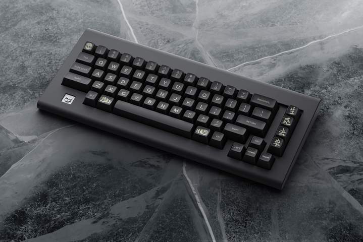

This might be the first MG set I’m leaning towards ordering - I do love beige on black.

These are pretty cool. Bone/skeleton theme. Looks like a nice black on ivory set for sure. Not sure what the cross thing is. Novelty holder?
Pretty much - it’s a decorative dodad that can hold keycaps.
My understanding is that the profile is supposed to replicate the Topre Hi-Pro sculpt so that is where the deeper scoops and pronounced edges come from.
