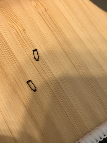

BE VERY CAREFUL in lubing the side rails. You can easily screw up the rubber dampeners! Even a light brushing can cause it to turn incorrectly.
I might even suggest that you lube the top housing instead of chancing messing up the dampeners on the side rails.
Turn incorrectly?
I kind of got 205g0 all over my Helios.
Yeah, it sounds strange, but the rubber parts are just like a rectangle that slips over the side rails. If you brush up against it, it will spin out of place!
Hmm, guess Helios are made in a different way then.
It’s molded in those.
