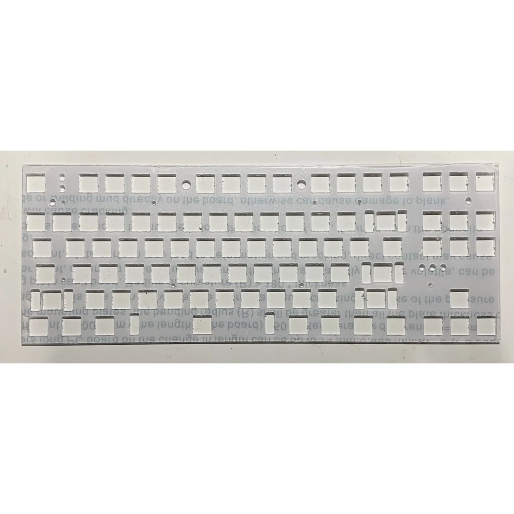

This may be a polycarb plate for the MK870:
It looks as if there are both polycarb and brass options.
If true, this is interesting, because previously, you had to go to TaoBao and pay about $45 CAD to have it.
