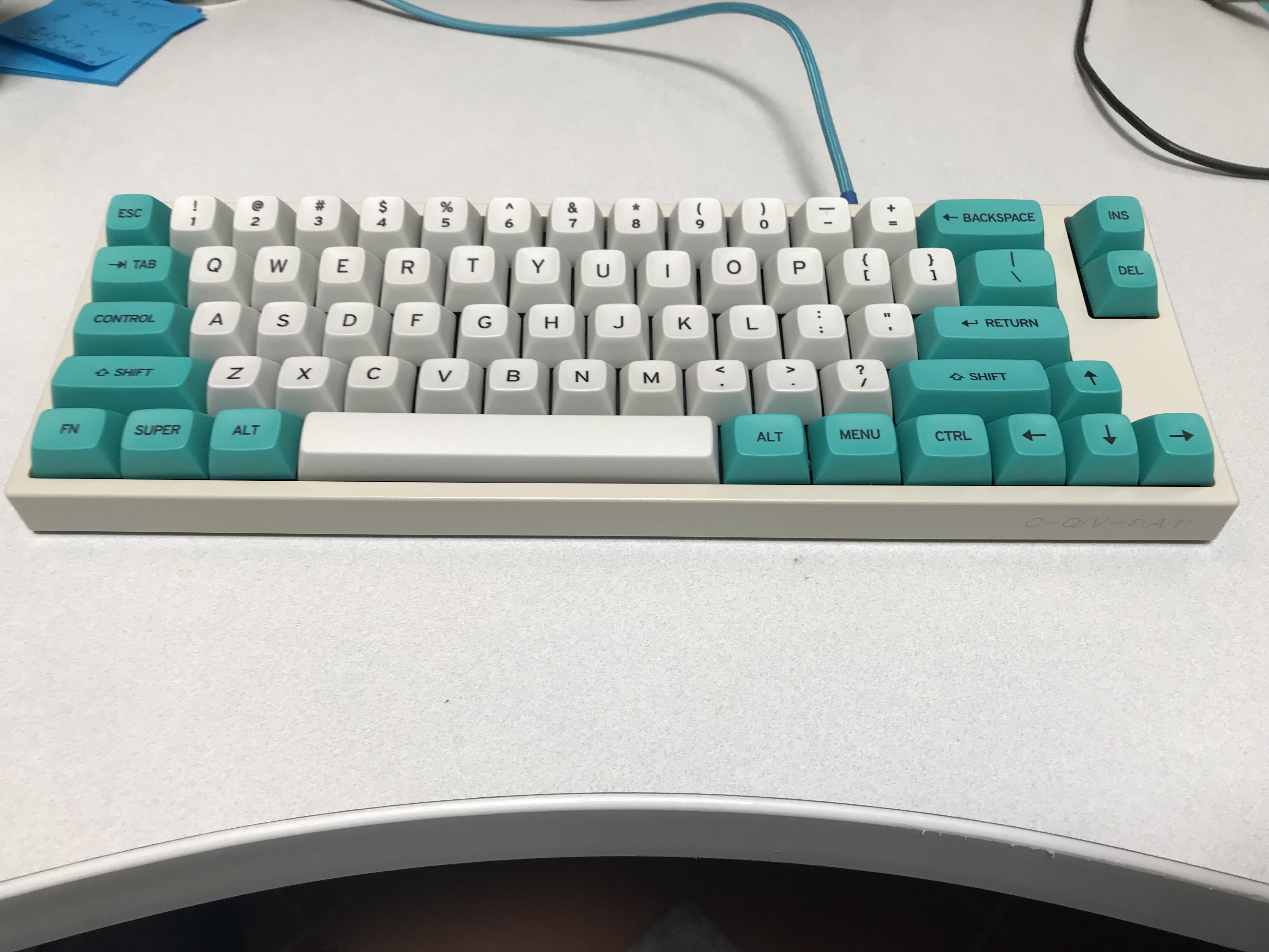

Modding my Leopold FC660C
Hi Friends -
Good evening and happy Thursday. I hope you are well.
I recently purchased a Heavy-6 because I make good financial decisions, so now I am working on modding my FC660C to match the case in all of its endgame glory. My current plan is to install the following: a Hasu controller, BKE lights, and KBDFans 1U Topre to MX sliders on the 1U keys.
With that being said, my questions are as follows:
  1. Is it possible to completely convert an FC660C to MX sliders?
  2. If not, does anyone have leads on where I could buy a set of FC660C modifiers?
  3. Are there any mods that I am missing? I know lubing is a thing, but I want more experience with the board stock first.
Thanks in advance, everyone, and happy clacking!

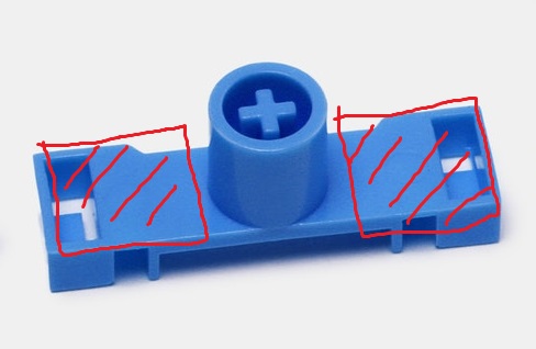

There’s a slight difference between cherry profiles and topre profiles. I’d recommend just switching out the modifiers and just leaving the spacebar as it is. You would have to drill the enter, backspace, and both the shifts.

  2. The 2u sliders needed a little sanding (I used 220 grit paper) on the long edges to stop them from occasionally getting caught up in the housing.
  3. You need to drill holes in the housing so the stabilizer stems of the stabilized keys don’t impact the housing. I did not do a good job on this and came close to really messing the housings up. You could alternately remove the stabilizer stems from the keycaps if you are sure you are not using them anywhere else.

This is what I do also except I use thin surgical tape and Deskey #3. Padding does most of the work but the tape is used to take the sharp edges off the sound made when a slightly off-balance stab side slapping against the case.
