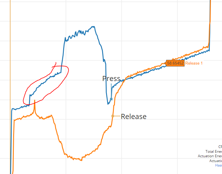

Typically this is observed by the amount of “squiggles” on a force curve graph. I think currently we (as in the keyboard community) define smoothness by: Lacking friction*
For example
In the area I circled in red, most of us would say this switch is pretty smooth in the area circled. Most of us would say that because the peaks and valleys during this section aren’t that extreme from the line they trend from. (I’m not good at words, but I hope you know what I mean)
If anything, the best we could do in this respect would be to add quantitative values for this phenomenon to help guide us and determine switch smoothness. This would also help against the issue of graph scaling since if you scretched or pinched this graph, the “squiggliness” of this graph would be lost or amplified without proper context.
