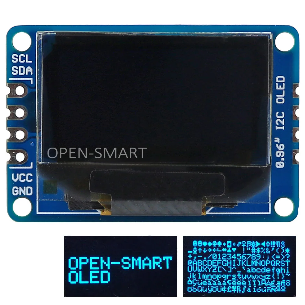

Bit new to designing pcbs so I just went with this ATmega μC. If there are better options let me know and i believe this oled doesnt have a fixed address though I have to message the seller for the spec sheet.
