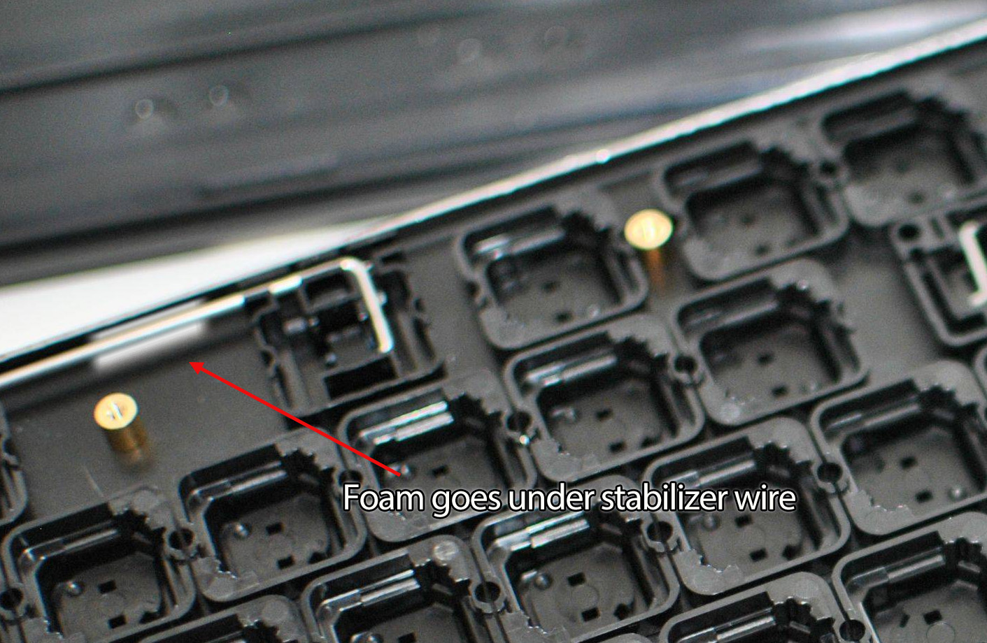

I don’t have a HHKB, so not sure what style stabilizers it has, but on my Novatouch, I opened it up, added a liberal amount of Permatex 22058 Dielectric Grease to where the metal bar winds through the plastic stabilizer, and then my “secret sauce” is putting tiny bits of low density (hence very springy) latex foam underneath the long part of the bar connecting the two stabilizers. I promise to take photos next time I open her up. This worked so well that I don’t find need to fiddle with it further. (i.e. I’ve not tried the tiny o-rings on the spacebar).

Welp, I haven’t had a need to open up m Novatouch since then, so no photos - however it’s a really easy mod. The trick will be getting some latex foam - I got mine from an pillow (they’re $50 - eek) – but here’s a cheaper option:
I cut a really small strips - about 1cm long by 3mm – right off the edge, so it’s in an extruded triangular shape - I then put them under the stab wires on either ends - totally dampen out all sound.
Is this silencing the upstroke or the bottoming up?
both are pretty quiet - it also increases the pressure required to press down, but just a smidge. You can control how much by using more or less foam

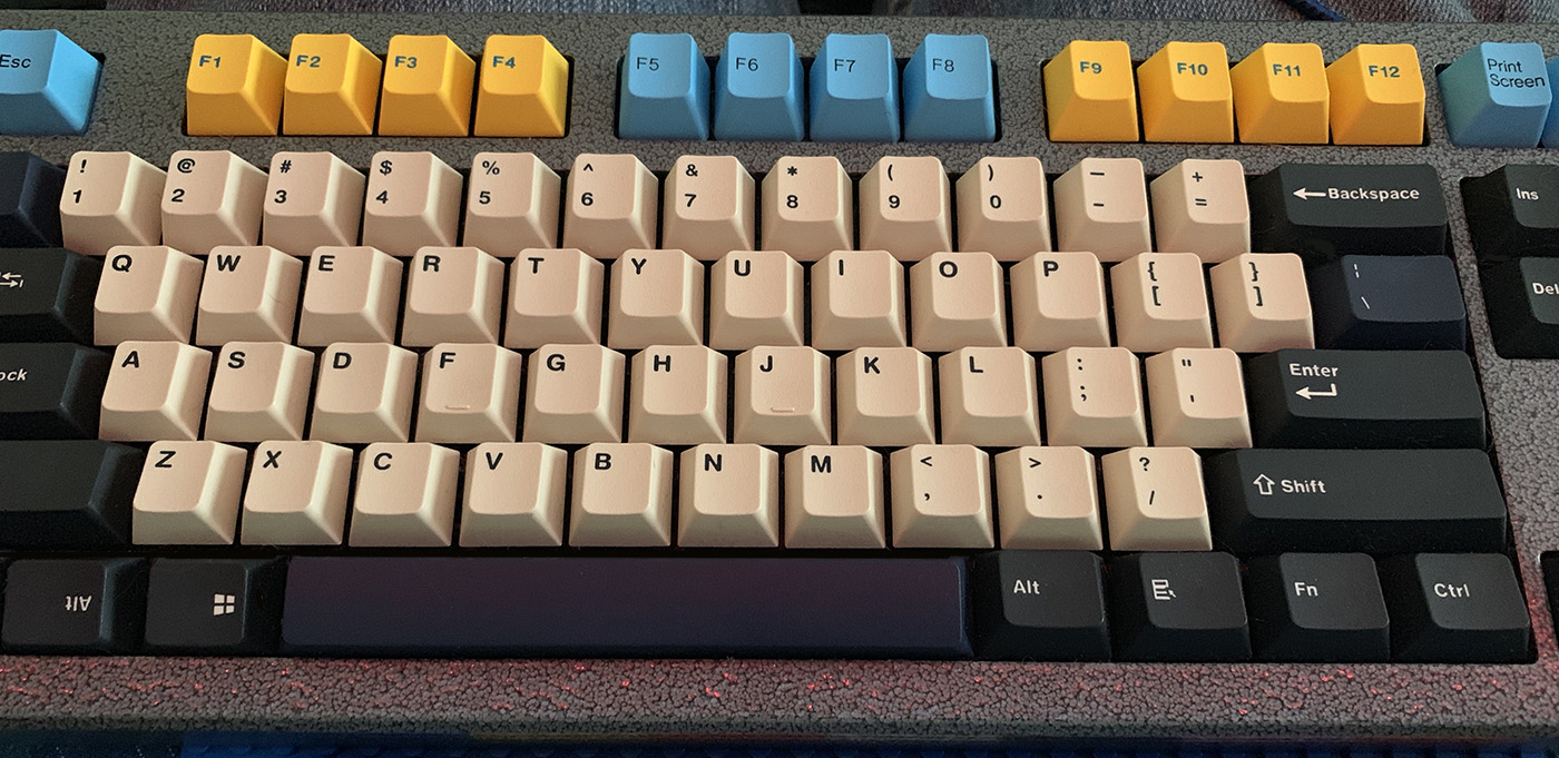

Can I ask what keycaps are you using?
I’ve scavenged keycaps from 3 different Leopold keyboards (which are super durable & awesome double-shot PBT) - charcoal, yellow, cream, plus a couple caps from Taihao (blue F keys).
Apologies for the not-so-great photo - I need to take some better ones:
Thanks for sharing that photo and explaining your process. I quite like the stock Novatouch, but it might be fun to mess around with modding it for an even better experience. You’ve got my gears turning.
