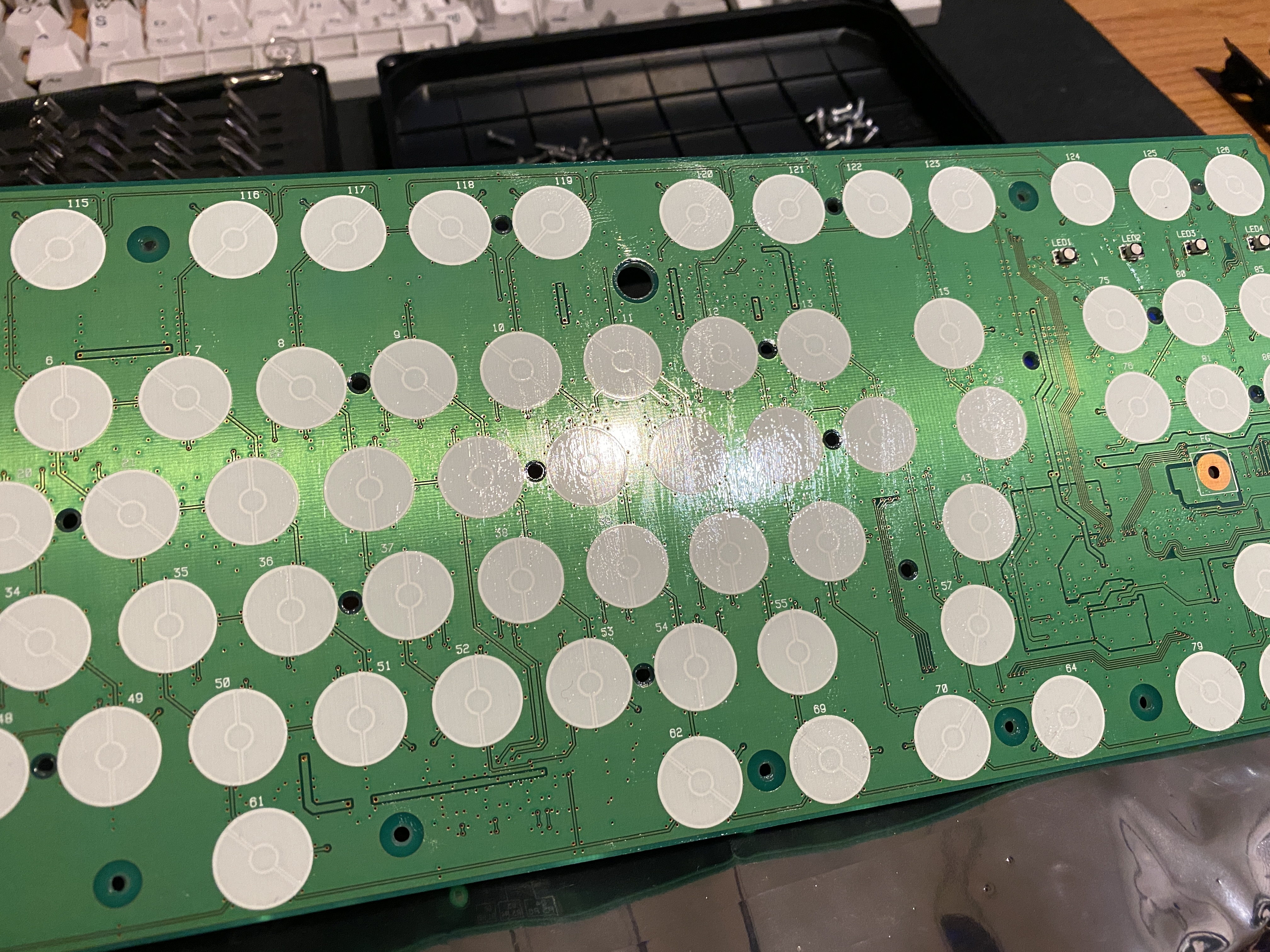

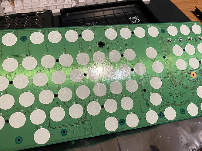

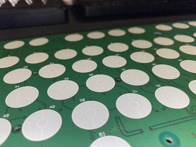

While you’re already doing the dome swap, a veeery thin layer of dielectric on the PCB does wonders with springs banging around underneath the domes. I used to hate that on my Realforce, and it got better from doing this.
If you use too much, the springs may bind on the PCB slightly and double keypresses will thus not register sometimes. Simple fix is to just open it up again and spread it around and wipe your finger and repeat a few times!
is the springs thing an issue with these domes specifically? I never had any issue with the springs banging around with either the stock domes or the BKE redux, lubing the PCB sounds like a giant mess and waste of lube to me.
Not lube - dielectric grease. Like Permatex!
When I smack my keycaps I could feel the springs sort of bouncing around from the force. I noticed with my 55g topre that on the return I could sometimes feel it too.
I guess it depends on your board, but it made the overall typing feel a lot more solid for me!
