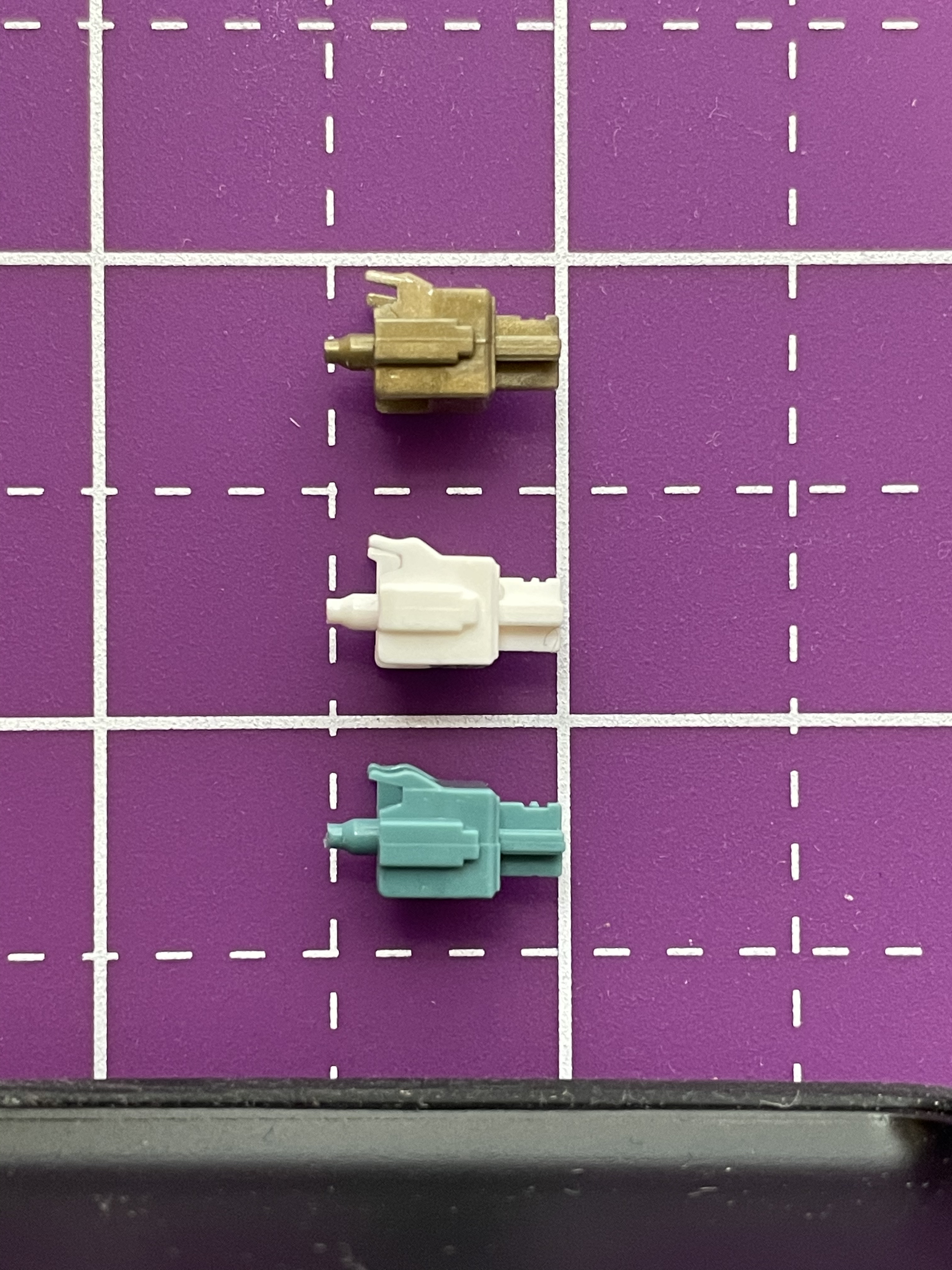

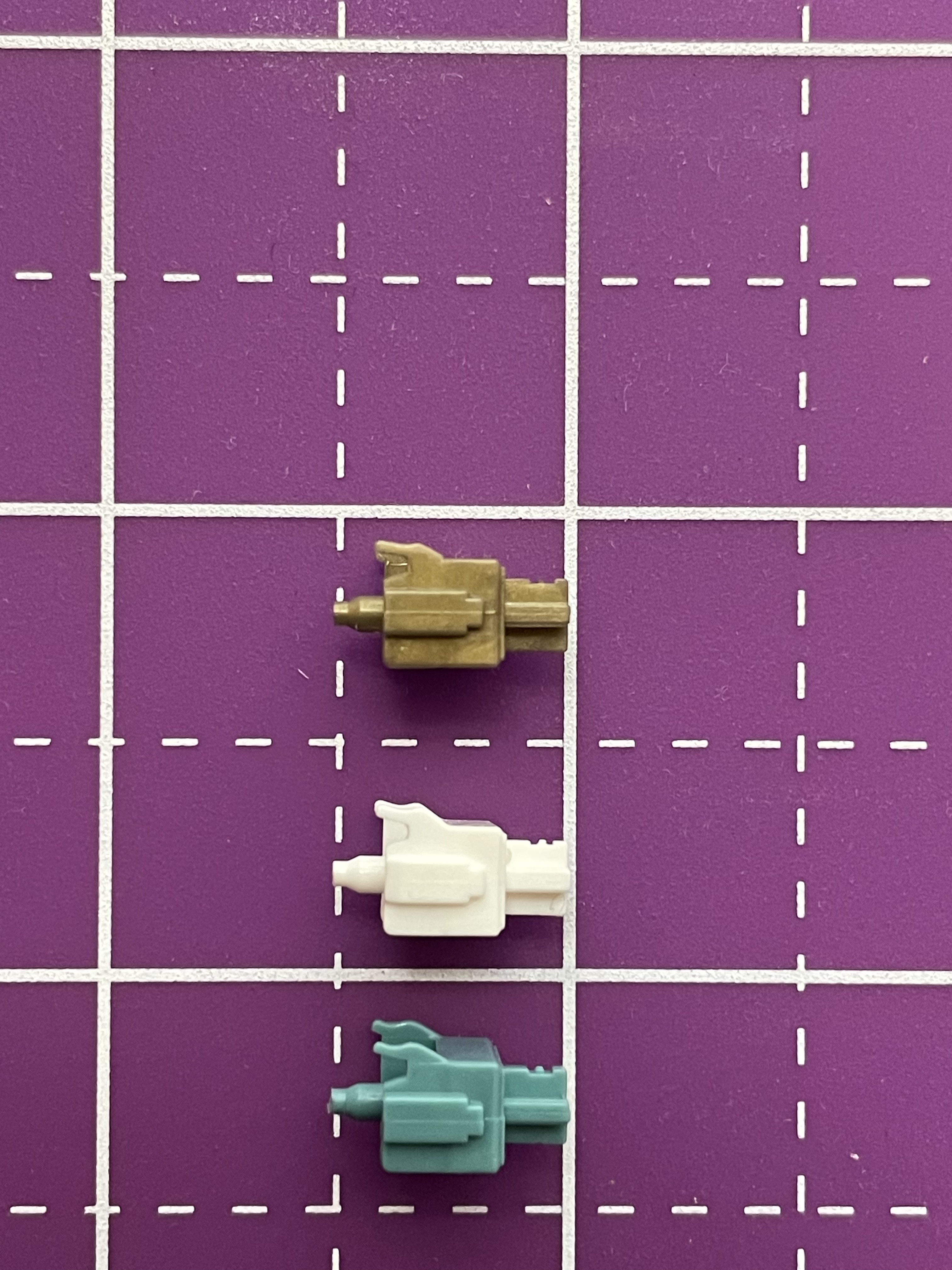

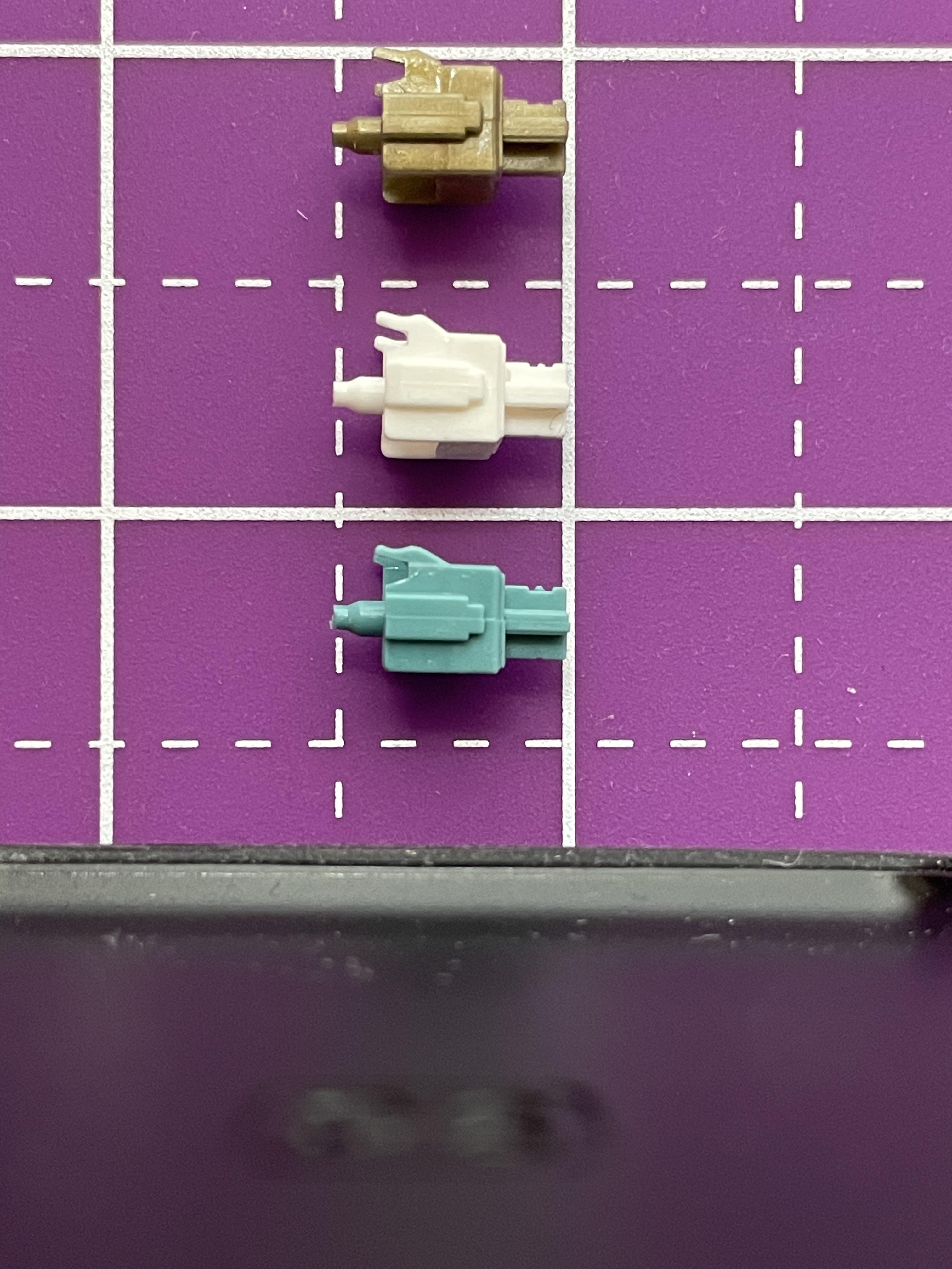

They are absolutely three different stems. (These are Pewter, Dragonfruit, and T1)
The Pewter/Light Tactile stem is similar to the Rara stem, but its bump deviates much less. The Rara and Pewter stems both have bumps situated a bit nearer to the cross of the stem (so, later in the press) than the T1 stem.
The leaf is also different, at the very least between T1s and the other two types of JWK tactiles. But it is not the only difference.
