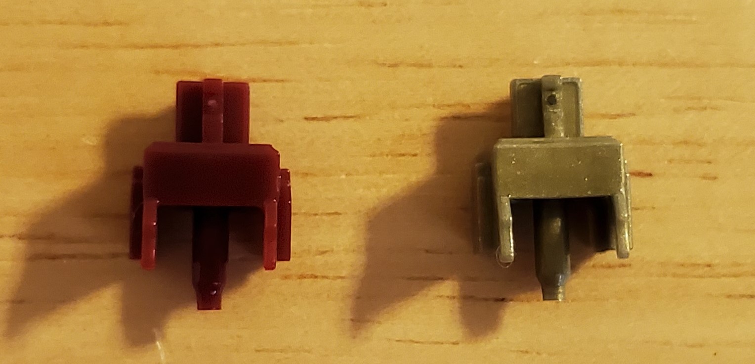

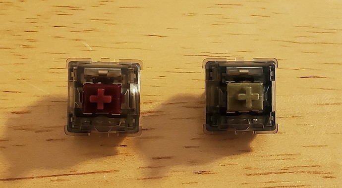

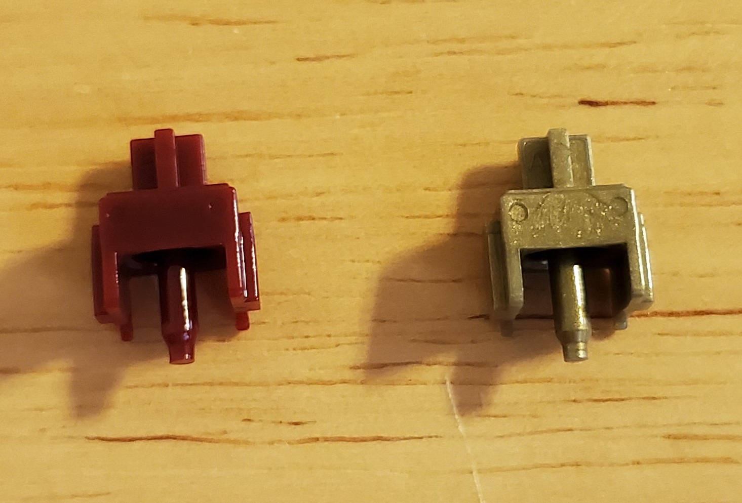

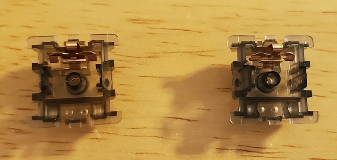

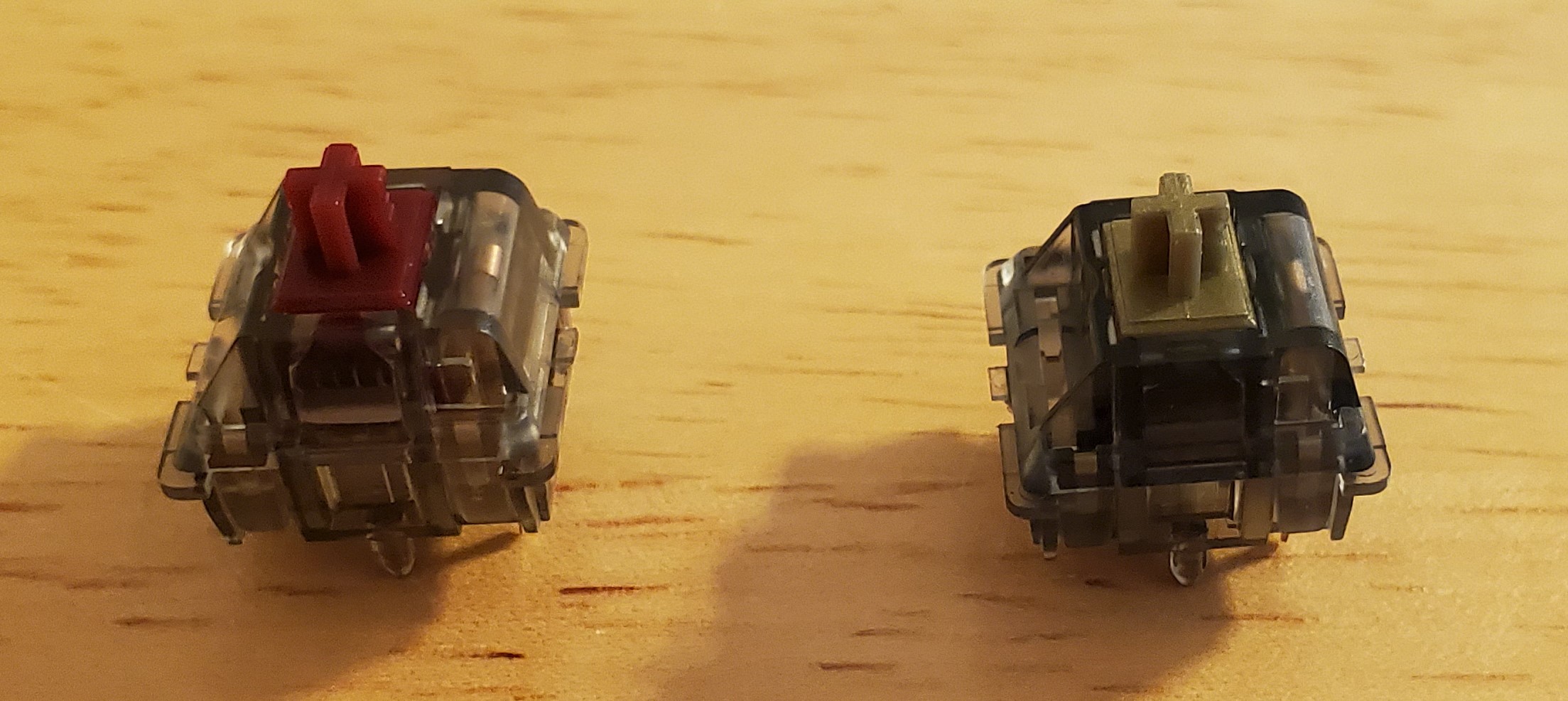

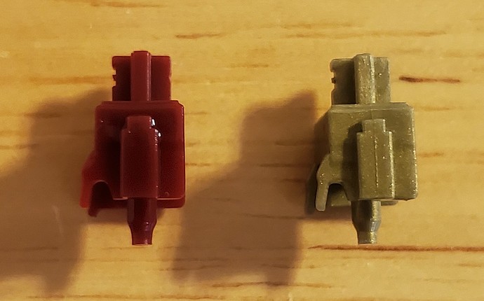

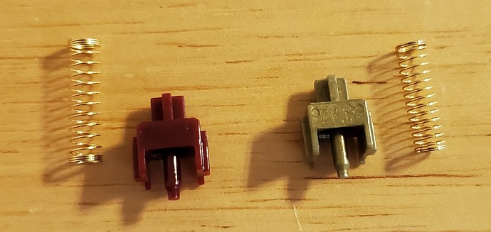

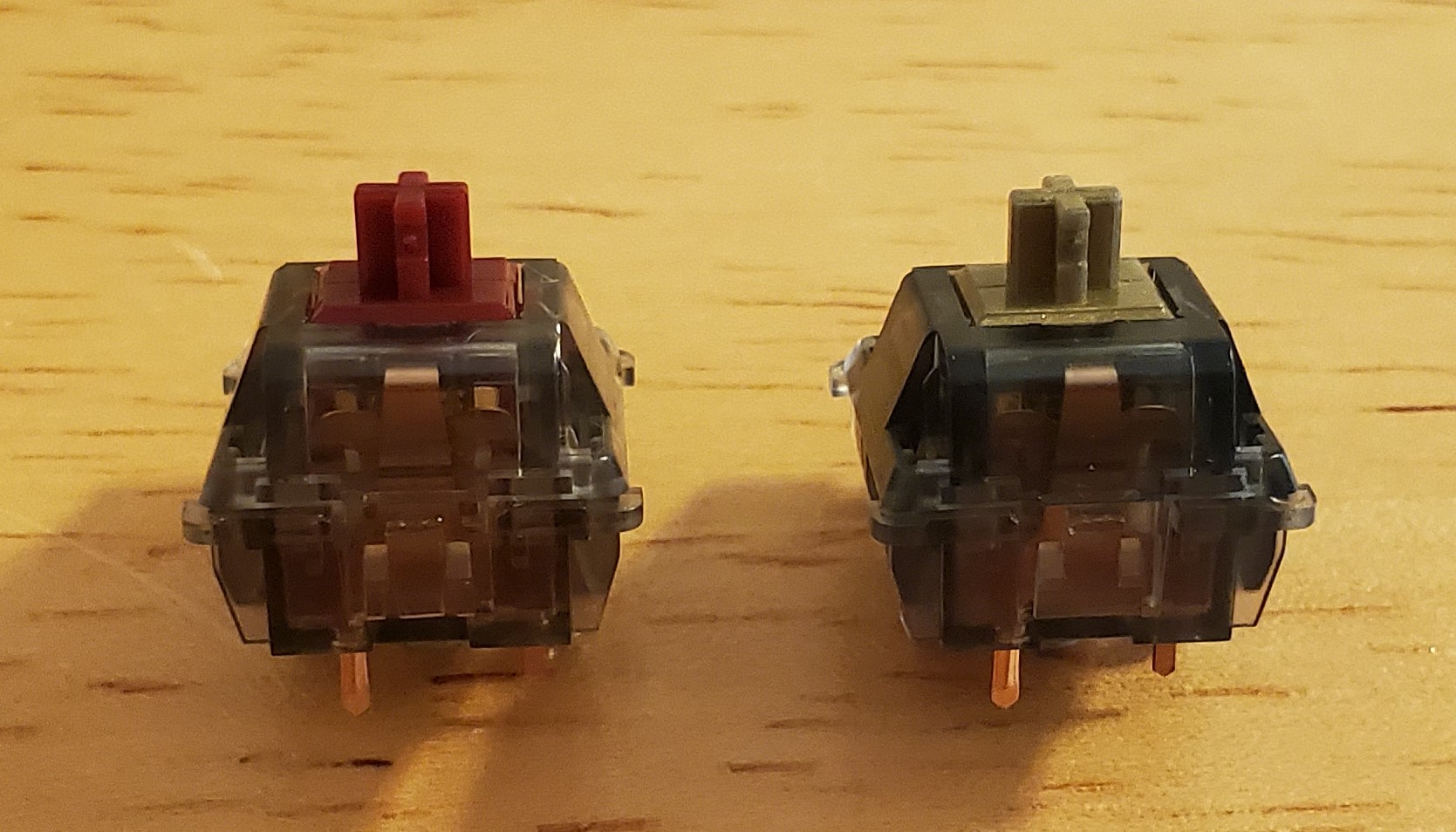

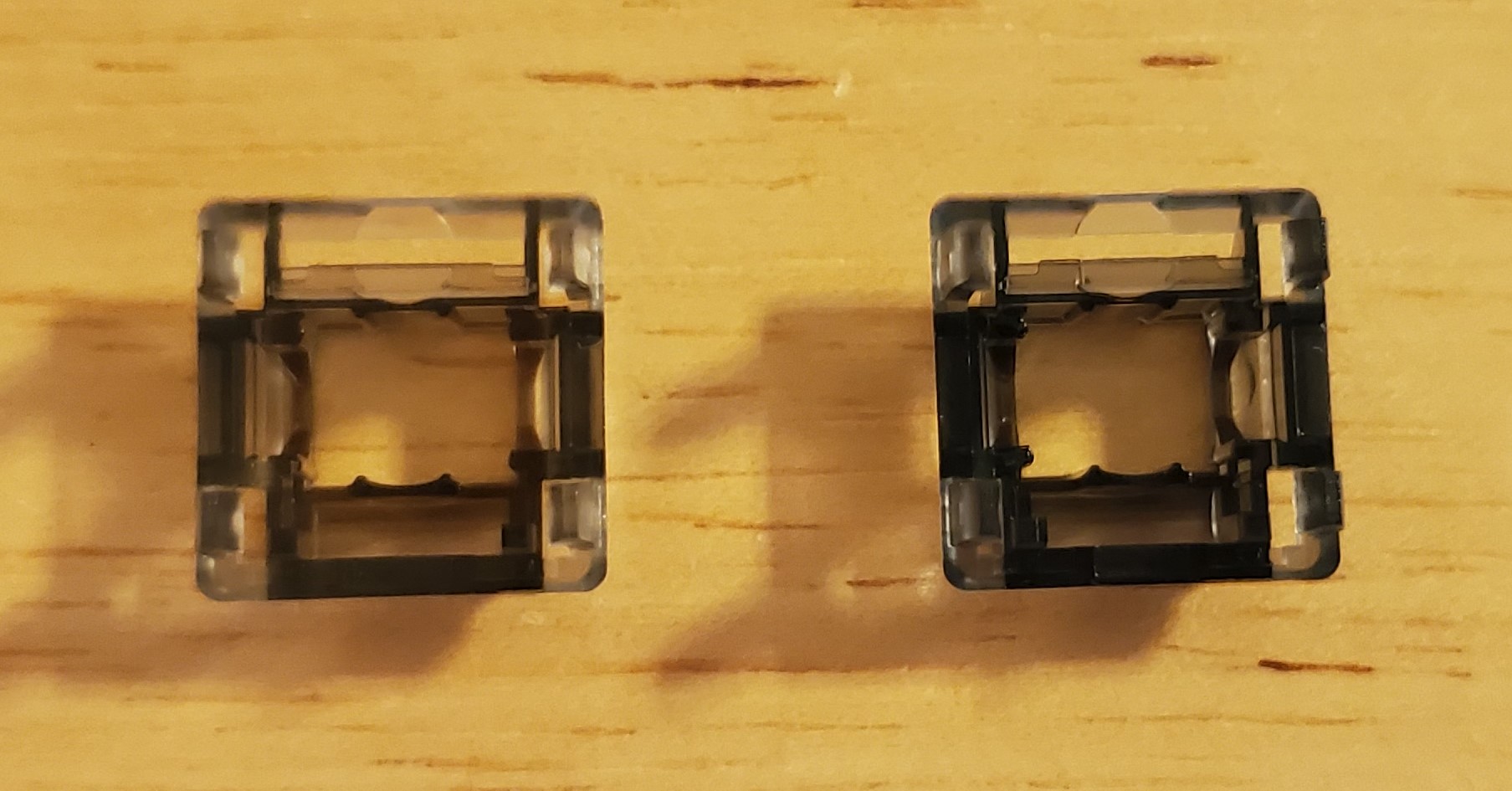

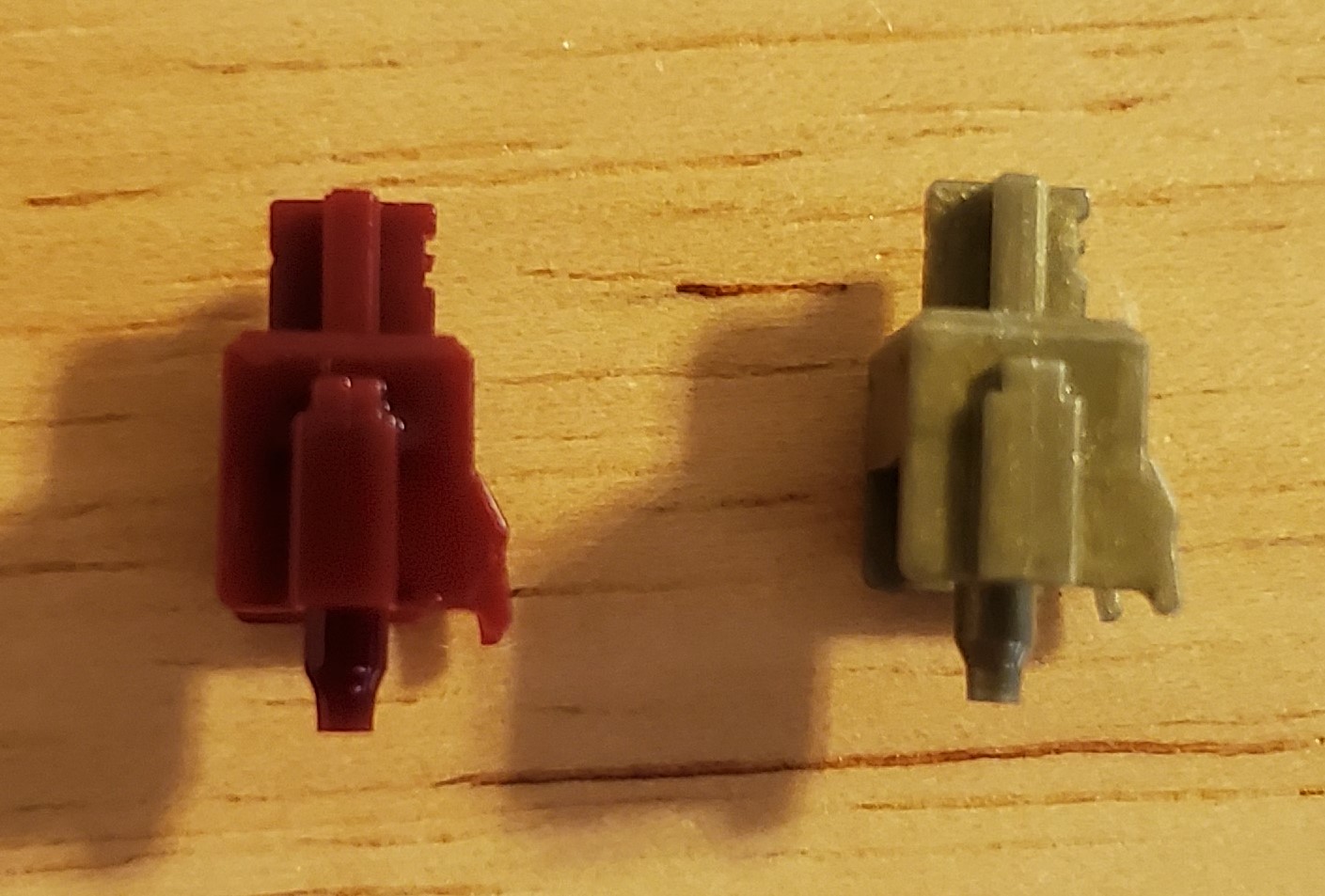

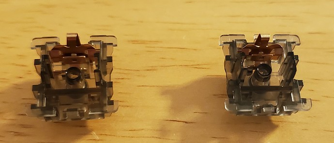

A bunch of comparison shots of the Durock Light tactiles (left) & Parallel Pewters (right). Form your own decisions from the pics, but the light tactiles really seem to me to be almost copy of the Pewters. Mold marks match up well & stems seems shaped the same. The only major differences beyond color I can notice is the Light Tactiles have different housing materials (nylon bottom, PC top. Pewters have a PE blend housing), the springs (67g for the Light Tactiles & 58.5g for Pewters), & the Light tactile stems seem to be polished while the Pewter stems do not seem to be. Both great switches IMO/IME & will get you a very similar typing experience regardless of which you use. The Pewters have a slightly higher pitched sound due to housing material differences which seems to be the biggest difference I’ve noticed between the two.
The only major complaint I have about both of these switches is that Durock/JWK went way heavy on the factory oil application on both. So they do need to be cleaned out before proper lubing. Whether that is a full ultrasonic clean or just wiping the parts off with dry lube applicators & tissues, it makes a big difference. While whatever oil they use at the factory mixes well with Krytox & Tribosys, there is so much on these switches it will significantly thin out whatever your lube of choice is. Anyways just wanted to post this for you guys interested if there is any differences between these two switches. :metal:

It’s interesting, I don’t see much of a difference in your pictures, however I just got mine and after trying them and opening a few, I definitely feel a see a difference between these and my pewters.
The light tactiles feel even less tactile, cannot even feel the bump while I can in the pewters. The bump in my pewters is very small but it looks pointier to the one in the light tactiles. The steem in my durock looks almost a linear with just a change in the angle, if that makes any sense… I’ll try to take some pictures later.
I’m quite surprised my durock seem to look different than yours…
Could it be they went heavier with the polishing and took out some of the bump?
No idea how that process works
