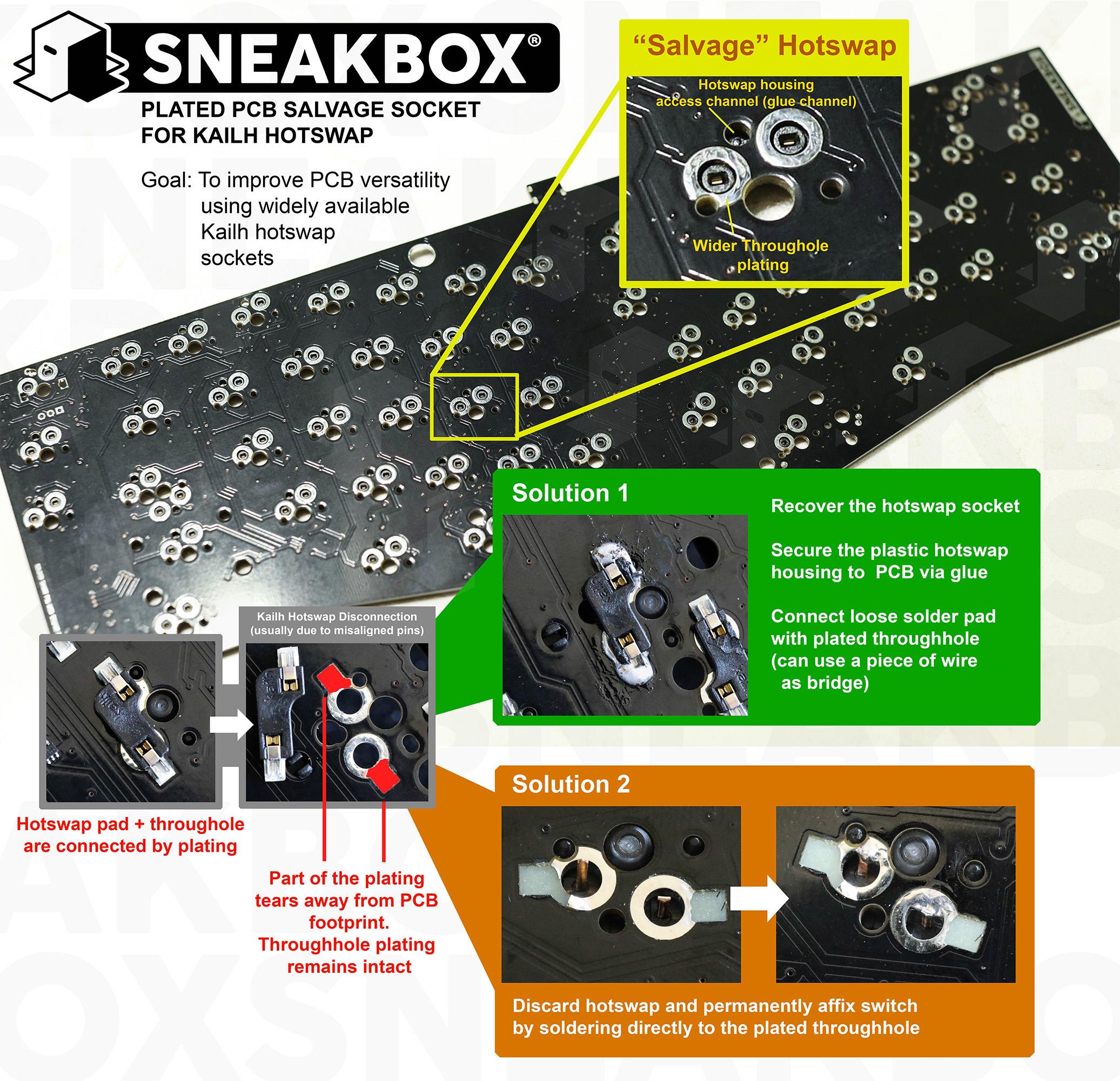

This is from Sneakbox the designer/creator of the MGA Standard and the AVA. I can’t believe this hasn’t been done before now. All of his hotswap PCB’s going forward will have this fallback implementation. And “salvage socket” is just a great name.

Really smart how they ran the traces on the top side to the through holes on the front so it doesn’t matter what happens to the pads. My experience with Kailh hotswaps is limited but I did rip a pad off and I wasn’t able to fix it with bridging so I appreciate any backup options. I don’t know if I would fall back to gluing but nice that it is there

I wonder if a strong glue applied up front could help strengthen the socket as well.

Looks like a pretty cool idea. I don’t really understand the “glue channel” part.

I’m guessing it’s an added layer of attachment for the socket as it would only be soldered to the surface of ring pad under the pcb which could probably tear off as easily as the original square pad. It would have to be some good glue to help keep it in place though.
