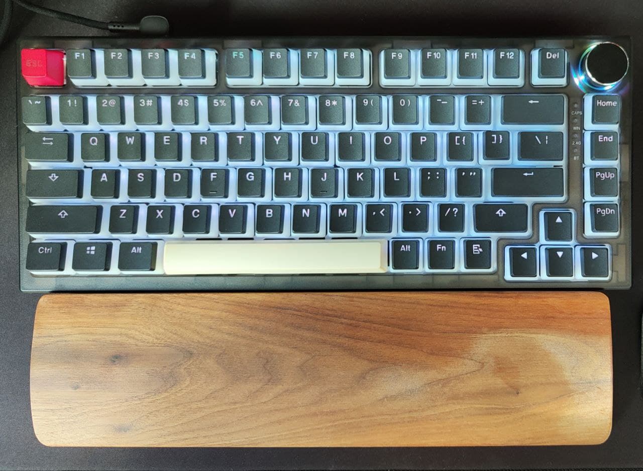

Hi all!
Sorry for the waiting but it took some time to have all the pieces together but finally… here we are!
Quite similar to the K2, apart from the knob, due to the same pudding keycap set, but hey, definitely more silent than before and not so bad to type on it.
Build specs:
  • KIT: Feker IK75 V3 3-Mode Transparent Black;
  • Switches: Outemu Silent White, lubed and filmed
  • Keycap: quite cheap pudding set from Aliexpress, apart the space bar which is from another retro set I have;
Other Mods:
  • stabilizers cleaned and re-lubed, Band Aid under them with some pads from a kit on Ali with an attempt of Holee Mod + center from poron switch pads cut and reused to have a more firmly insert on the plate;
  • poron pads on PCB, under switches;
  • some other little sponges under the stabilizers bars as an attempt to improve dampening;
  • O-ring under keycaps.
All the rest stocks as it came, so stock metal plate, no other filling under the PCB, no tape-mod (at least for now).
The only thing I’m afraid of is regarding the plate: since a PC one was included, and given that on many builds on Reddit I saw users preferring this one, could it be that I made the wrong choice?
But on my part I guessed that the stock metal one would give a better overall resistance, since the PC one would be prone to more flex, am I wrong?
Anyway, thanks all for the advices! :smiley:
Let’s see in the future If I’ll move to other changes on it, who knows XD
