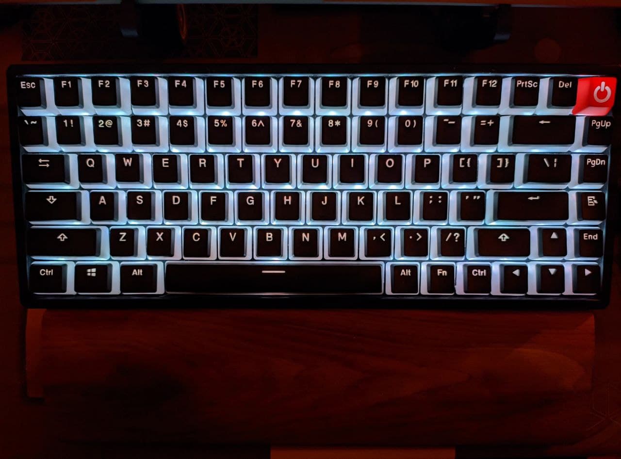

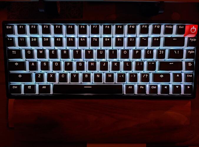

Another thing regarding backlight: I only recently discovered that most custom/DYI kit have the PCB with south-facing LEDs, which gave some issues to see-through keycaps like the one I have on my actual Keychron K2v1, which seems to have north-facing ones.
So I wanna ask: how much backlight will I lose choosing a south-facing PCB? Do I have to prefer north-facing LEDs kit to maintain (almost) the same backlight?
Attaching a night sample of mine to have a base to compare with:

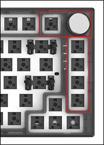

  • there is the Feker IK75, but I have to understand if and how some of the keys can be edited, since I’ve seen some videos but no info on the program to use are to be found: this because I need the PrtSCn key to be used without keys combination @ work, mostly.
