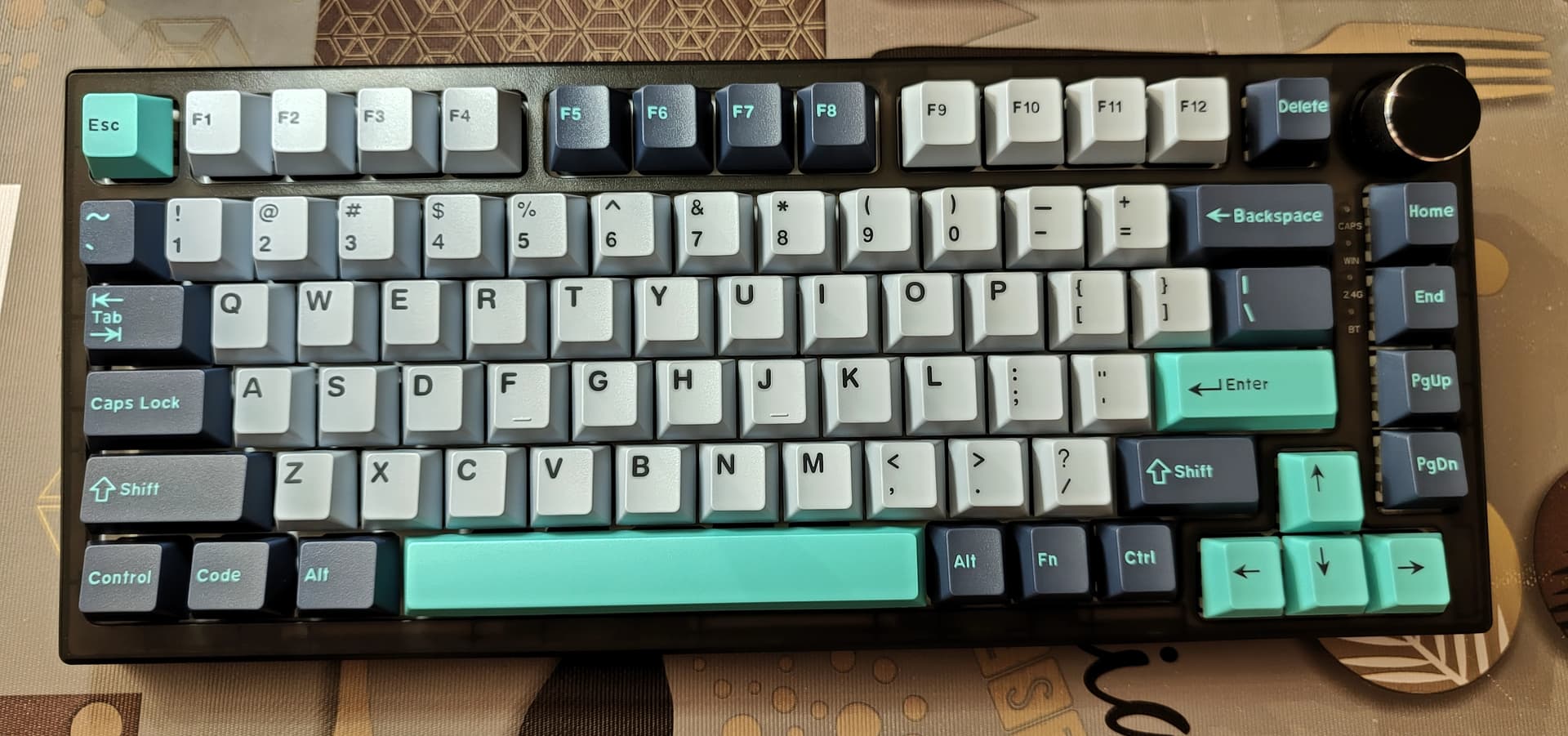

Hi all,
some of you may remember me as from my old thread where I asked for some advices on a K2 substitute:
Well, yesterday I’ve finally completed my new silent IK75 v3 and the final outcome seems quite good to me.
Here it is with the Hammerhead clone keycap set that I received a couple of days ago:
Here’s the list of mods I’ve made:
  • Switch lubed and filmed;
  • Switch pads and switch plate pads
  • Stabilizers lubed and an first attempt for holee mod;
  • Feker silicon pad inside the case
  • Hammerhead clone keycap set :upside_down_face:
plus, I’ve tried (and I don’t know if someone else has, since I didn’t read it around) tape mod with 2 layers of automotive cloth tape, which I wanted to try since it should dampen sound plus be safe, given being flame retardant too, so should cause issue with batteries.
UPDATE: here’s the audio tests made from my Oppo Find X3 Neo, so don’t blame too much for the quality, but should give you an idea regarding sound improvement:
Thanks again to @Deadeye, @HungerMechanic and all the others for the help :grin:

@Deadeye you should definitely give it a try, just to understand if it worked well on mine due to the silicon dampener in the case too or not.
I’ve only made 2 layers, don’t know if one more is needed, as most people around do usually, or not.
I forgot to say that I’ve put some of the same cloth tape on the silicon pads between the case parts and recycled some Poron from the switch plate pads on the part of the metal plate that sits on the silicon pads themselves, to try to dampen sound even more :sweat_smile:
will try to post a photo asap to better explain it.
Well, TBH when I took the Silent White I thought about taking the Silent Peach instead, but wasn’t sure if they’d cover the backlight of the keyboard, so went with the Silent White and their transparent enclosure, but I understand that maybe my assumption was wrong.
Waiting for your audio tests with Silent Lemon, to hear how they silent they are (even if tactile and not linear as mine :slightly_smiling_face:)
Would you take the time to try the tape mod with automotive cloth tape too? XD
If giving good results we can give a start to a new trend :upside_down_face:

Hey all, audio tests uploaded on Soundcloud and shared, let me know your thoughts on it :grin:
(ehm, sorry but I wasn’t able to embed them with the Soundcloud player :sweat_smile:)
Discouse (the forum framework KeebTalk uses) has an auto-embed feature, but it gets borked when you paste-in actual embed code. :stuck_out_tongue: Just paste the url for the individual track page, and it should turn into the embedded player when the post loads.
WTF, I’ve pasted only the URLs once I saw that the embed code provided by SoundCloud wasn’t working :sweat_smile:
Anyway, did you give a listen to them @Deadeye? :upside_down_face:
I might not have the right profile; is your username on there spelled the same as here? At very least a url to your profile should work.
yep, same username used here and everywhere round the web :grin:
just put both tracks public and followed you back, you should be able to see them with no issues :slightly_smiling_face:
Very clean and quiet! Night and day with the untuned / less tuned K2 there. I think you did a great job keeping the vibrations in check.
The embed feature can be picky; the exact formatting I used for that was https://soundcloud.com/user-987326993/ik75-mp3
Thanks a lot :grin:
Since it’s my first build having a good feedback from a more skilled user it’s great, thanks again :smiley:
And yeah, TBH I’m quite satisfied with the result :nerd_face:
