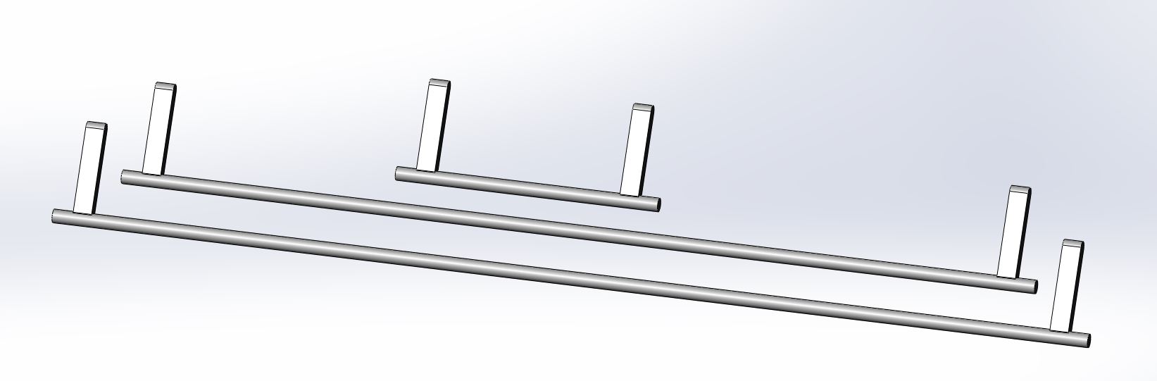

As far as the mod, I have been working on designing a wire replacement which would work on all of these and probably many other variants. The point is to take out some of the time and effort of tuning stabs. This will consist of a tungsten carbide rod, with Invar 36 tabs brazed to the carbide. The point of this being to take up some of the slack that is in the stem and housing. Thus tightening up the feel of the stabs and also eliminate rattle. I will post some pictures in the next day or two.

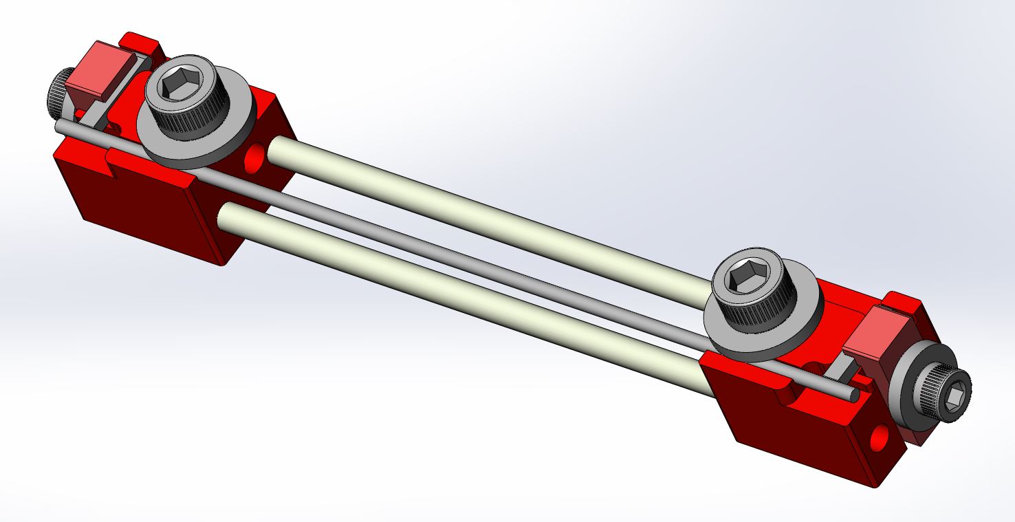

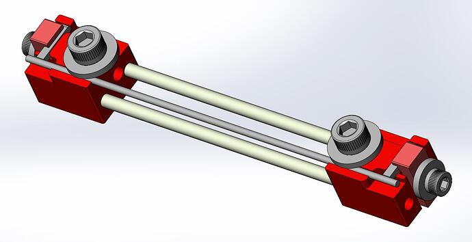

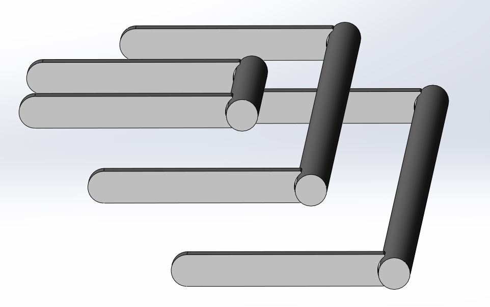

Appreciate the input so far. This is just an idea I had and thought might as well try it just to see. I did see the Wuque stabs, but have not ordered any yet. Here are the screen shots of the wires I am working on. So far all I have left to do is finish my brazing fixture designs and machine all the parts. I have the carbide rods in hand.

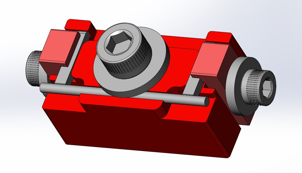

At this point this is what the brazing fixtures will look like. They we will also be made out of Invar36 and tungsten carbide to keep issues with coefficient of thermal expansion issues to a minimum.
The 6.25U and 7U are the same but the bridging carbide rods are different lengths.
