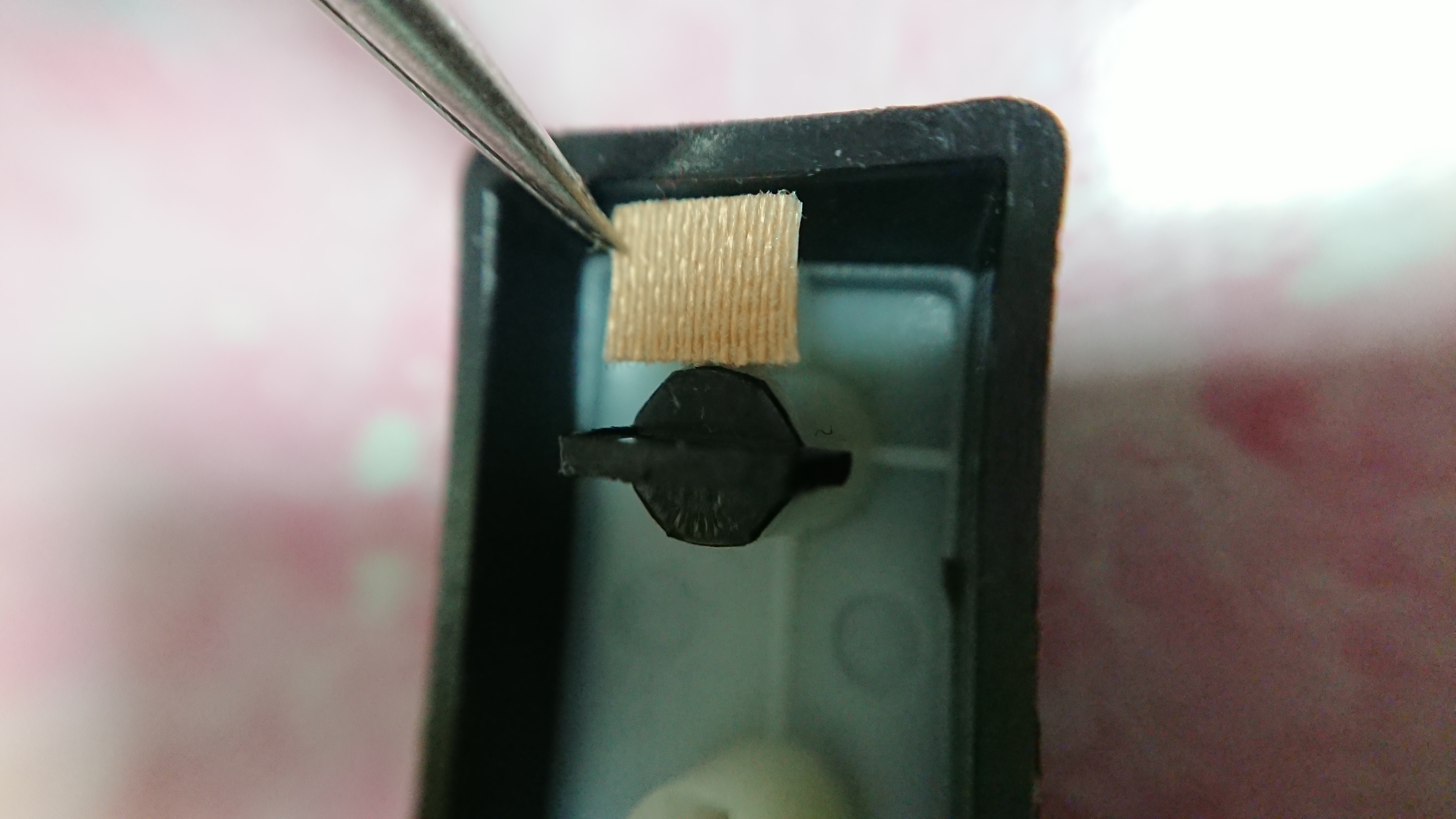

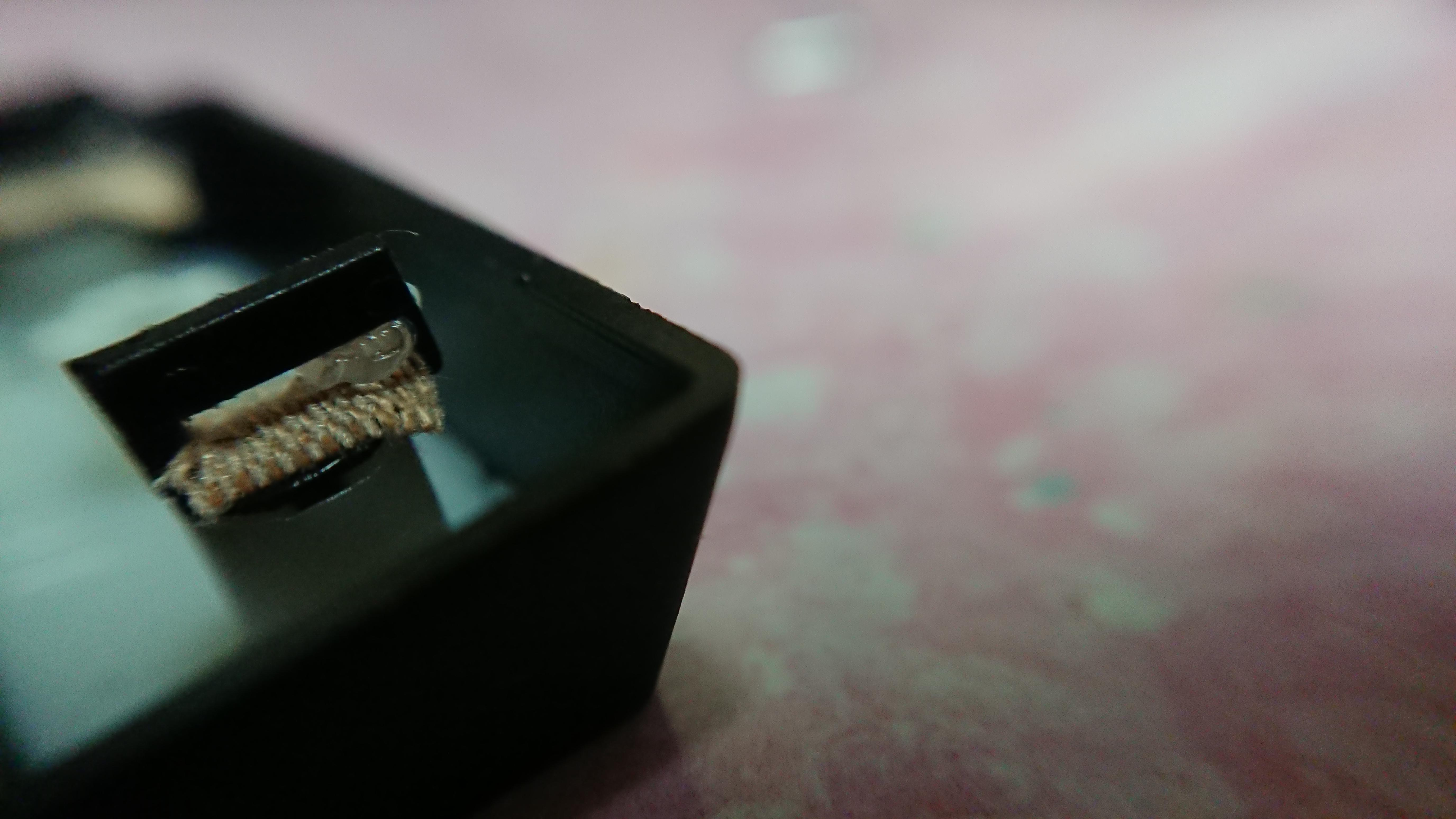

I have done the same mod with the 6u costar for my heavy6.
Regarding the rattly costar stab, the below mod makes it dead silent.
