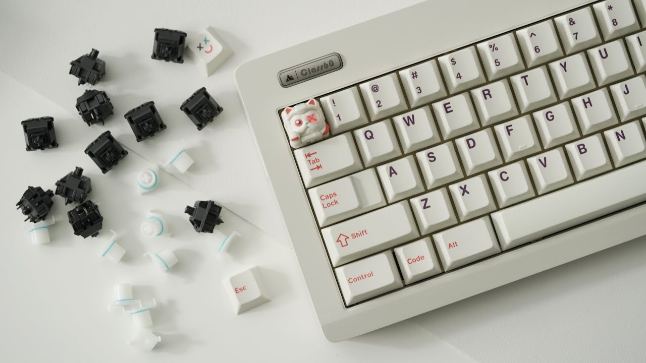

I ordered Class60 with EC kit but need a backup plan in case sliders/housing it comes with don’t pan out.
AFAIK they’re Niz sliders so two questions I have are:
  1. Is the Niz housing compatible with DES sliders?
  2. Does Niz housing have same dimensions as DES housing?
If answer to 1 is yes then I just need to get DES sliders unless Niz housing is also crap.
If answer to 1 is no but answer to 2 is yes then I also need to get DES housings.
If answer to 1 and 2 are both no then a custom plate is needed as well.
tbh, I’ll most likely just opt to drop the EC kit into a box and forget about it if the bleeding can’t be stopped at getting DES sliders.
I believe the answer to 1 is yes and the answer to 2 is definitely no.
Your standard Realforce housing has a slightly different size than Niz housings. Des housings are slightly larger than stock housings - you can make them work in the same stock-size cutout but Des housings benefit from an additional .1mm of added tolerance. I’ve never made a plate for Niz so I can’t comment on specifics but I know the sizing is different from stock/Des.
could you link where the Class60 mentions the plate is specifically cut for Niz parts? that’s a data point that is pretty important, and it would make me nervous if I were recommending this keyboard on the basis of Niz construction for the EC portion.
nothing wrong with Niz as a whole, and I’ve enjoyed their Hansung/Abko offerings…but having done an R2 Realforce TKL with Niz 1u in OEM–it’s not preferred. Des 1u > JTK/KBD 1u > Niz 1u sliders in OEM Topre housing. Now Niz 1u in Niz 1u housing is okay, or at least it was ok in their boards.
No mention of using Niz parts let alone plate cut but they sure look like Niz sliders to me.
You can see their sliders, housings, PCB and plate in this video:
Beside the look, its sound reminds me of Niz’s signature wet sound. Best way I can describe it is that it’s like the sound dog makes while lapping water after a run. Chop chop chop.
I guess some people like that. I don’t.
