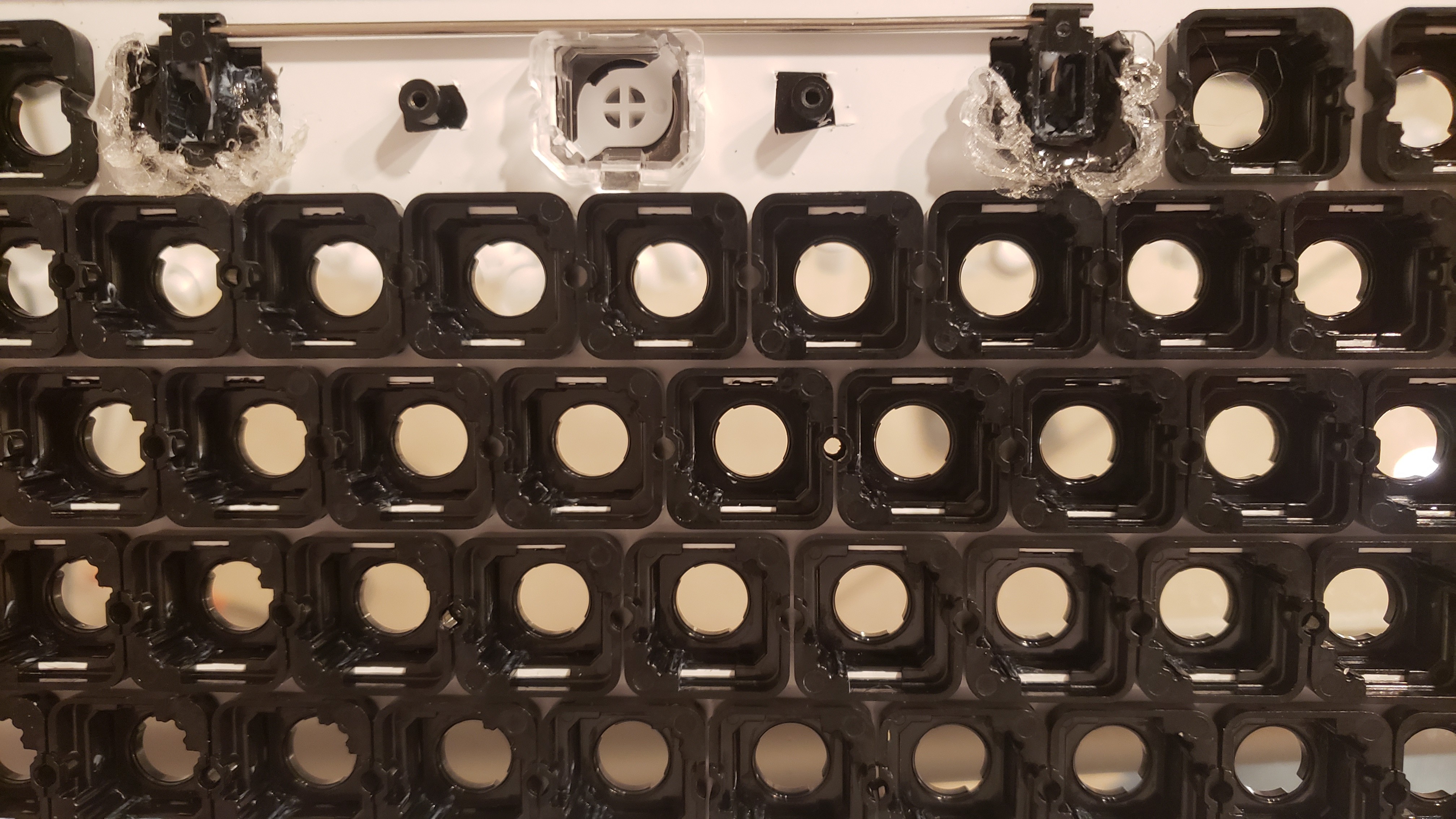

I know it is ugly but I have been running this spacebar setup for a few months now, no issues at all!
This will require a few rgb slider housings…I hacked them up just enough that a plate mount cherry stab would fit snugly between the modded housing and and the plate. Then I put caps on around the space bar and put the space bar on and positioned as I desired it. Next I removed the space bar, put tape between stabilizer and plate, flipped plate over and loaded with black epoxy.
Oh and you’ll want an rgb slider for the actual switch, it provides enough clearance for the stabilizer bar.
The result is a great 6u spacebar, comparable to my best built mx boards.
I know this is all a little abstract but nice mx compatible spacebars can be done, just need some patience and thought.

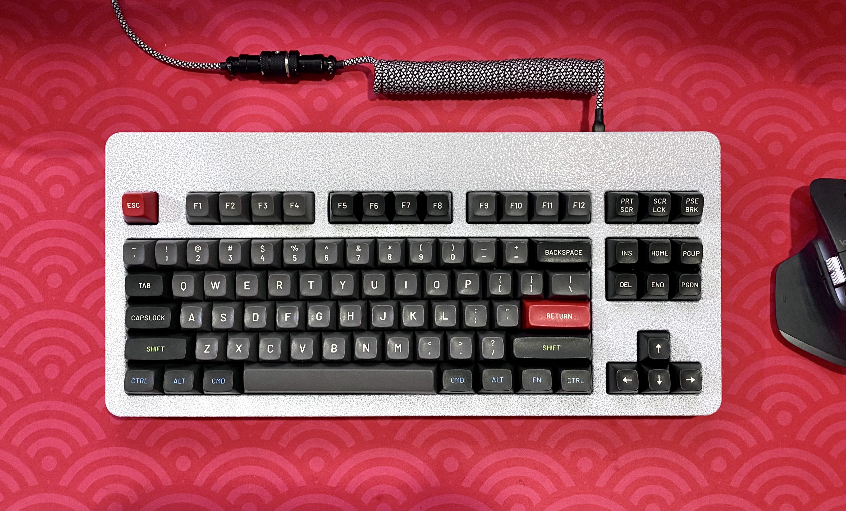

A few of the folks on Discord made the joke that if we modded our keebs, maybe it would bring on the announcement of Deskeys sliders sooner. Well, I thought I’d contribute to the karmic forces by finally modding my VHS Norbaforce R2 to be MX compatible.
https://imgur.com/BwDiZy5
Norbauer VHS Norbaforce Mk II
Realforce R2 30g uniform silenced + additional Deskeys #2 silencing rings
stock Topre 1u and 2u housings
combination of 1u JTK and Niz MX sliders pulled from an ABKO K935
KBDfans 2u sliders
Costar 6.25u stabilizer from ABKO K935
Leopold FC750R white on black keycaps; Artifact Bloom yellow accents
My original idea was to strip the K935 for the entire Niz slider unit and the spacebar stabilizers, but the housings on that keyboard seem to be built into the plate or held in by a rigid “gasket” made of the same plastic as the housing. So I just took the sliders and put the original Realforce silencing rings; used some Deskeys #2 and stacked them where I didn’t have any rings for some reason.
Installing the Costar stabilizer was interesting. I had to read this thread several times and look at photos closely–turns out my initial install was upside down last night. Even now while it sounds and moves well–it is crooked. So are the rest of the keycaps. I think that’s because I mixed Niz and Topre parts, but oh well.
The Leopold caps have a bit more plastic/clicky sound compared to the stock Realforce caps. I don’t know yet if the entire exercise was worth it just to have an MX-ready board; the sound is nowhere near stock silenced Topre. Probably need to sit a good month with this board and see if my experience changes.

thank you. it was borne out of novatouch aftermarket price desperation. i’ve since switched the caps to gmk hyperfuse redux, and the sound is much better. the spacebar still proves to be the most questionable part of the conversion as the costar wire has a tendency to get dislodged if one hits the spacebar at an angle.
