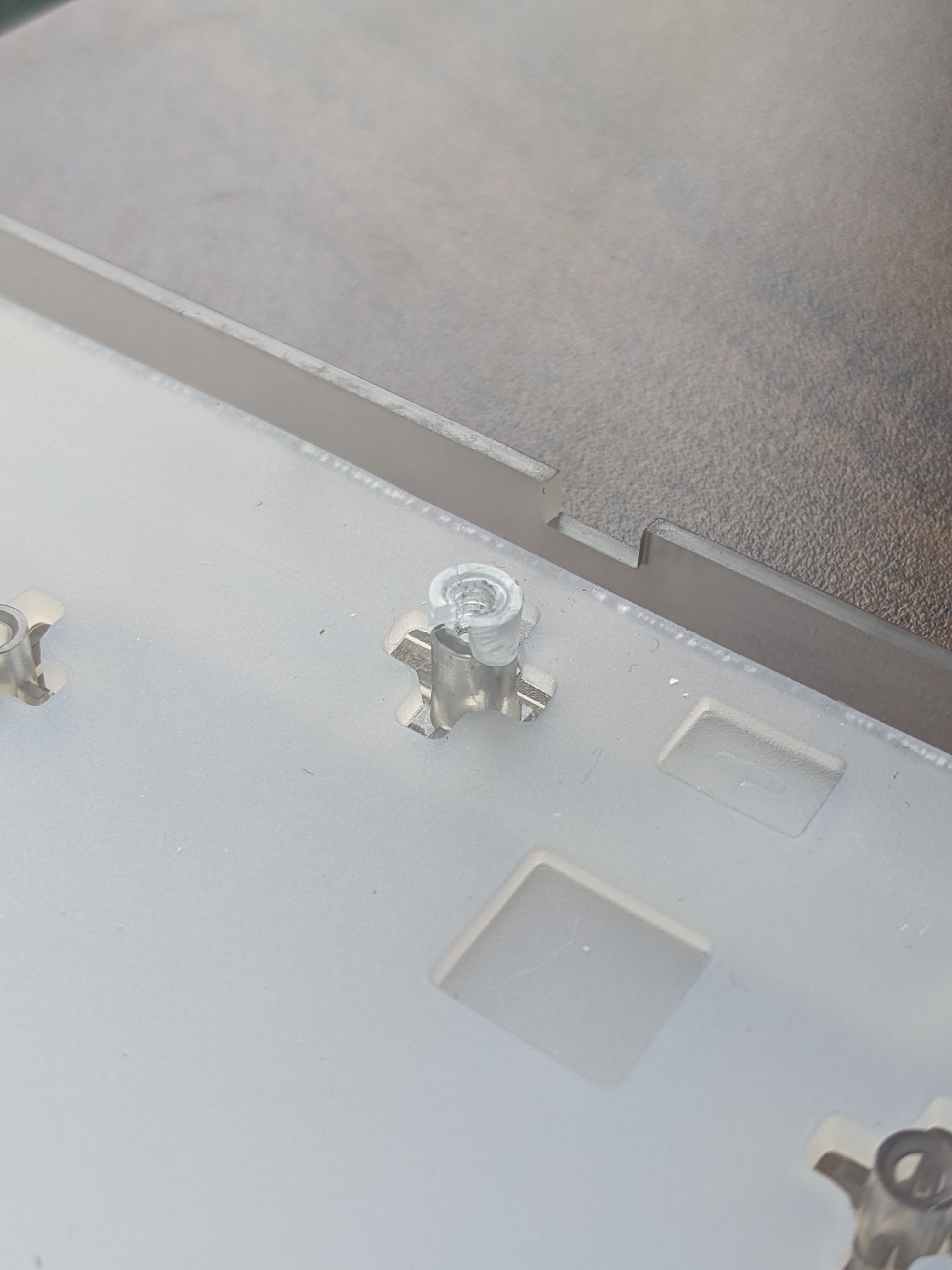

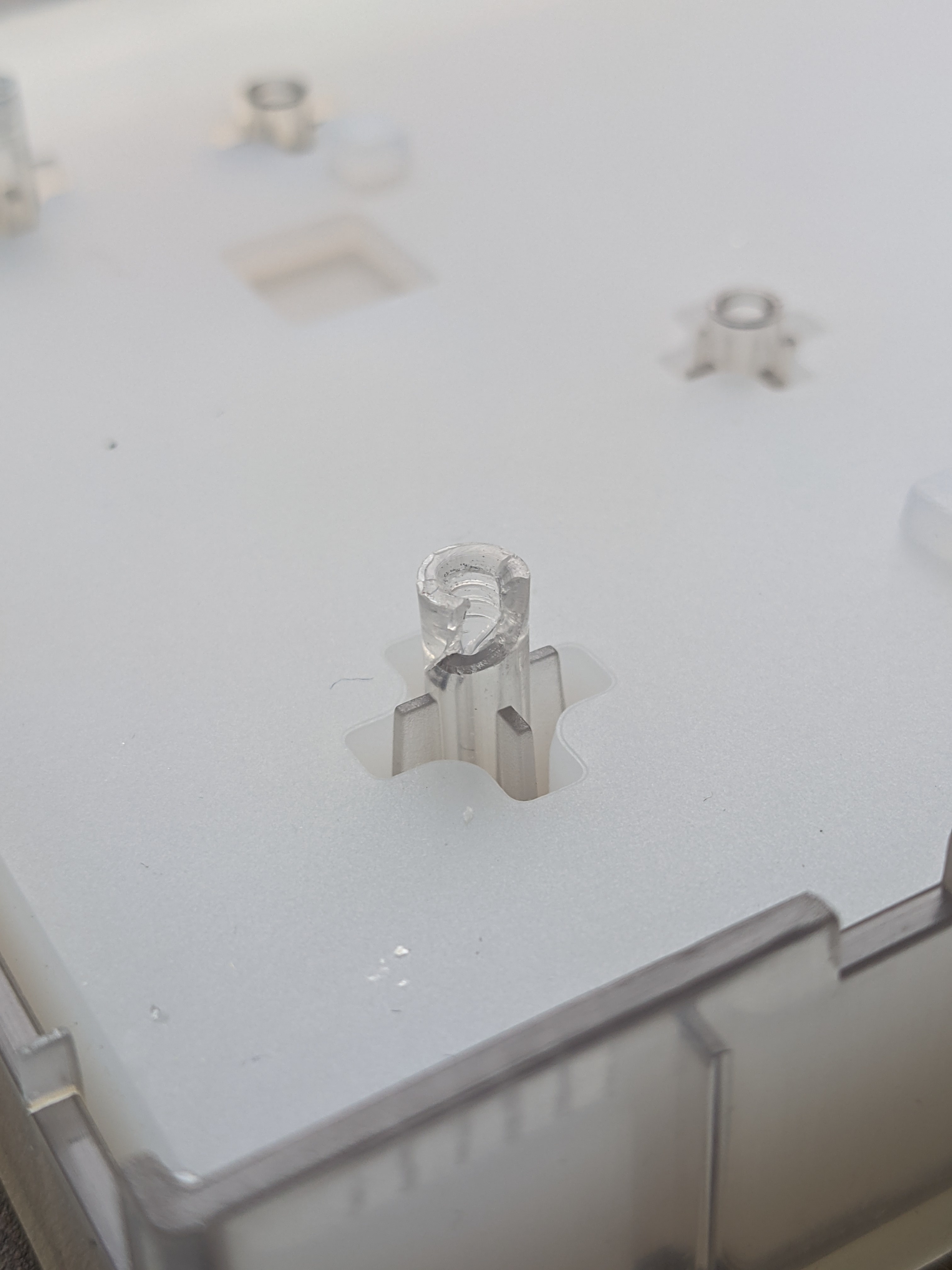

I’ve taken heart and opened up the case and found that two of the 6 posts are completely broken, while one is badly cracked. See pictures. Given how bad the situation is I will be looking for a replacement part.

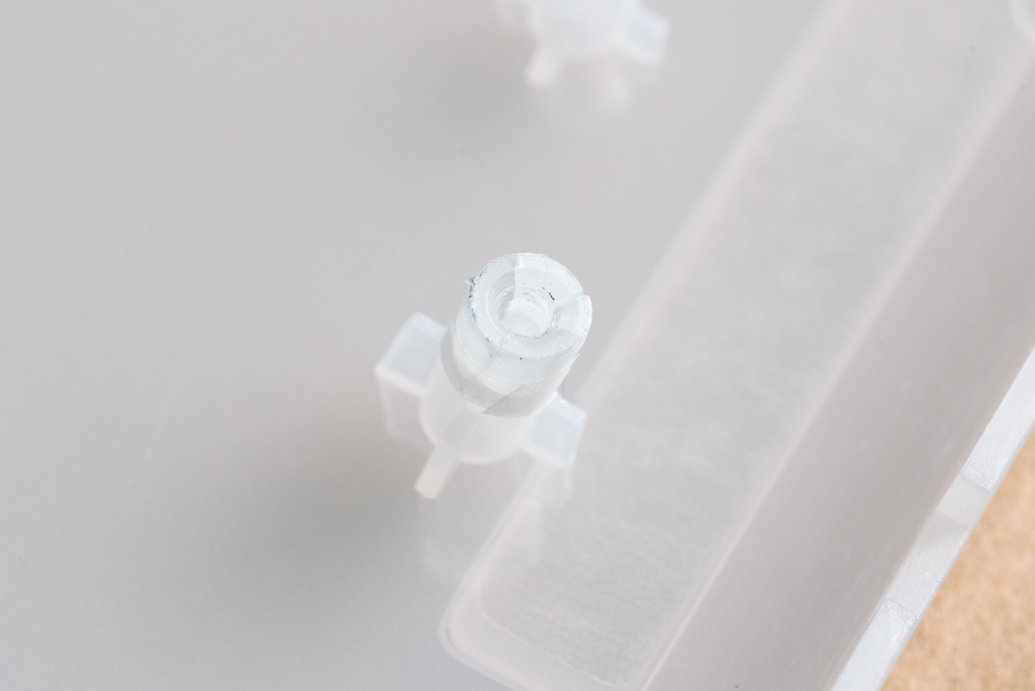

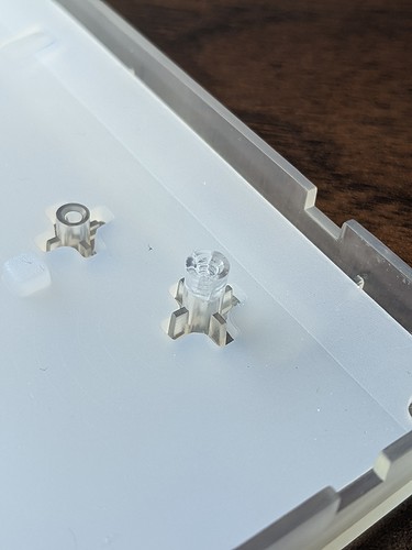

This was mine when I still had it (half of the post had split clean off). If you haven’t thrown away the piece that fell off, you can wind some thin Scotch tape around the post to line up the threads.
It’s a pretty janky “solution,” but it should be a bit more stable than not having half of the post altogether.
