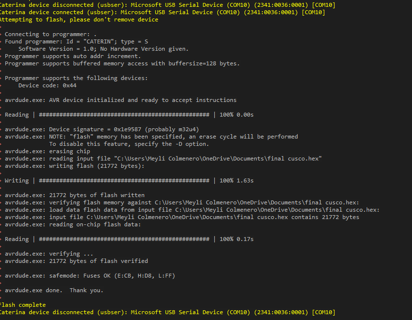

EDIT: i got the firmware to upload i think based on qmk’s confirmation, but the keyboard still doesnt work. picture of confirmation vv (i wasnt in bootloader mode before lol)
If i can get any tips on how to troubleshoot why my keyboard isnt typing out anything at all issue that would be awesome sauce.

picture:
That’s good, right?
