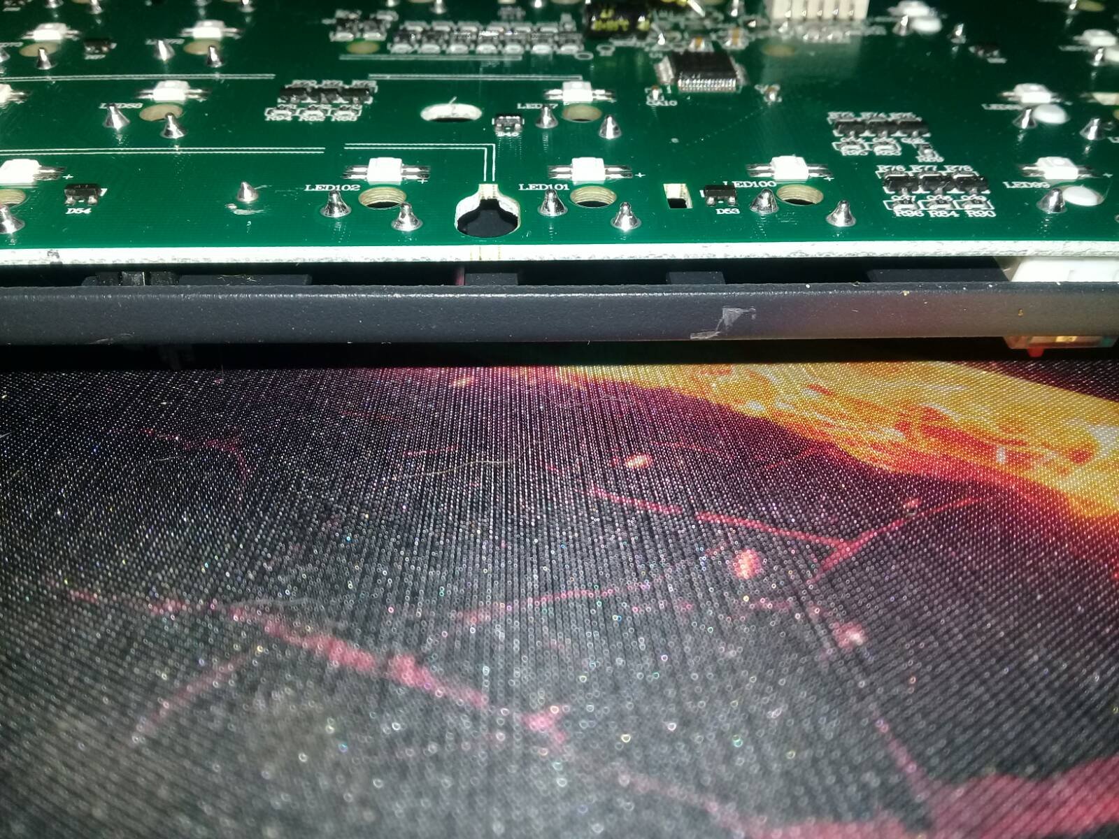

can you see something? the arrow keys from behind
I’ve been away over the weekend. The joints look fine so I’m a little stumped. Try grab a tiny piece of foil and wrap it around each leg of your switch, try only one layer thick, the socket leaf spring might be broken so you need a tighter fit to contact correctly.
Your alternative is likely to desolder that key and solder in a new mill max socket or permanently solder in a switch, I would assume you wouldn’t want to do that for just one.
I assumed Khalil hotswaps, as they’ve popped off on me a couple times now. These look like a mill max/otemu type so I’m not super familiar.
Before you try that open a key tester and grab a pair of tweezers and check the inside of the socket. If that fails check the outside. If it works on the outside(underside) the socket is stuffed. If it doesn’t work on the outside its likely a broken trace and your SOL on that board.
Outemu hot swap sockets are super tight so I doubt they’re the problem. See if pins are bent. If not, try shorting two pins briefly to see if that generates key stroke. If they do then try resoldering. If not, problem is elsewhere.
