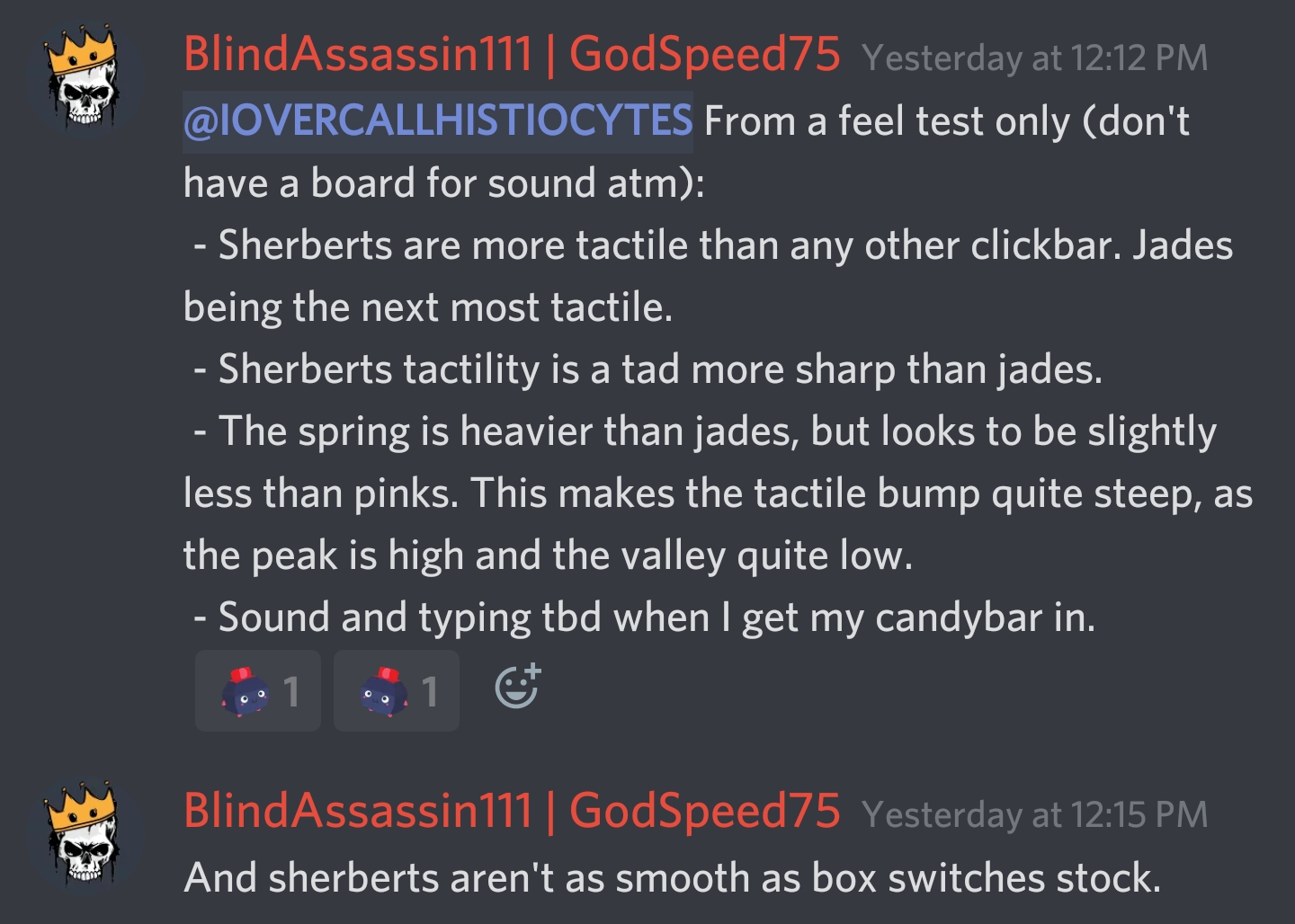

@Blindassassin111 has some and gave his first impressions on The Key Company discord. I can’t wait till he gets them in a board for his final thoughts.
thanks! That description helps a lot. I’m going to assume they aren’t for me b/c I’m not a fan of Jades at all (too sharp/stiff of a bump), and these are even more so.
