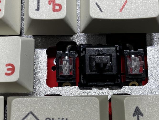

Finally had a chance to look at the build I mentioned earlier, that used these stabs with no apparent issues. NK Black switches, 21kb PBT caps.

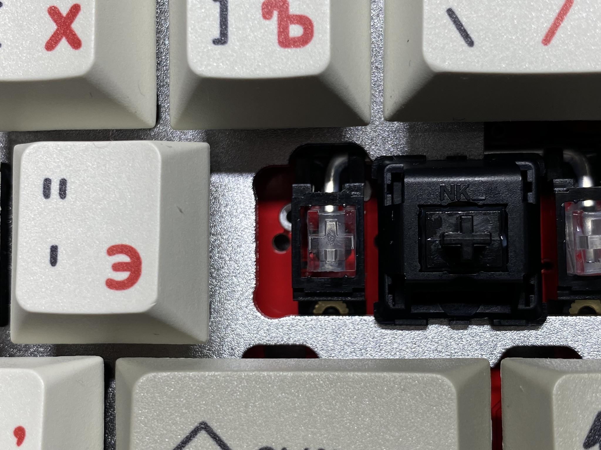

I can manually replicate the problem, with an extreme stem angle. The left stem in the photo below is the one showing the angle at which I can begin to feel the stem catching on the housing. The switch in this build (NK Black) doesn’t have much wobble, and definitely not to that degree.

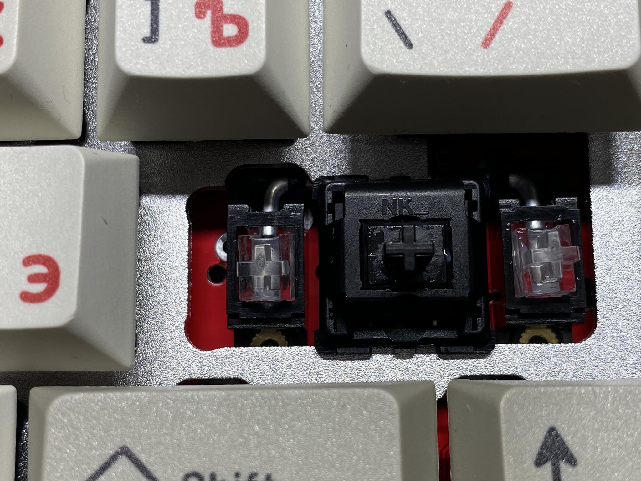

Lining up the switch and left stab stem in resting position, the stab stem has visible clearance with the bottom inside edge of the housing:
So at least in this case, with these caps and switches, there just isn’t enough play for the logo to ever come into contact with the housing. But it’s also clear that it wasn’t because my stabs were different in some way - I just got lucky.
Based on my tests, factors that seem to matter are:
- stab wire position (above or below)
- key row
- key size
- keycap profile
2U Return key (R3) key with stab wire below being the worst.
UPDATE: Left out keycap profile which affects the angle of the keypress like key row.
