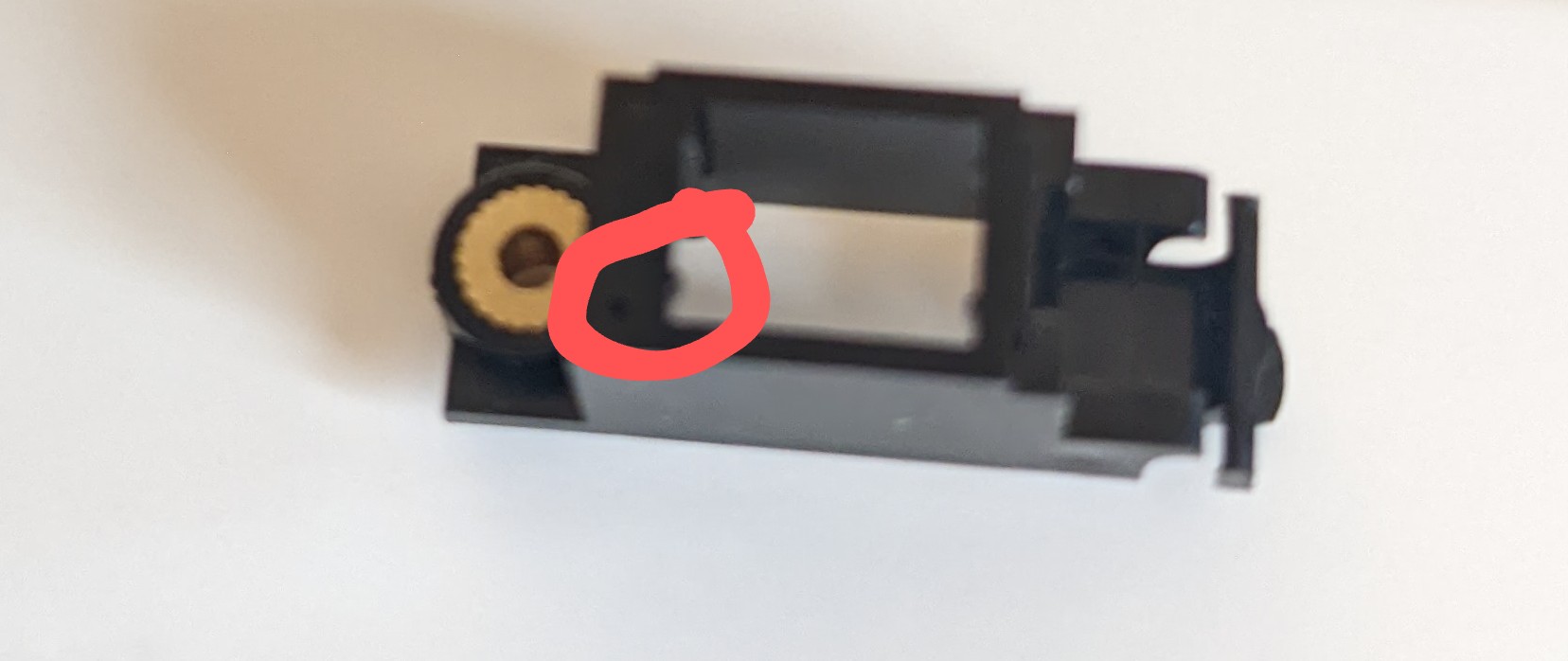

Can you get a picture of the lip you mentioned?

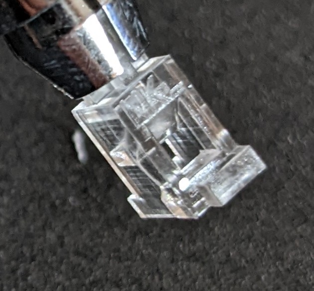

Okay, I just spent 20 minutes trying to find it, and I am confident this is the issue. The stems have an embossed NK logo on the side. Since letters stick out, they get caught on the rails. It only binds if severely offcenter, but I can still easily feel the bump on a slightly offcenter press.
Definitely a big wtf moment here.
By balance I mean straightening the wire. It seems to get out of whack more easily than other wires I have used.
I got out my zeal stabs to compare. I can full tilt the stem as far as possible any possible way, and it always smooth. Not surprising since they don’t have embossed logos on the stem…
Yikes. WTF NovelKeys?
Great discovery buddy! Very interesting.
The ā€œNK_ā€ logo pretty much goes from one end to the other so bumper rails will definitely catch. Micro-mesh failed to grind out the protruding logo. I think Dremel is called for.

Can you shave the symbol with a razor?

Razor won’t cut it. I’ll have to use Dremel in anger.
Did you try cutting it with a sharp razor blade? After seeing this thread my plan was to remove the NK with a razor then clean it up with ultrafine sandpaper.
I’m sure you could take a knife or Dremel to it. I didn’t bother trying since they sounded bad and ticked like crazy after lubing anyway.
