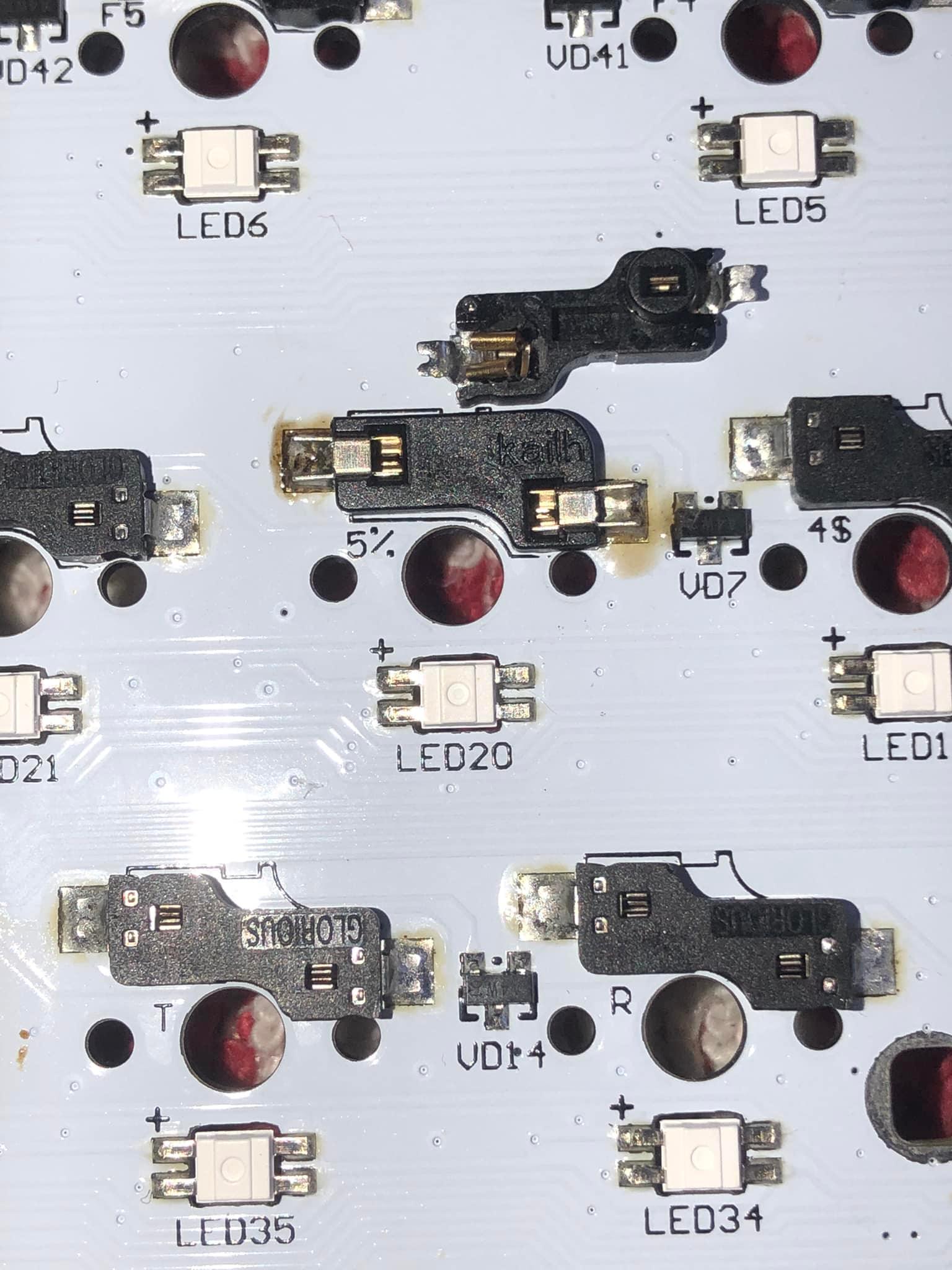

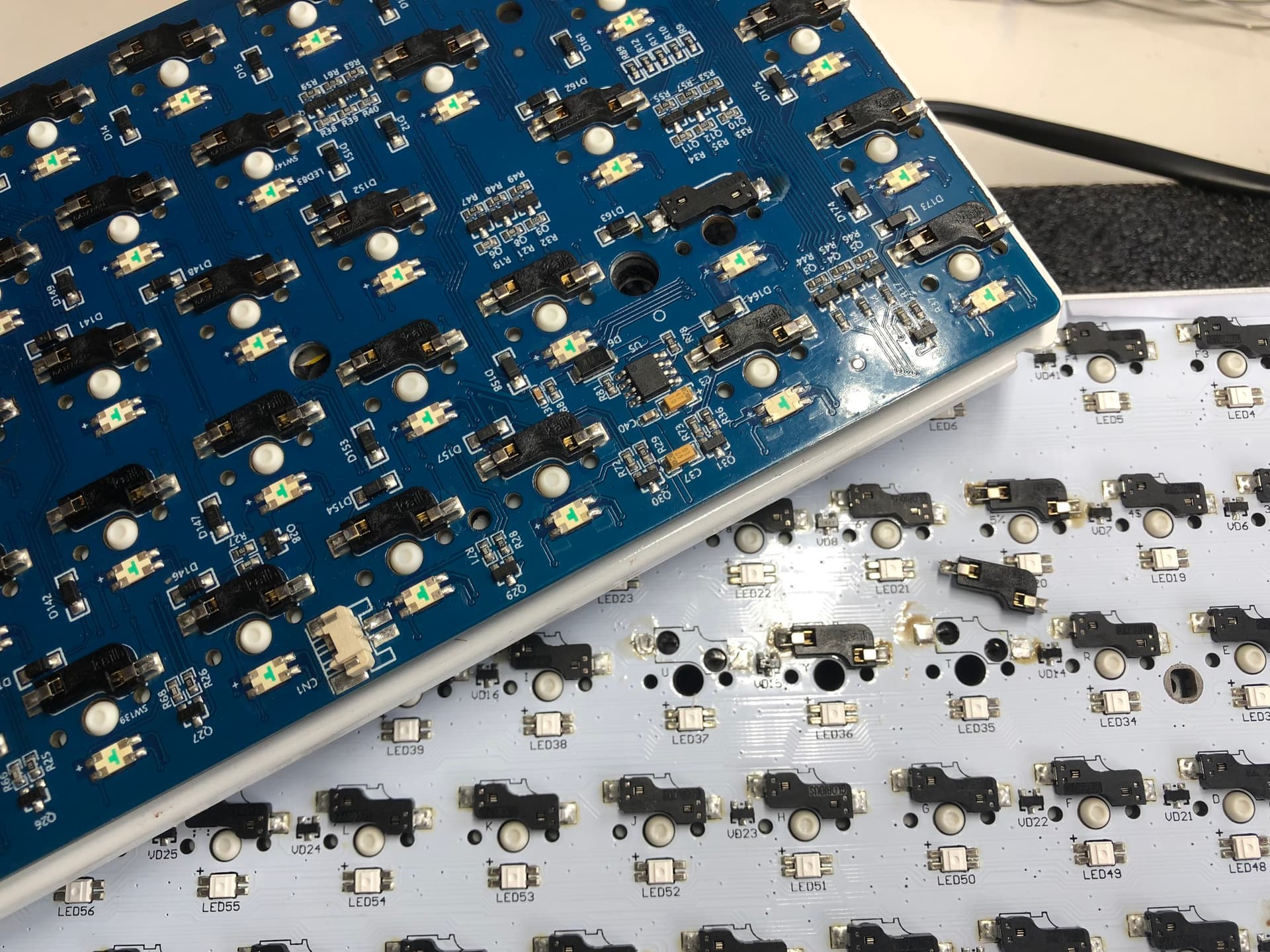

As you already know (or not), Glorious has their own hotswap sockets that don’t look like Kailh or Gateron:
Glorious vs Kailh sockets. Notice the left/right pins (solder joints), the leaf mechanics and the housing. I also noticed that Glorious use a sub-par plastic which is easier to break than Kailh sockets.

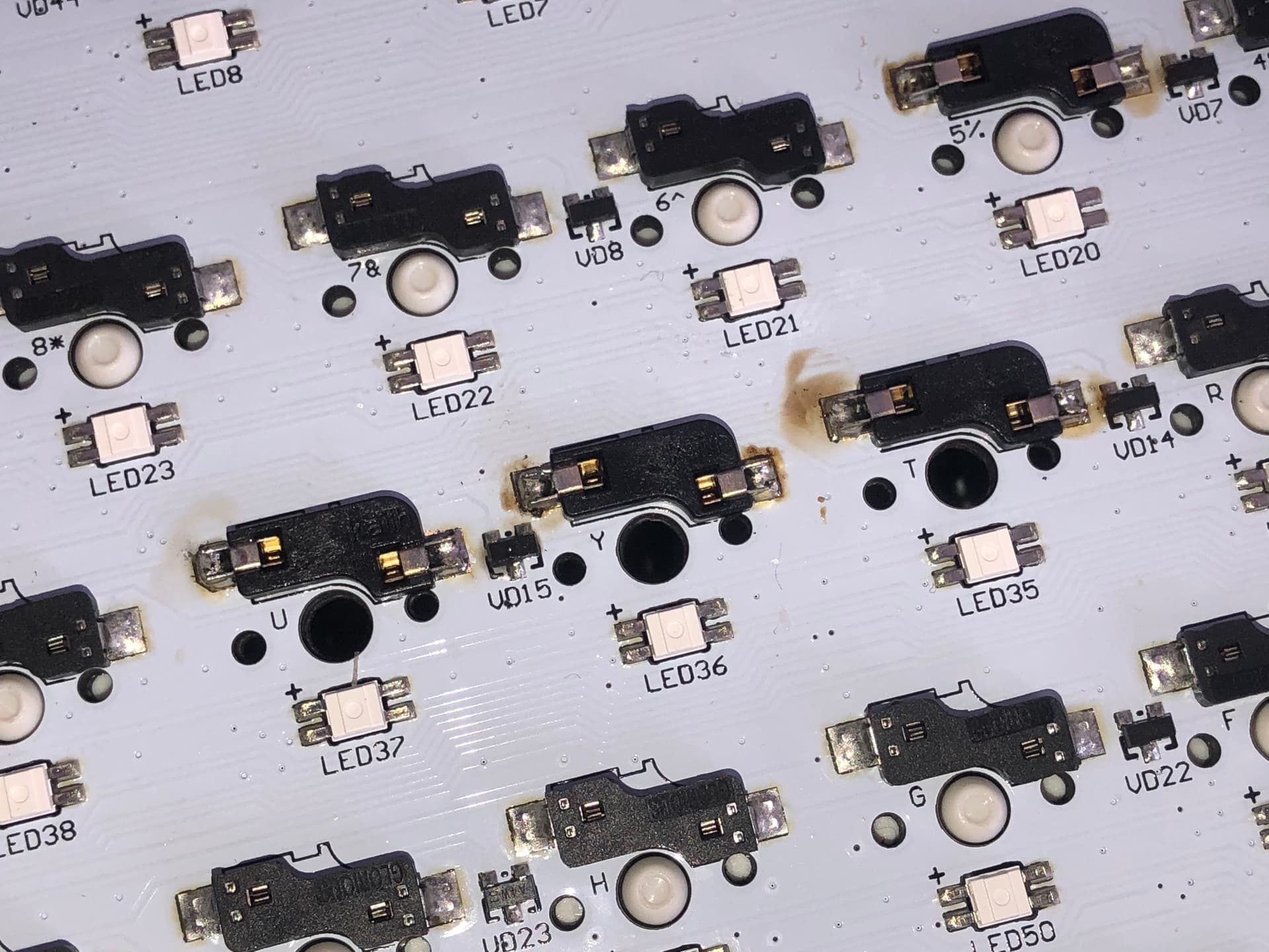

But as far as I know, that’s not a good test because as some of you said, I should test it on the same key. So here is the second video, with the same Kailh socket on Y key, and new soldered Kailh sockets on T and U keys, with the same switches, same keycaps, same board.
I had no more spare Kailh sockets, so I took them from my other cheap board and soldered them on my GMMK Pro, Link to 2nd video: Imgur: The magic of the Internet
All 3 keys are Kailh sockets. IMO the sound of these keys are now more consistent while the U is a little bit louder.
