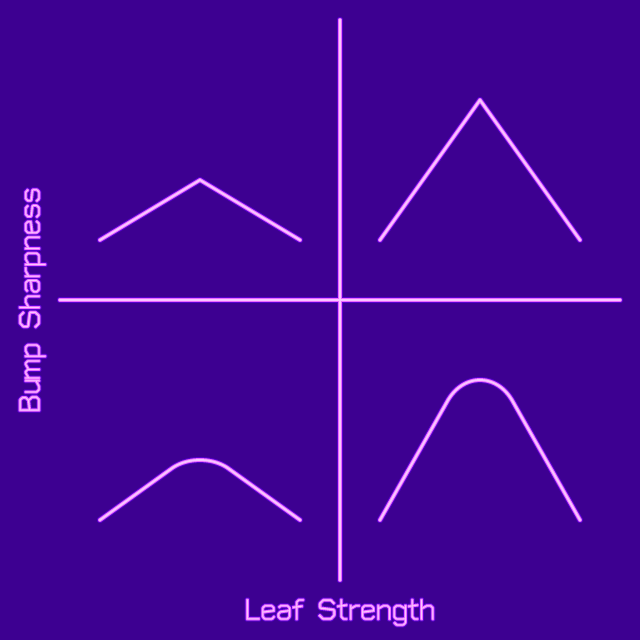

I whipped up a graphic really quick to try to explain this visually:
The sharpest curve is easily the one where the leaf strength is high and the bump is sharp, but perceptually the curve with high leaf strength and low sharpness is “sharper” than the curve with low leaf strength and high sharpness. I think you’d much rather drive over a speedbump (if you had to drive over one at all) shaped like the latter than the former, and would also probably say that the former is sharper than the latter even though the latter is objectively sharper at its peak.
Yes, that closely corresponds to my experience, and why I became interested in the RARA stems in T1 housing.

Sounds like Rara would be in quadrant 3 (from top left). Taro in quadrant 1. T1 in quadrant. 4(?).
Not sure if Pewters and light tactile fit in this for JWK, as their bumps are so much lower…
