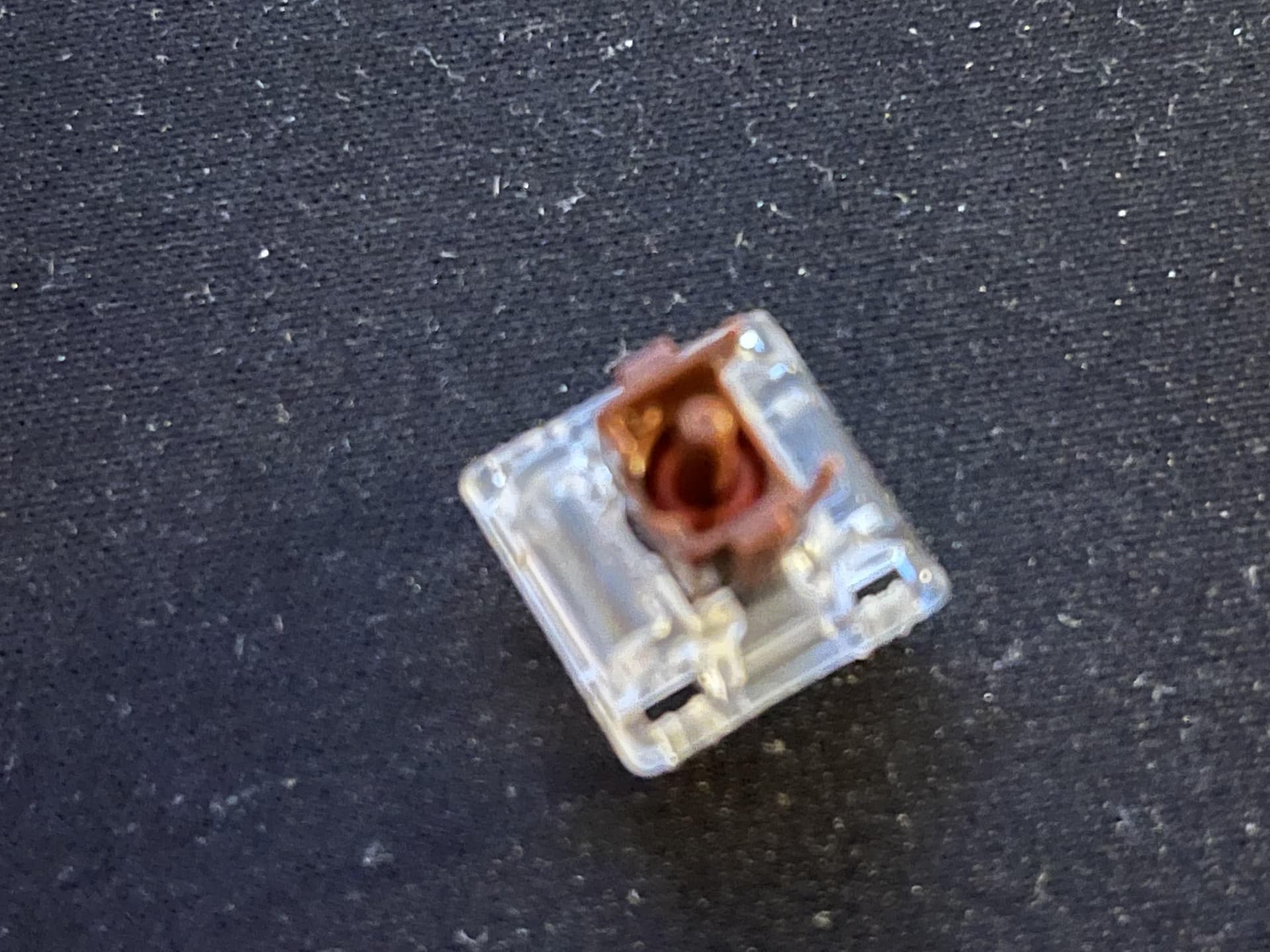

O'ring in stem pole
I recently got some 4mm x1mm x 1.5mm o’rings for my nk65, after modding the board I discovered that placing an o’ring on the stem pole makes it quieter, it’s a lot more effective than putting o’rings on the keycap stems.
Sorry for the blurry image.
This is kinda like the trampoline mod, but with an o-ring hitting the stem hole exterior. Cool find!
This is one of those things that seems obvious after someone mentions it, like, how did I not think to try that - but indeed, I don’t think I’ve seen this particular use of orings mentioned anywhere. I’m definitely going to give this a try; stem o-rings were always too fat for me and the trampoline mod would really test my patience if I ever decided to undo it - but this is totally reversible with basic tweezers. I bet it affects the force-curve, too, adding more pre-load to the spring.

Hi all,
just tried the mod in question on my Outemu Silent White and… not liked so much, as it introduced a “thud” sound, more audible than my actual switch “setup”, with and O-ring and 2 holes hand-made on the bottom (which are filmed and lubed too).
Maybe is just on mine and with other switch could be better than the classic O-ring under the keycap.

I haven’t tried it yet - but it doesn’t surprise me that it introduced that sound. Other silents whose dampeners have a bit more impact surface area than Outemu’s also “thud” - like newer Kailh ones, and TTC’s.
One of those “thud-y” switches, a TTC silent linear:
A comparison of an Outemu and TTC silent; notice how much louder (and more thud-y) the TTC is:
This mod could probably make un-dampened switches more quiet - but for already quiet ones like Outemus, one can probably expect to have your same experience. Generally speaking, Outemu silents are the most quiet stock silents I know of, so the increased dampener impact sound would probably be most notable on their switches.
