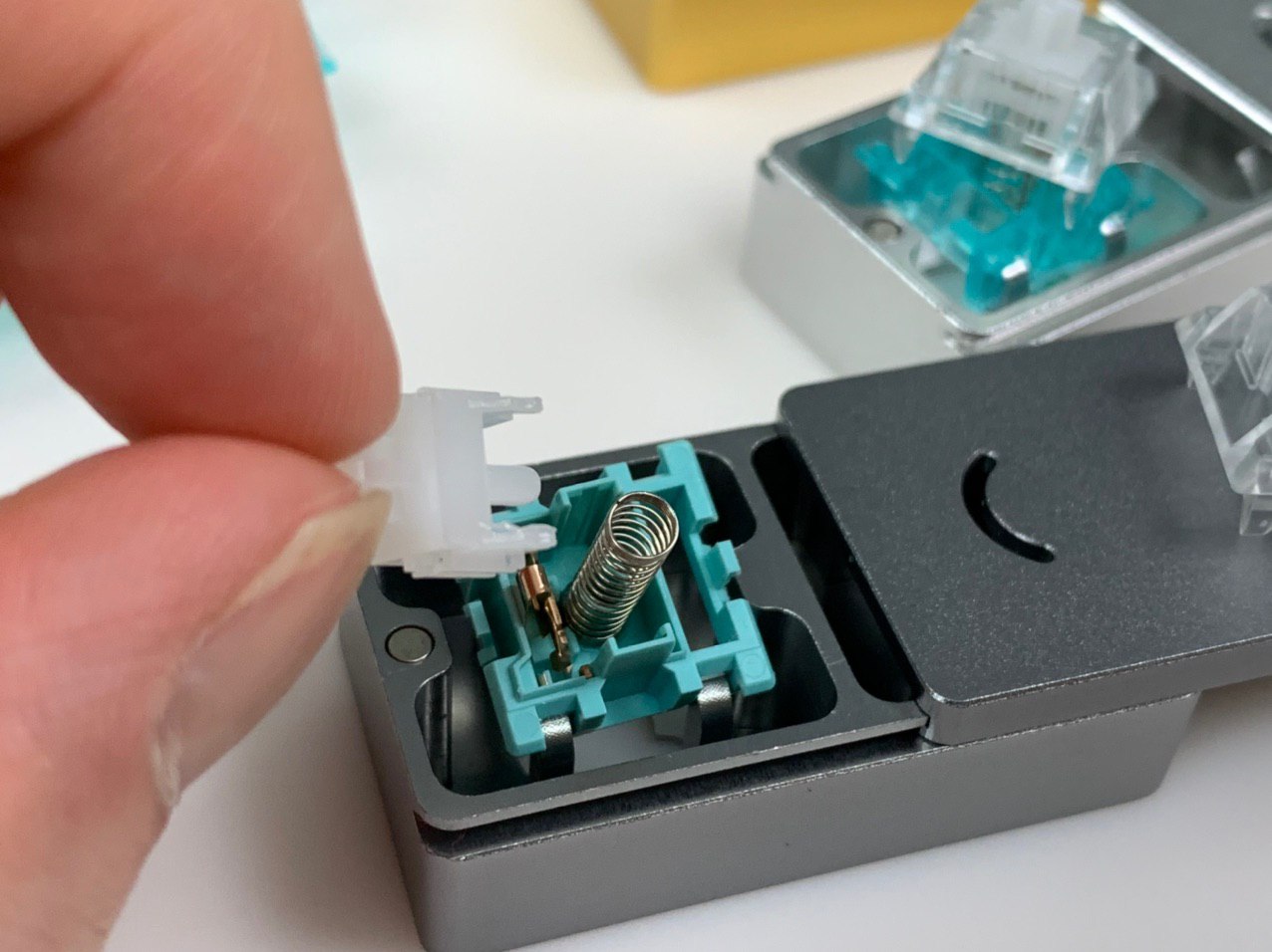

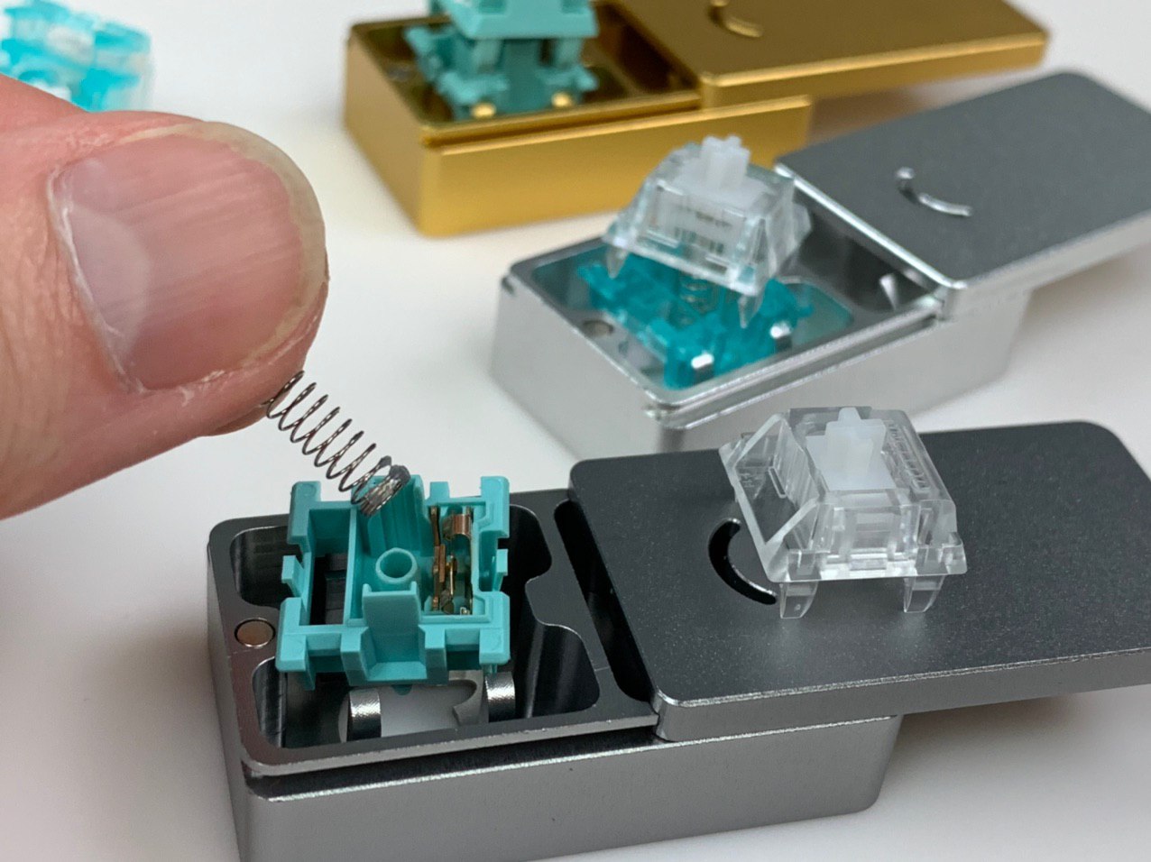

So I just realized that Outemu Silent Sky switches are donut-dipped from the factory such that the bottom of the spring that touches the housing is lubed. In addition, the stem legs/metal leaf are lubed as well. I’m not sure how I overlooked this given that Outemu mentioned that it might take awhile to have these manufactured due to the handmade nature of these switches. I didn’t question it at the time, but now I realize that they are handmade because each switch is individually lubed then assembled by hand.
@equalunique were your switches that you got from Aliexpress also lubed in this way? I ask because I don’t hear any spring crunch or pinging from the Silent Skys at all. The lube appears to be a fairly viscous lube that is a grease rather than an oil. I’ll have to ask the manufacturer when I get a chance to see exactly what lube viscosity they use.

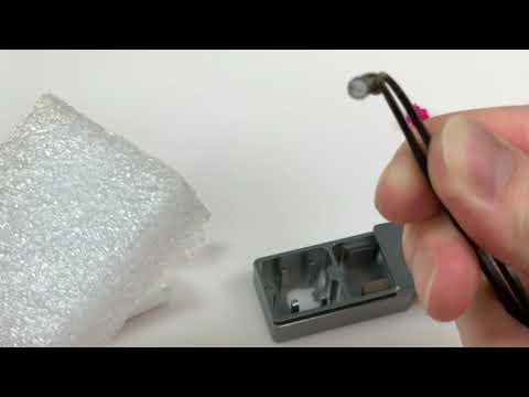

In any case, I decided to take the idea from the Silent Sky switches and check if lubing Aliaz switches in the same way would help with the crunch/pinging. The video below shows the results.
It appears that lubing the spring ends does clear up most of the spring crunch. Past that, there’s a bit of a noise that I still haven’t pinpointed the source of yet, but no matter what, the result is MUCH better than the crunching sound of the spring of the unlubed switch at the beginning of the video.
Also, I realize I took it a bit too far and shouldn’t have dunked the entire spring in the lube but… you can only learn if you try, right?
