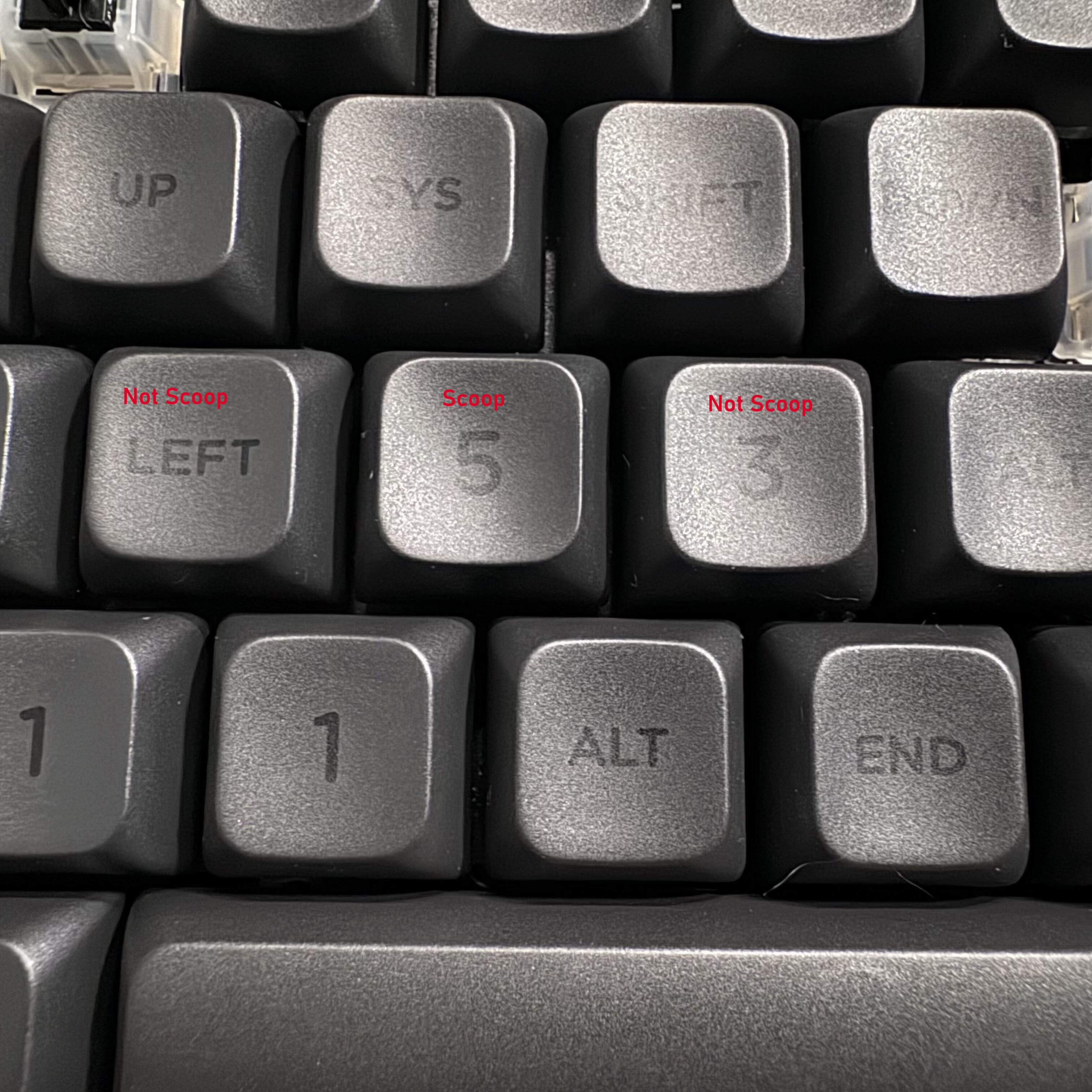

As I am not a keycap designer --or designer of any kind-- I am probably going to use incorrect terminology in the next couple of sections. When I say “scoop” I am referring to the area on the top of the keycap where my fingers rest when I am in home position. The PBS scoop is quite comfortable. One of the things I’ve disliked about other uniform profiles is how easy it is for my fingers to accidentally slip from one key to the next. I don’t have that same problem with these caps: the scoop seems just deep enough that I won’t wander without knowing it.
Sides
When I say “sides” I’m talking about the highest points of the scoop around the edge, like the rim around a skatepark bowl. Sometimes these are really sharp as they come to a thin line, like CXA keycaps where, at least for me, the transition from one row to another is jarring due to the abruptness of the edge of each key. On the opposite end of the spectrum, XDA keycaps offer no edge at all: being almost completely flat (perhaps a bit convex even), there’s no edge to keep my fingers on home. With PBS, the edge is distinct enough to let me know I’m at the edge of a key, but soft enough that gliding my fingers from one key to the next isn’t abrupt or unpleasant. Also, the homing keys (scoops of course) have only slightly higher sides than the rest of the keys.
Homing Keys
I never use scooped homing keys. I always use bars or dots. I don’t’ know if there’s going to be a bar or dot homing style, but the scoops feel quite natural: they’re the same profile but the sides of the skate bowl go a little higher. I think the scoop homing shape works well here though: the keys don’t feel unnatural or foreign amid the rest of the profile the way cherry scoops usually do.

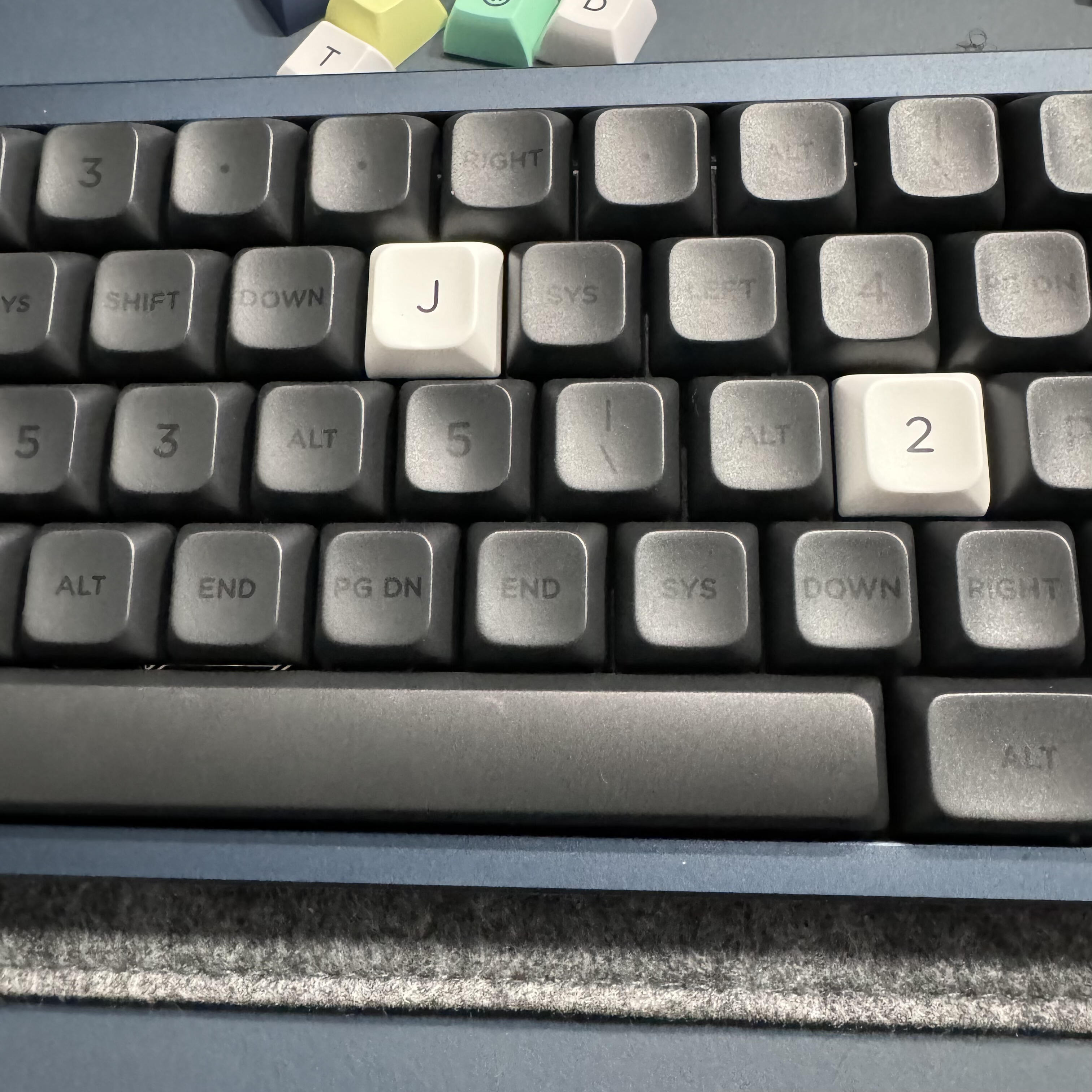

Well I’m no Theremingoat, but I’ll try to be brief. I really like these keycaps: the are smooth and have soft edges, and are a great height, whether you’re typing on a high-angled board like the Glare65 and low-angled ortholinear boards like the Gridiron. I can’t wait to try a full set.

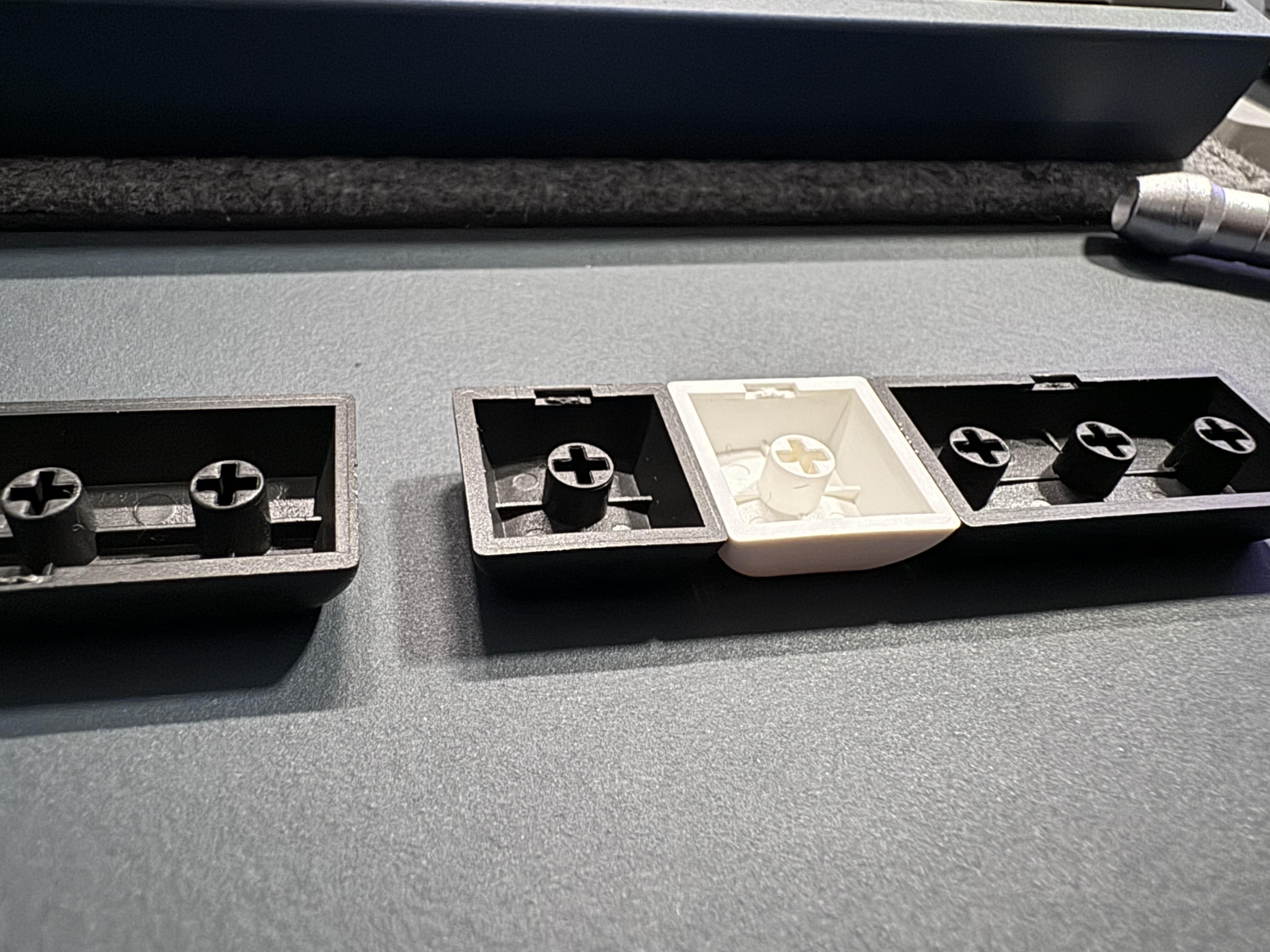

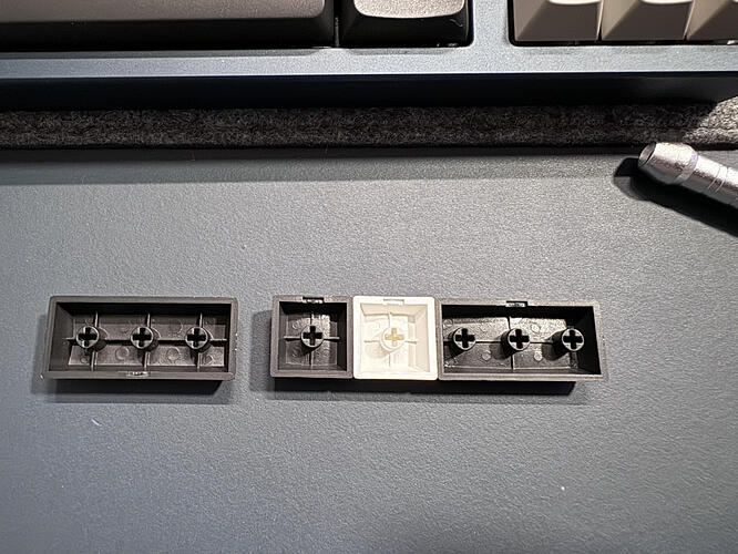

I wonder if they work on Tecsee medium switches. Do you have any photos of the underside of the caps?
Thanks so much. Dish makes way more sense than my skate bowl analogy :smile:
The leftmost keycap is a convex spacebar, and the rightmost is a 2u backspace.

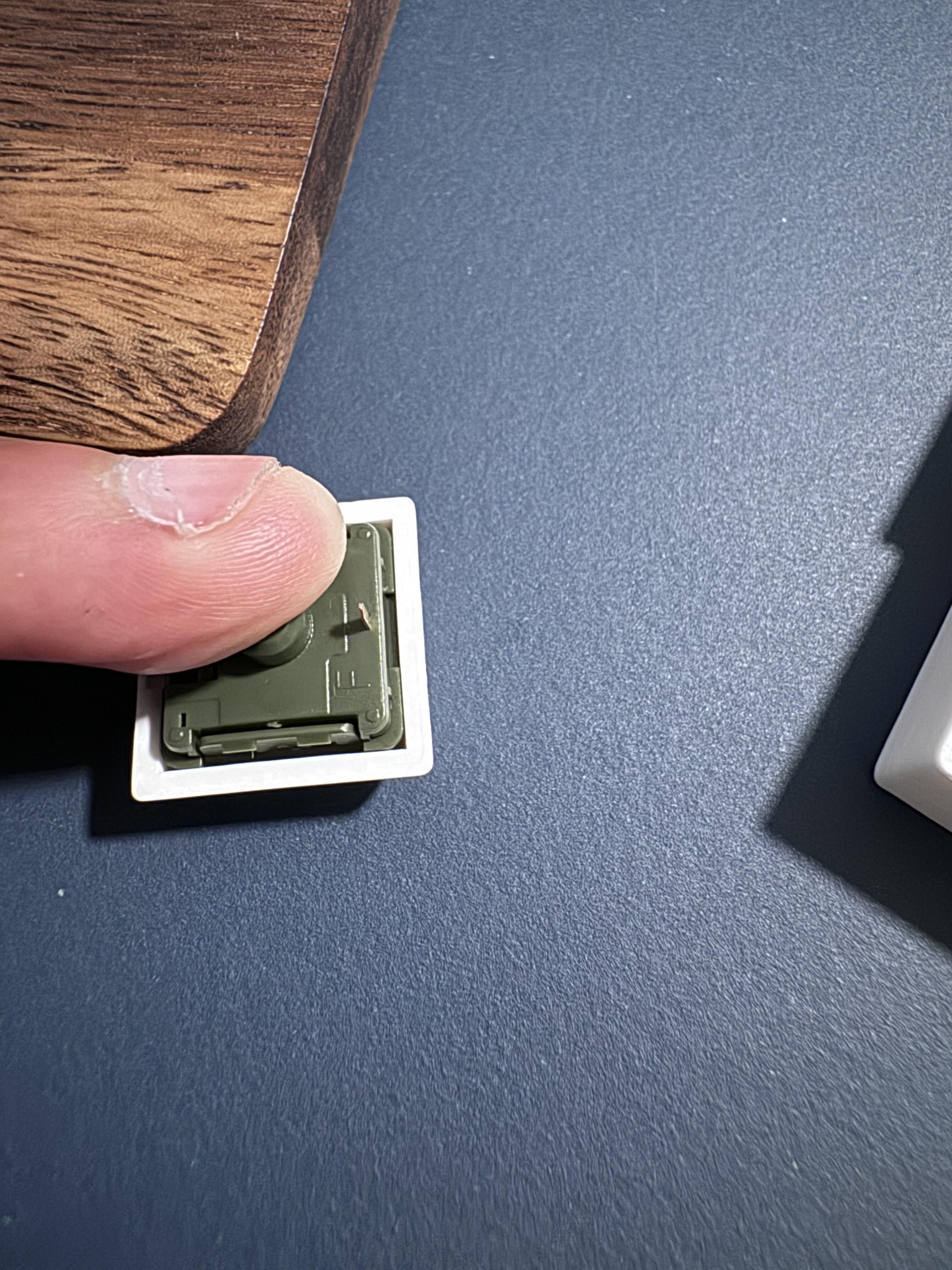

The keycap doesn’t hit the switch under normal presses but if I squeeze the sides of the cap there is rubbing. Otherwise it just clears the sides.
Re: MTNU smoothness, I dunno man. My 800 set just isn’t as smooth as some of my other sets
I think you pressed reply before the image finished uploading
Thanks for the heads up. Fixed!
Wow. That’s too tight. Even slightly off-center strokes could make plastic-on-plastic crap noise.

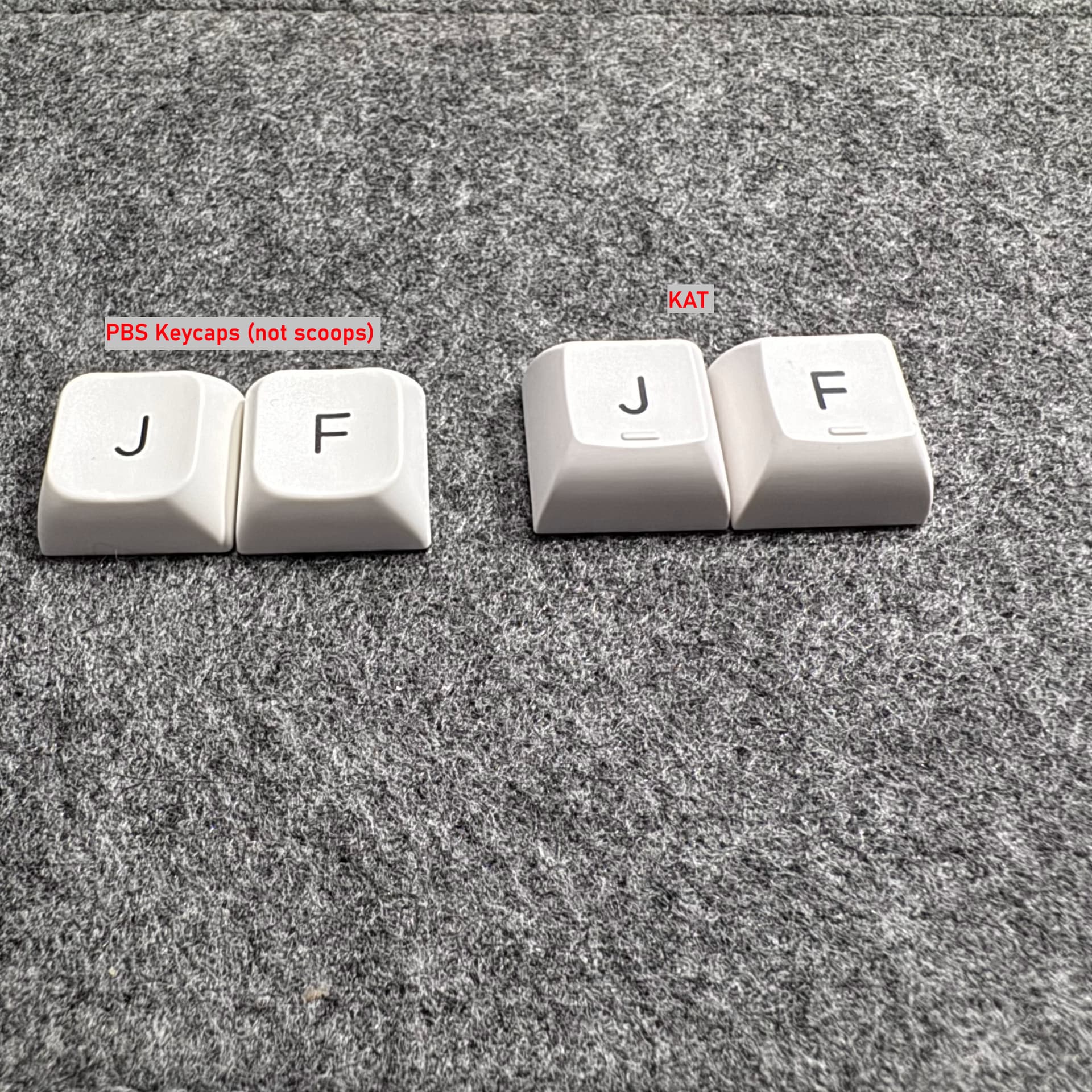

They look a bit like XVX profile, where at first glance the dishes look spherical but they’re actually cylindrical.
PBS’s dish is actually spherical. I don’t have the caps in front of me anymore, but the dish feel was definitely less of a “half pipe” and more of a sphere.
Front/Back are cylindrical BUT the scoop is spherical.
