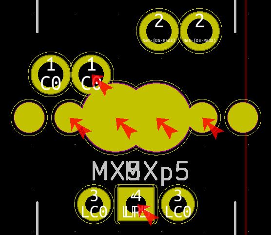

I have a problem designing a new PCB with Kicad with MX footprints that are overlapping(the Swiss Cheese PCB effect), maybe some Kicad experts already have a solution to that in this forum.
Here are some captures:
As you can see I have a lot of DRC errors:
- Drilled holes too close together.
- Pad near pad
Is there a trick on Kicad to remove these DRC errors ?
Commercial PCBs commonly have this feature to widen the possible layout choice, I guess this is no problem to fanufacture as it is.
I’d like not to ignore DRC errors if possible, they are invaluable to find real design problems.
I believe what most people might do is create a custom footprint for those spots and then just a single switch component in the schematic for that schematic. You also may be able to pick those specific errors to ignore while still allowing DRC checks.

The first solution is a significant amount of work, but look to be the cleanest way to manage the problem.
The second solution is for lazy people like me
I’ll check if there is any way to do that in Kicad.
Mmm, DRC error filtering is not available in Kicad as of now, so the first method will have to be used.
Also it seems that multi component footprint is the way to go, people are commonly using this technique on the net.
Thanks again for the info @donutcat, now I’ll have a nice moment generating lots of specialized footprints
