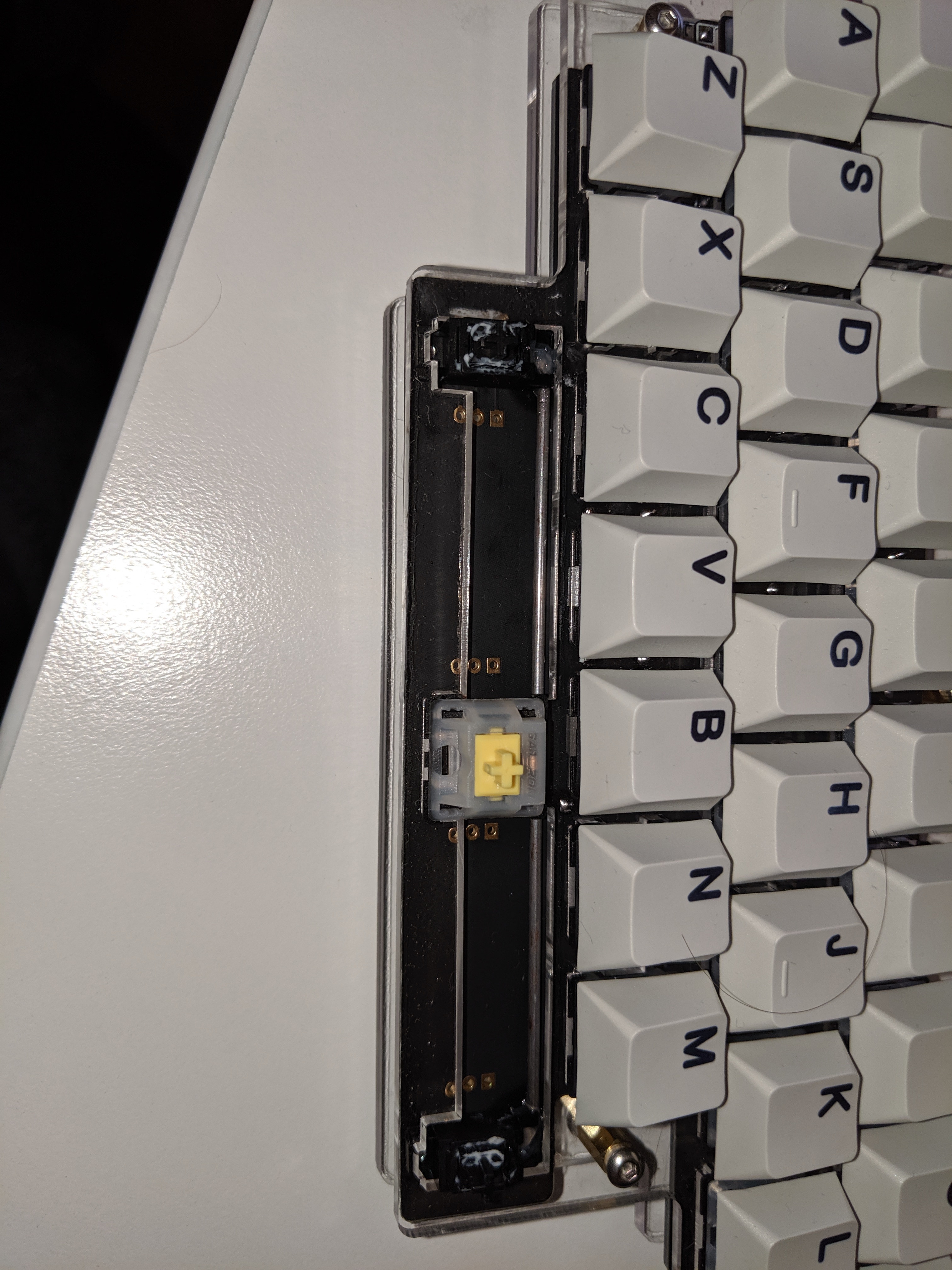

Does it look like I overdid it on my Pain27 v2? I also used PFPE grease on the plastic pieces.

Based on that picture, it’s kind of hard to tell. It looks like it could be okay, but it also possibly looks like too much. I can’t really see the elbows of the wire since that’s also a pretty crucial part.
It feels okay, I don’t think it feels particularly mushy. But if I take off the spacebar and lift up the stabilizer, I can see some of the grease come up out of the stabilizer openings.
