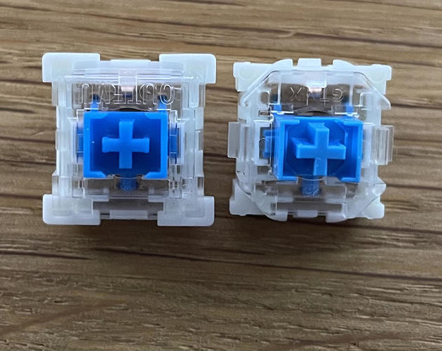

@MKUltraCorp has produced an updated version of the Outemu Snap switches. The new versions have slightly higher housings and stems for plate and keycap compatibility.
However, other than compatibility the new switches are worse than the original Snap switches.
  • Sound is higher and more pingy
  • Scratchier
  • Tons of stem wobble compared to Outemu Snaps, which were really tight
  • Super cheap stem on the new switches (see picture, very thin)
Sound comparison of the blue clicky switches here - not great quality but you can hear the deep original sound and the new higher, pingy sound clearly.
Original Snap on Left with thick stem, new switch on right with wobbly, thin stem:
Ugh, so many things went wrong here. It seems the design improvements were well intentioned, but poorly executed.
This would be a non starter for me. It’s kind of hard to overlook this one.
Wow, that’s really disappointing.
I guess I’ll just buy the Amazon versions and superglue the click leaf into place to get my tactile fix.
