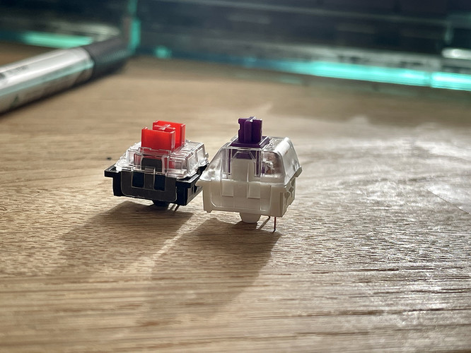

So I’ve been playing around with a batch of Outemu Snap switches. They are 2mm lower than regular switches giving you a mid-height profile.
These are named for the (supposedly) different click mechanism of their Snap Blue switch, but these Red switches work just like a regular MX linear switch.
My discoveries so far:
  • Like many Outemo switches they have a nice, tight housing and very little wobble (the shorter stem probably helps here too).

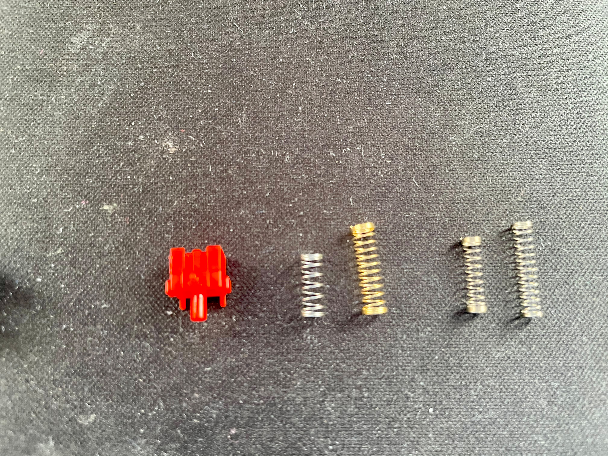

  • Sadly they literally use a shorter MX spring so you can not really spring swap them. Kailh Box and Alps springs are too narrow.
  • I definitely like the lower profile, however small a difference it may be. Remember with some boards having around 20mm front height a 2mm reduction is still 10%
Have not tested the affect of lube yet. They are no more or less scratchy than a regular Cherry MX Red.
Pictures of the switches and springs below.
Interesting!
Any reason you couldn’t just put a long spring in there - or would it bunch up too much?
It was one of my first experiments. With the spirit spring that I tried it reduced travel by at least another millimeter. If you push hard enough you can still bottom out, but only after a horrible grinding crunch sound.
I did order some slow springs to try. They seem to have more space between the coils and might work letter.
