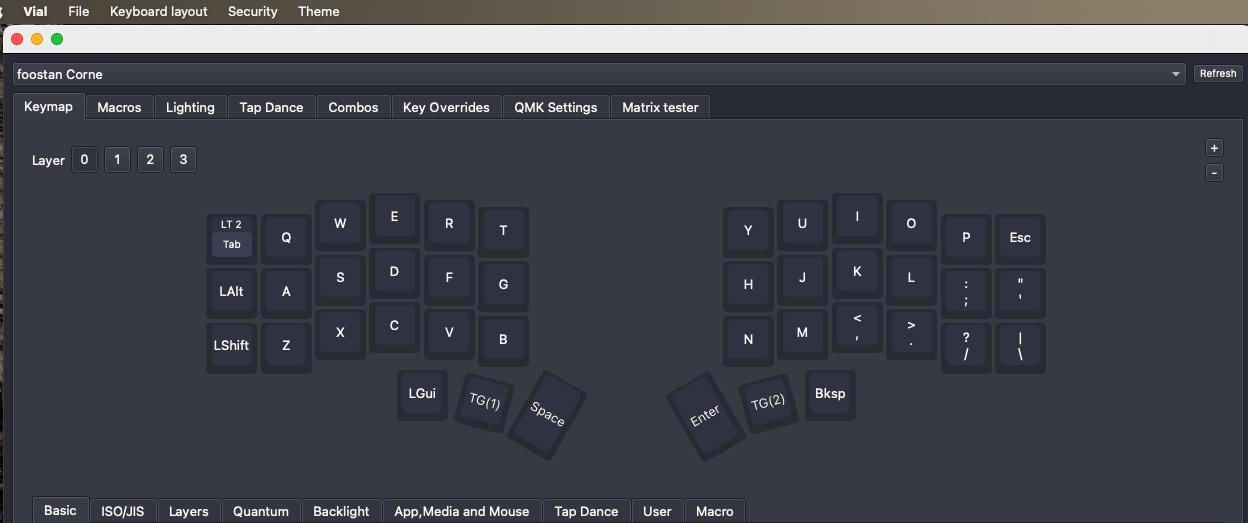

But I am not an expert here, so it’s probably worth downloading and running VIAL to see if it recognizes the keyboard? If it does, you can do a lot of the keymapping through that without much fuss. That includes being able to setup controls for the RGB effects.

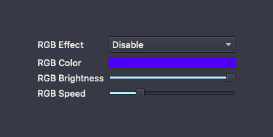

Thanks for replying. As I mentioned, my keyboard is configured with VIAL and an RP2040 chip. VIAL recognizes it without any problem, but I can only control the RGB effects at a very basic level.
Regarding what you said about using other people’s examples, I did the same. However, I don’t want to risk flashing the wrong files and breaking my keyboard because I don’t know which files I need. That’s why I need help. I need someone to tell me if what I’ve done is okay or if I need to correct something.
The tl;dr is that you will have to enable RGB_MATRIX_ENABLE = yes and disable RGBLIGHT_ENABLE = no, at least for the QMK/VIA firmware.

The configuration and command were referring to the crkbd/rev1 subdirectory of the QMK firmware. If you adjust the rules.mk file as mentioned before (and as mentioned in the readme.md of the linked folder) it should allow you to set more complex RGB lighting settings.
