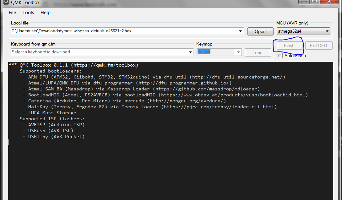

I cannot press flash botton in QMK tool box,
Anyone know how to fix it please help me T_T

Based on what I’m seeing on the screen capture, it appears QMK Toolbox has not recognized the device, which likely means neither has Windows.
If you open the Device Manager and see a USB Device with a red X, that may be your device, and won’t be flash-able until Windows can recognize the controller. If you leave that open, unplug the device, and it goes away. That will confirm this suspicion.
Solving this problem can be a challenge as it could be hardware or software issues.

Off-hand, I’m really not sure. This particular issue can be a real challenge to diagnose. I once gave away a keyboard because I couldn’t get it to work. Windows would see the device, but couldn’t find a driver. The person I gave it to had it load up immediately. So in that case it was a software issue and a lack of diligent problem solving on my end.
When you plug this device in, does it show up in the Windows Device Manager at all?
Found this on reddit about YMDK boards;
plug the cable while pressing left ctrl to get into bootloader
Try doing that while you have QMK pulled-up and see if anything changes in the window there.

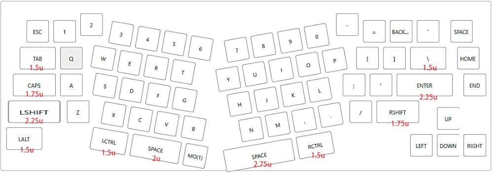

note that the keyboard layout is very strange
