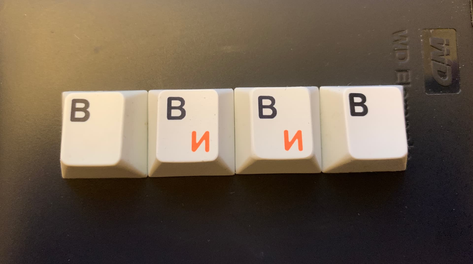

21kb keysets are comparable to CRP and ePBT but have two issues:
  1. Sharp Edges - Fingers will often catch on left and right edges of each keycap as fingers move left and right, and bottom edges as fingers move up rows. With CRP and ePBT, edges are smooth and rounded so it’s not a problem. With 21kb, edges were sharp enough to be annoying in-use.
  2. Less Smooth Texture - 21kb keycap texture is just not as smooth as ePBT nor CRP.
From left to right: CRP, 21kb stock, 21kb polished, ePBT

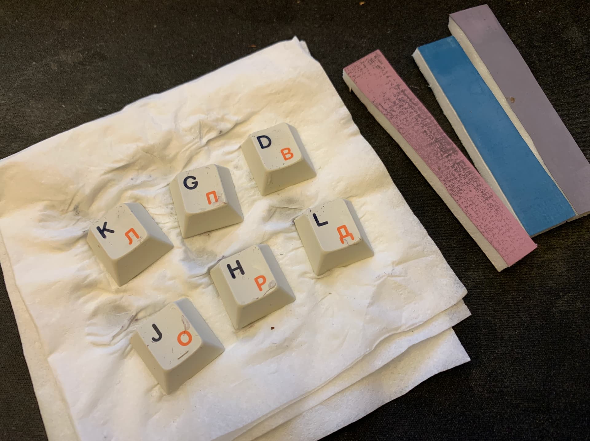

To address edge issue, I wet polished (water) the 3 edges (left, right, bottom) using 1800 grit micro-mesh.
To address texture issue, I wet polished (water) the top surface using 6000, 8000, and 16000 12000 grit micro-mesh strips. It doesn’t take long if you do more than one at a time.
After polishing with 6000 grit, finish with just 8000 grit felt similar to ePBT feel. Additional polish with 16000 12000 grit brought it to CRP level of smoothness. YMMV.
UPDATE: Forgot to share the most important finding which is that dye-sub keycaps can be polished without damaging legends. Up to a point, I’m sure…
