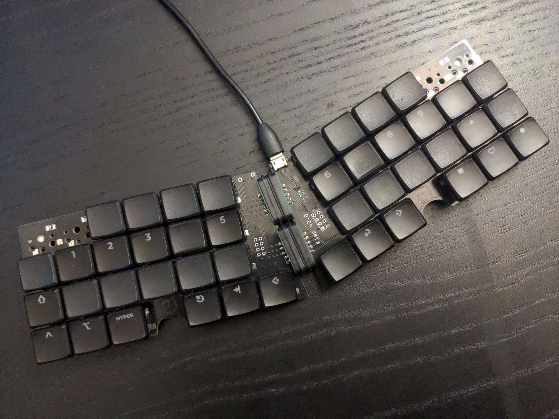

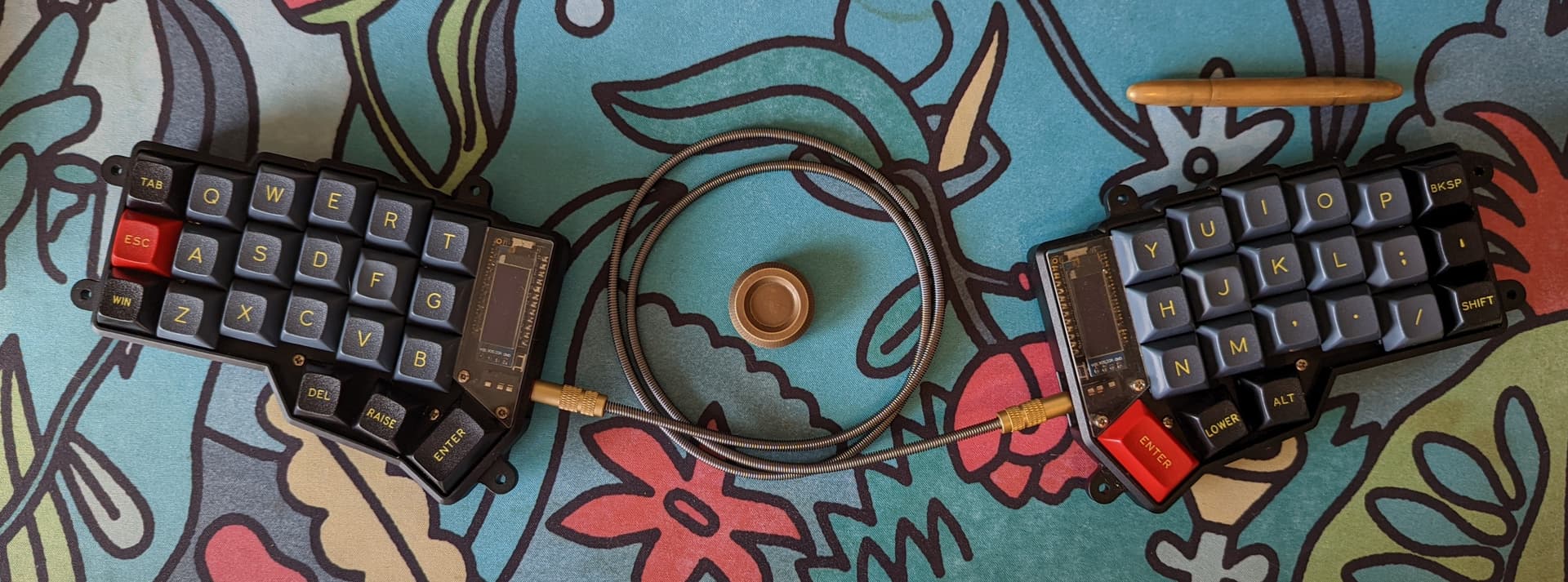

Oh fun. My ergo adventure began with a Planck and ended one board later with a Ferris. I tried a Le Chiffre as well, but low-pro seems to jive better with with the ergo concept in my experience. I still more often use ortho over col-stag, but the latter is still more comfortable for long typing sessions. Anyway, here’s an old pic:

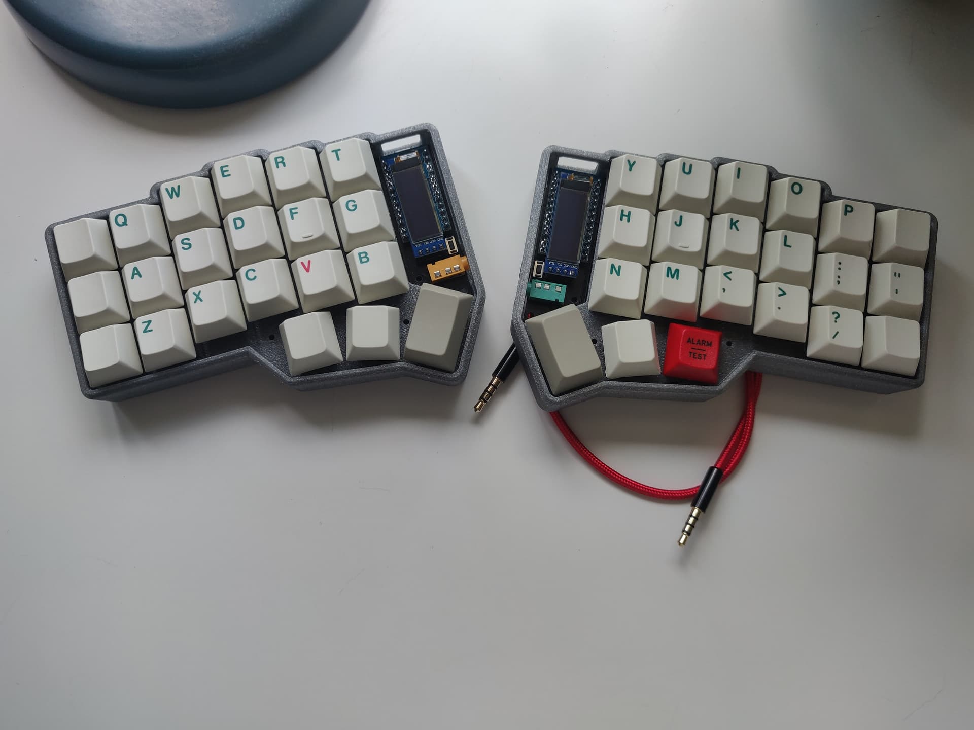

I’ve had a couple. Lily58 was my first, which is a great board. A bitch to build, but it’s a great intro to split ergo boards as it still basically has the complete functionality of a 60%

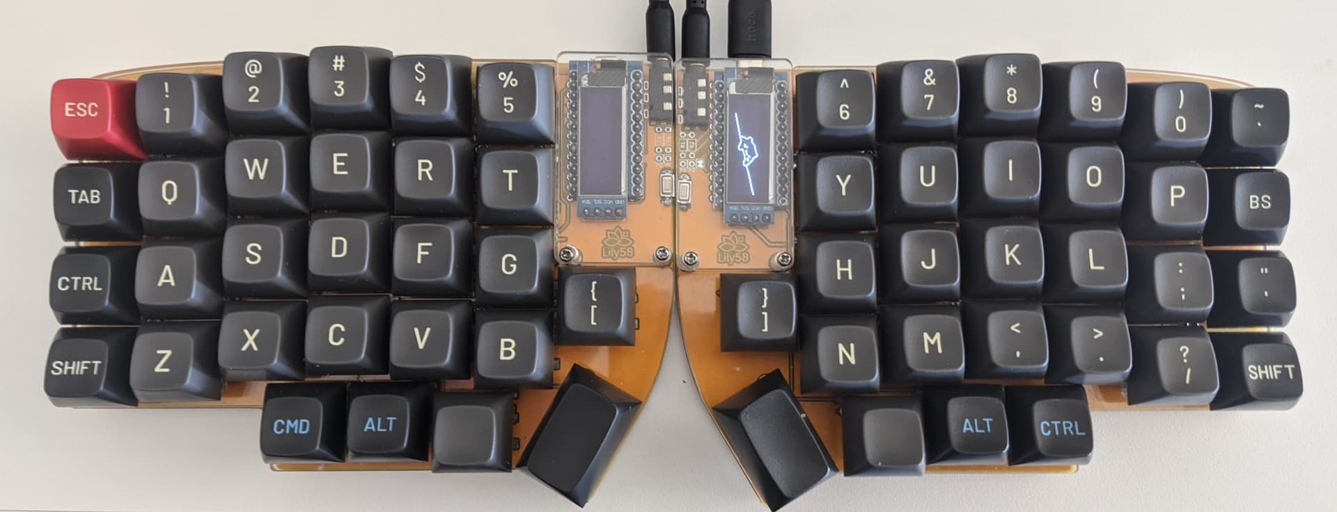

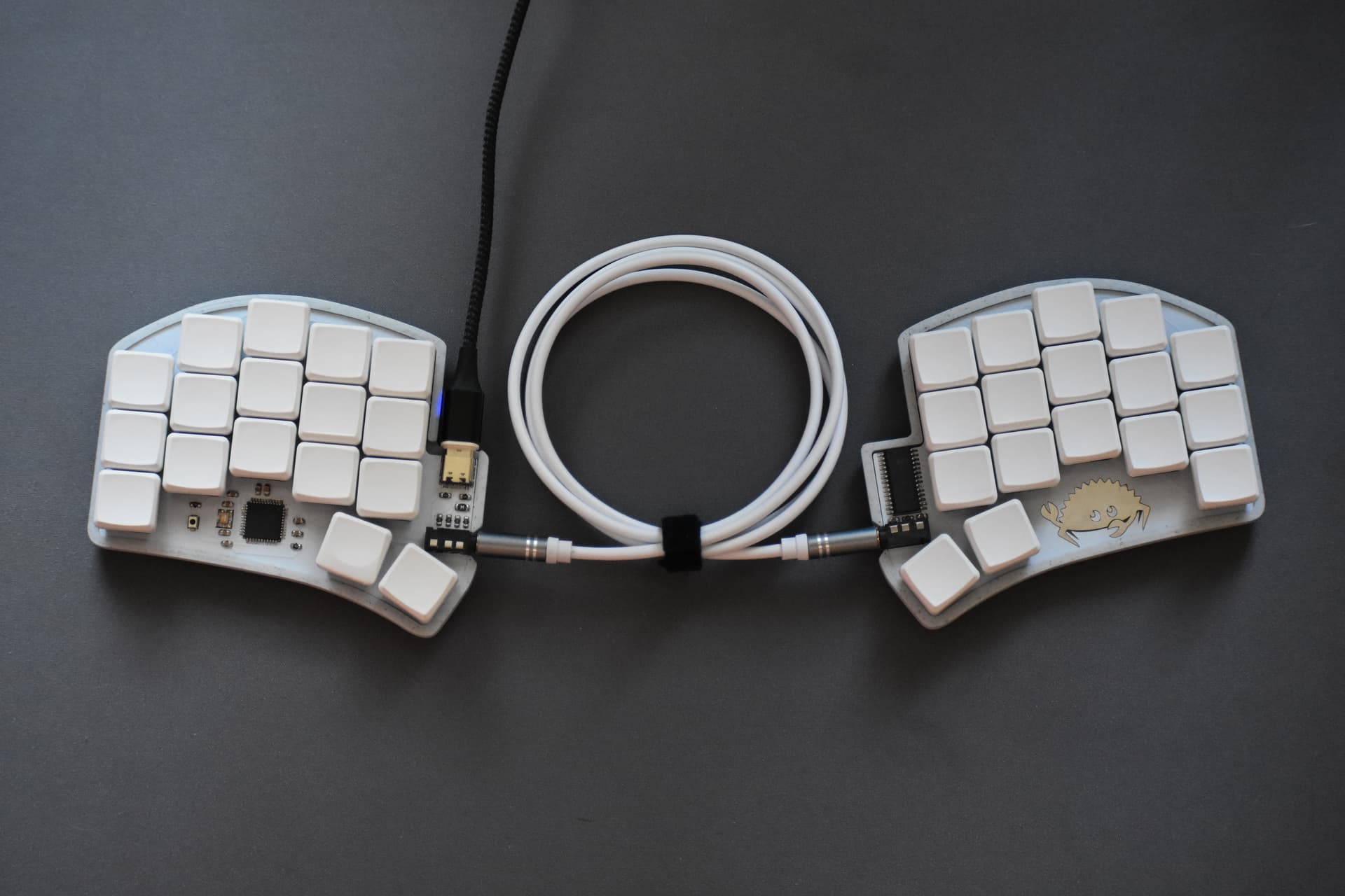

I made this Klap v3 as a travelling board, with the magnetic connectors in the middle so it can be separated for transport, but recently I took to using it on my desktop even when not travelling. The thumbs are a bit high, but it was supposed to be compact.

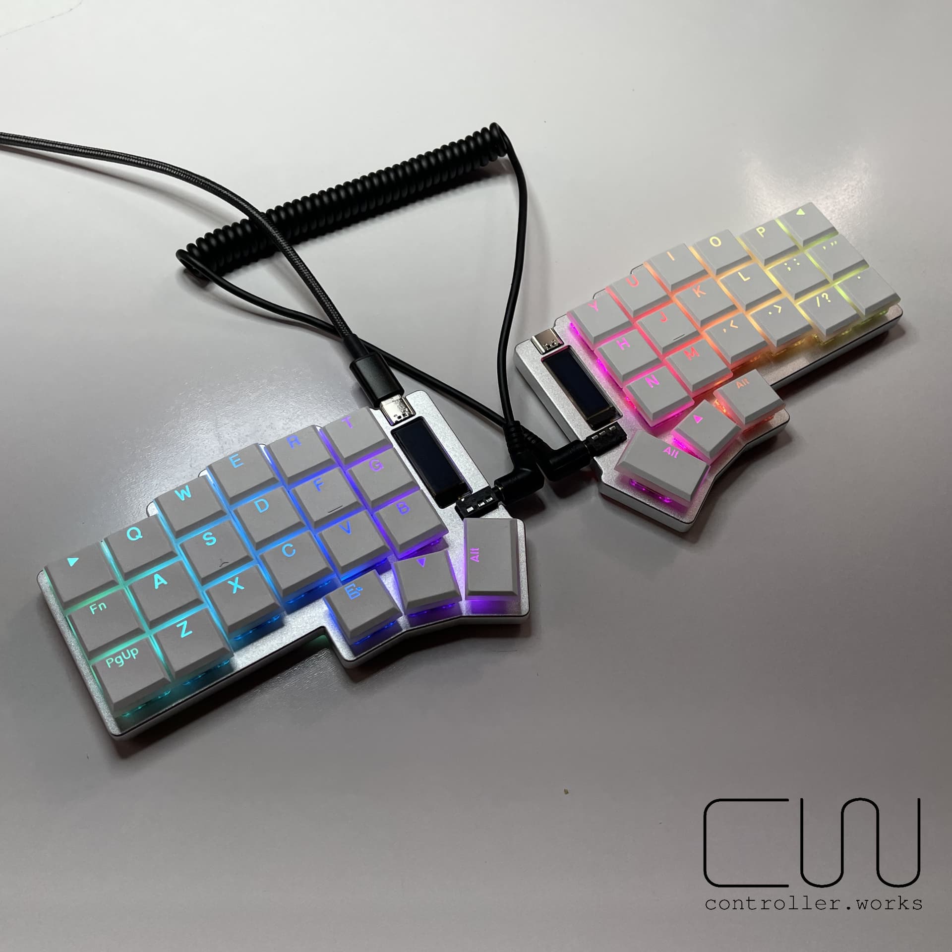

I’m testing out prototype units of our Corne OB keyboard. This is our first CNC milled aluminum case design. We were nervous about the case fitting the PCBs, but everything worked out okay.

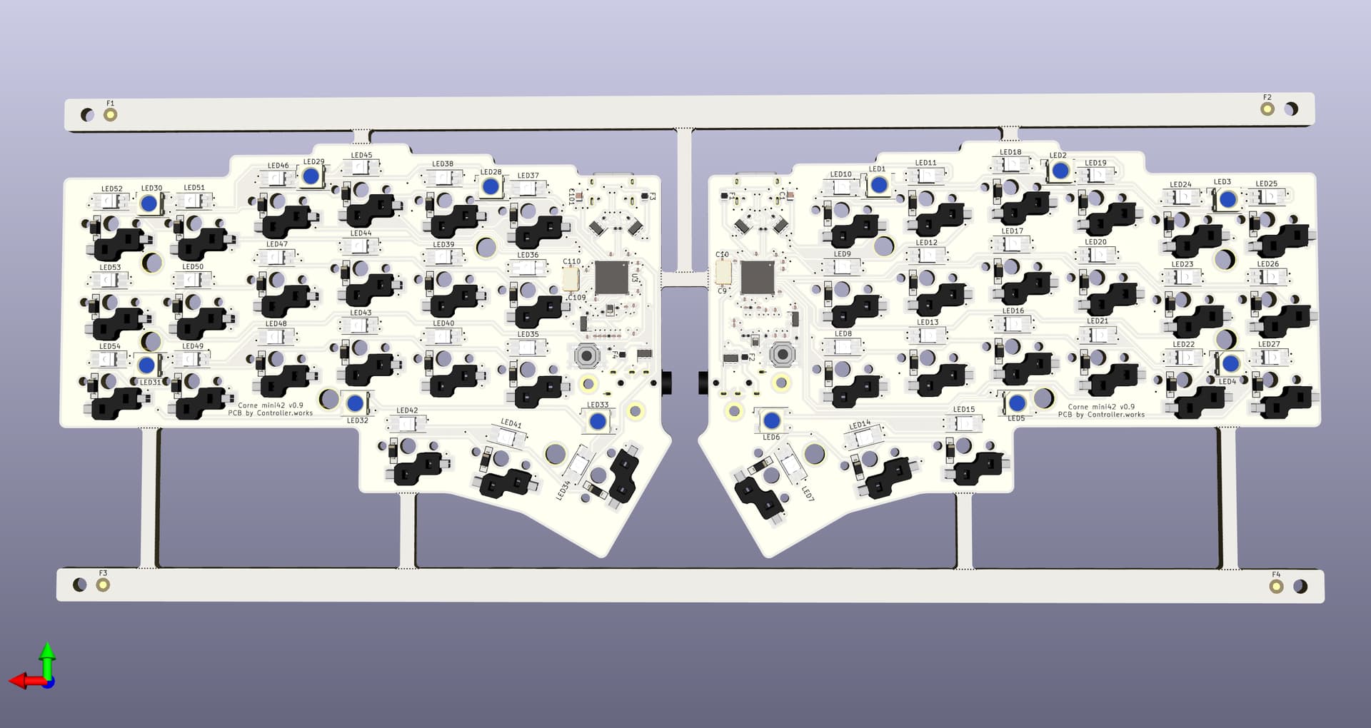

The PCB is mounted directly between the aluminum case and the back plate. The microcontroller, connectors, and OLED screen are all soldered directly to the main board (no OLED modules or Pro Micro socket). The aluminum case has five drilled and tapped registration pins that pass through the main PCB. The FR4 back plate screws into the registration pins like in a standard Corne (although the positions are different). There are very tight tolerances in the whole design, so the main board PCB is firmly held in place around the edges by the metal case. The whole case, not including the TRRS connectors, is only 8mm thick, so it is a very tight fit.
