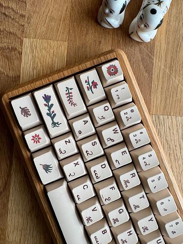

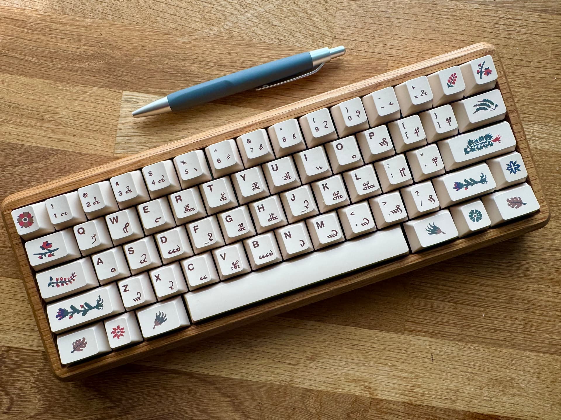

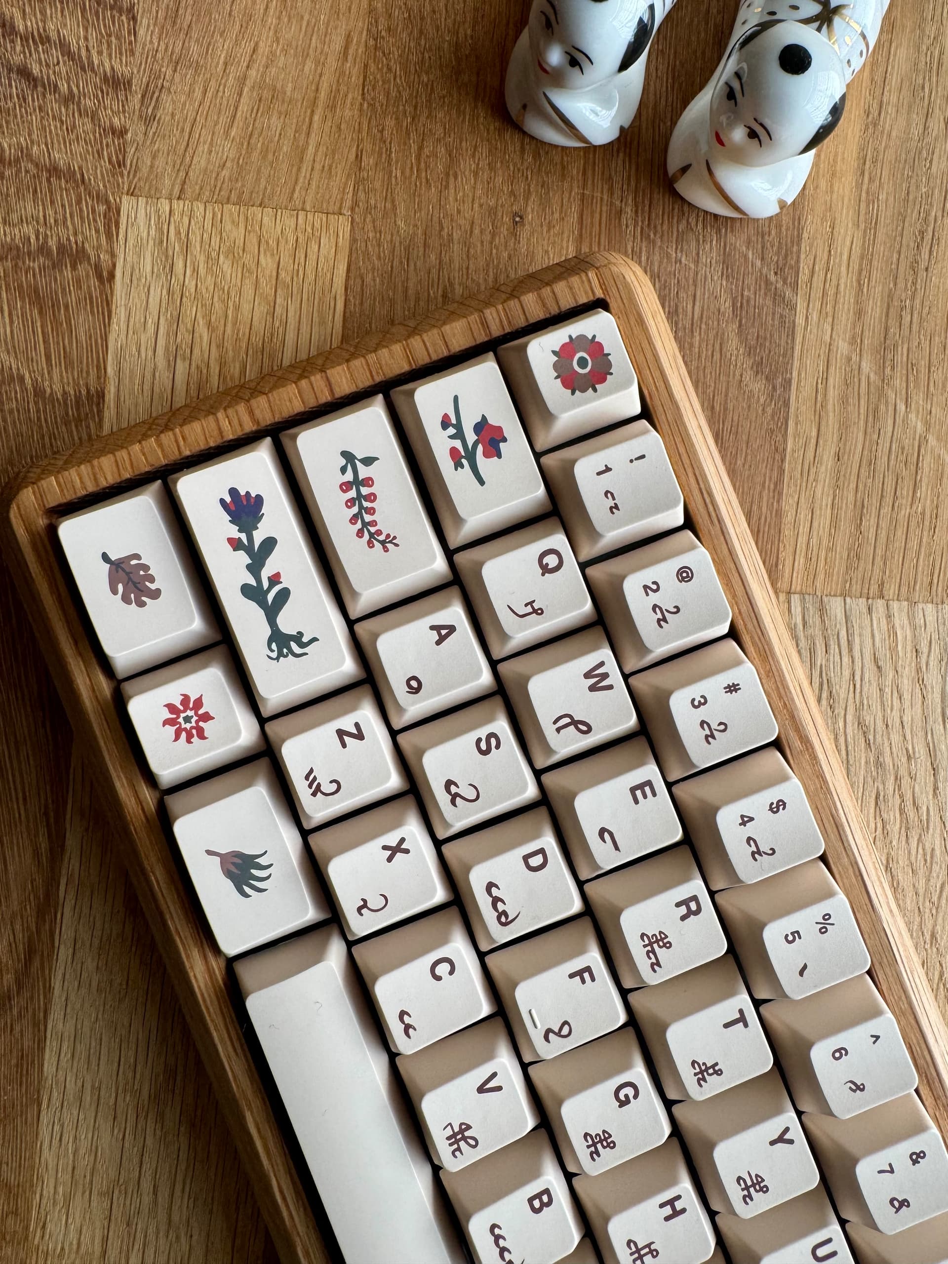

Picked up a Null Design 60% some time ago.
It is beautiful and unlike some other wooden cases I’ve had this one is perfectly straight and not warped at all.
I picked up some random Cherry profile keycaps from Amazon and the dye sub work is amazing for $30. It’s incredible where the hobby has gone.
Lovely pairing :heart_eyes:
AHHH it’s MW Voynich’s Evil Twin, also ouu nice simple wooden case very nice.
